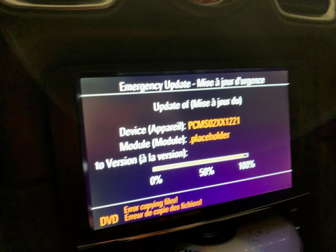

I just got a 2014 Boxster S (981) with PCM 3.1 version 4.73 installed out of the factory.
I'm trying to install 4.76 from the ISO at the download link. The first installation attempt threw me into the Emergency Update mode. Now it gets to close to 100% completion, then "error copying files!". And then I get into the emergency update loop, with it failing at the same point constantly. The PCM isn't able to boot up at all.
How do I get out of this? I tried burning DVD+R and DVD-R discs at 4x speed, so it may not be the disc. Can I go back to a previous version? If so, where is it?

Make SURE to use Verbatim branded discs.... I tried with Maxell and some other brand and those did not work. Tried Verbatim (as stated elsewhere) and worked like a charm...

Just burned v4.76 and upgraded fine. I had to use a 4x DVD+RW Verbatim 4.7GB disc (part Verbatim#94520 1016-203) and burn at 4x rather than the other 16x newer ones that cause the security check errors as noted above.
Did you manage to get this sorted out? This sort of thing does worry me as I don't want to effectively "brick" the PCM

Did not do the "vehicle handover" - still have the navigation destination from original owner in the PCM and the update did just work perfectly. Make sure to follow the burning procedure (slow speed and verbatim disc) and you will be fine!

VERBATIM DVD's, burned at slow speed. Burn all of the files without the folder that originally contained them.
