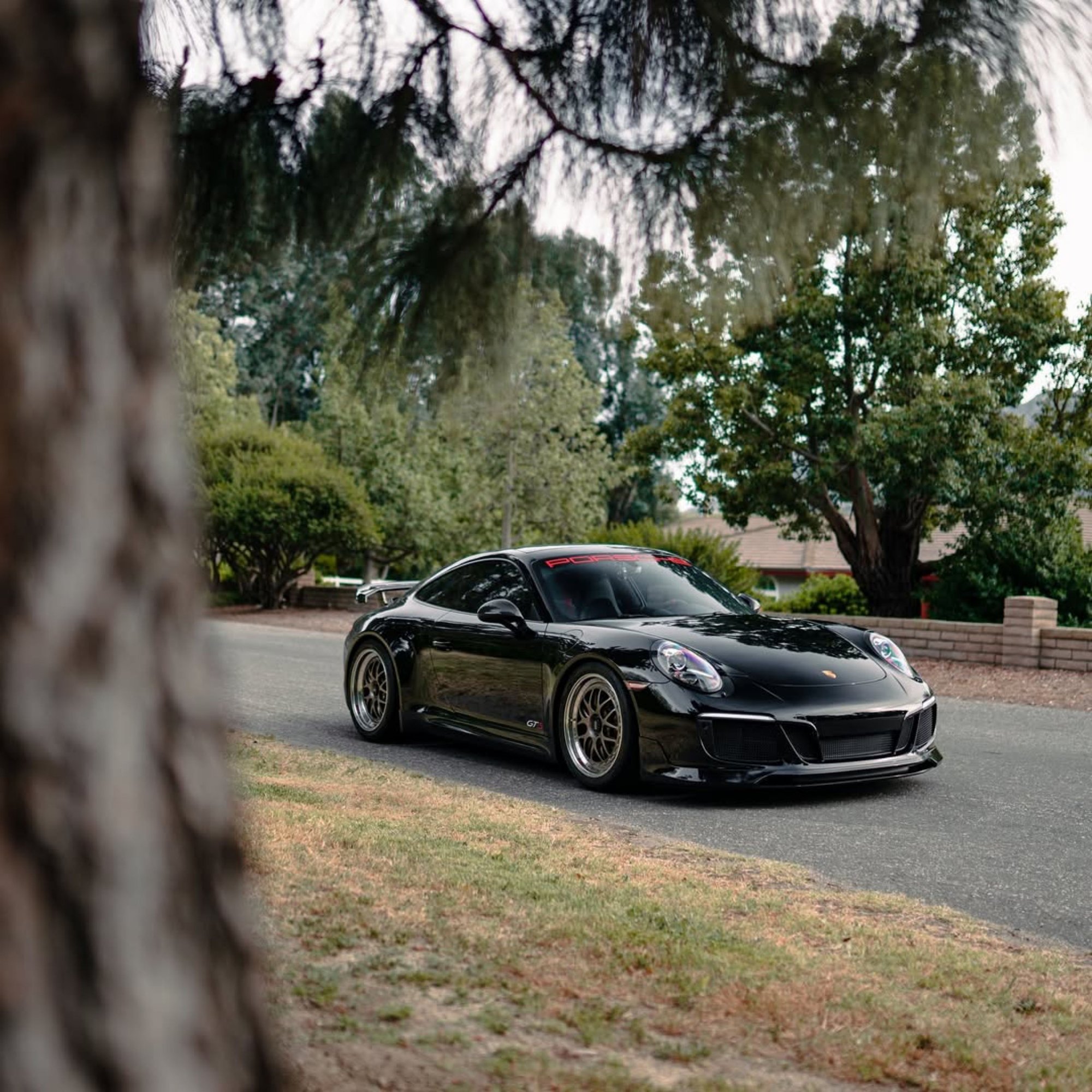

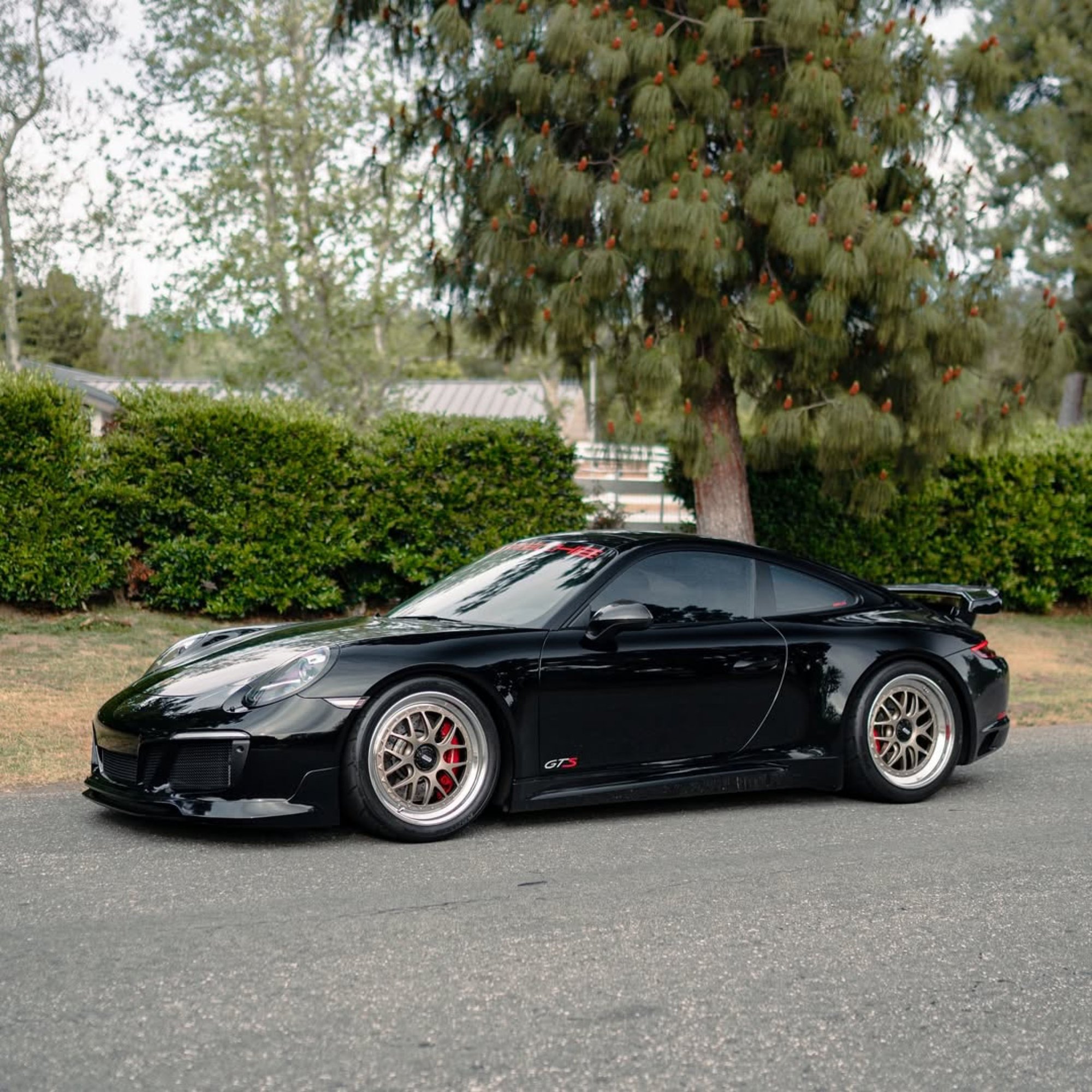

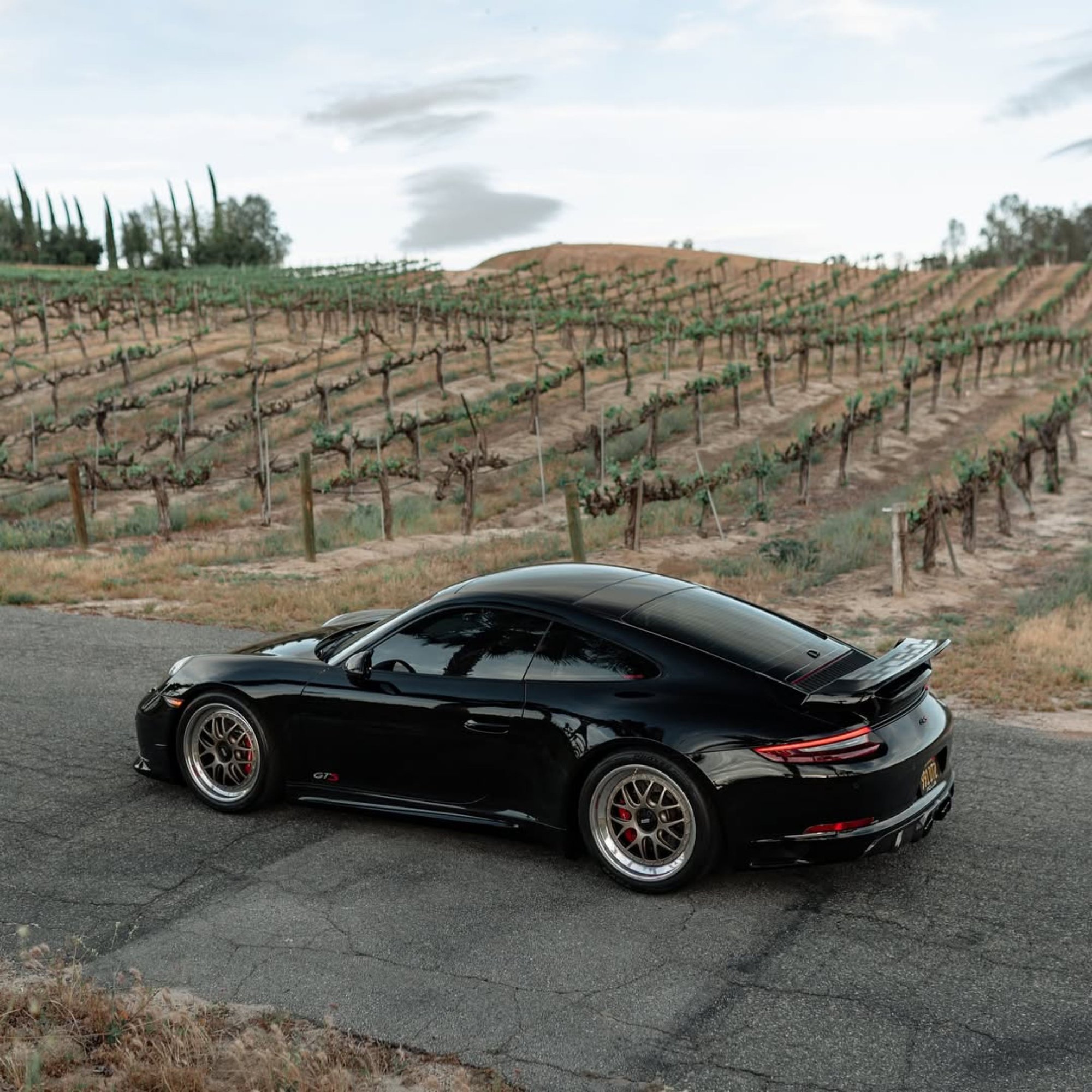

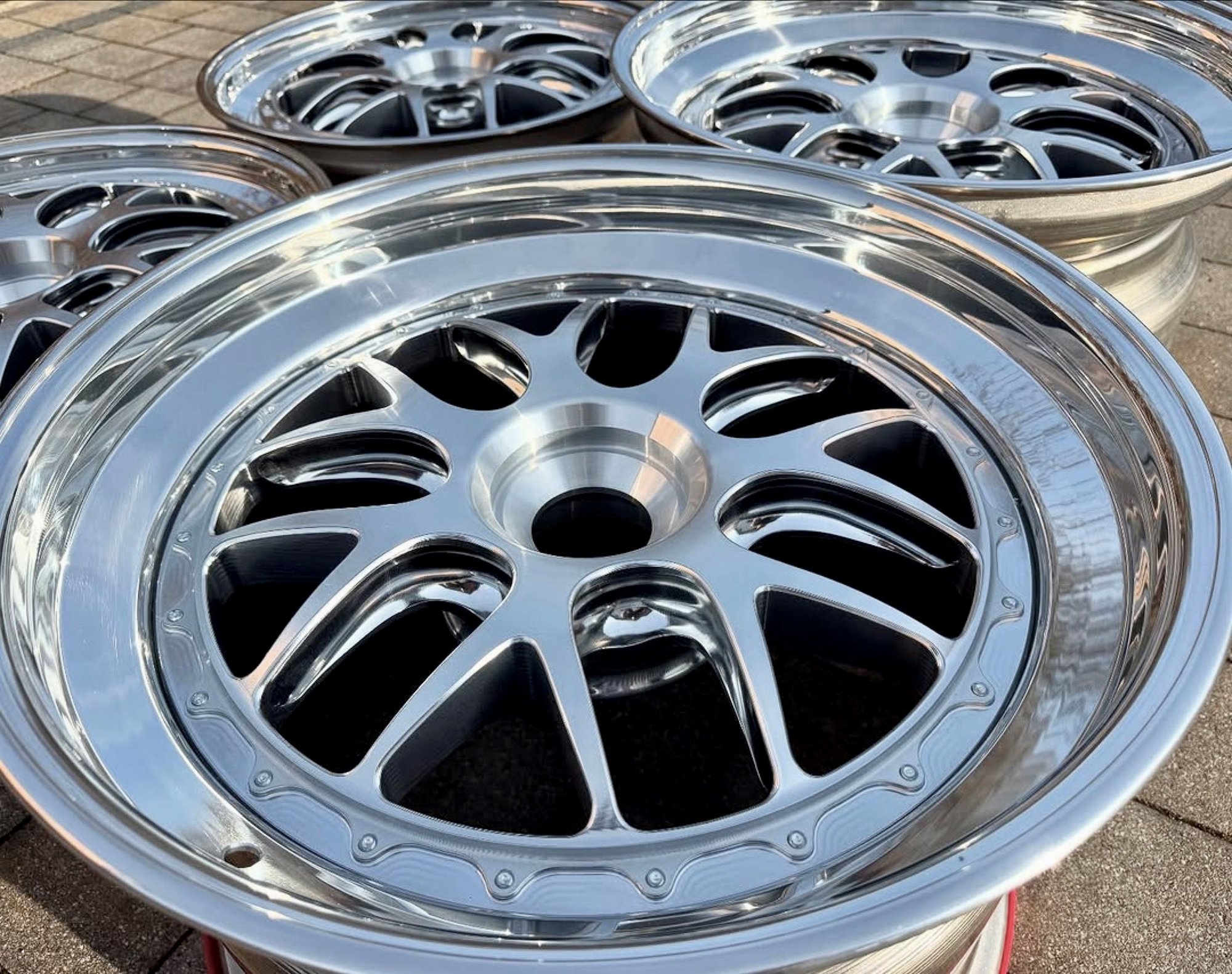

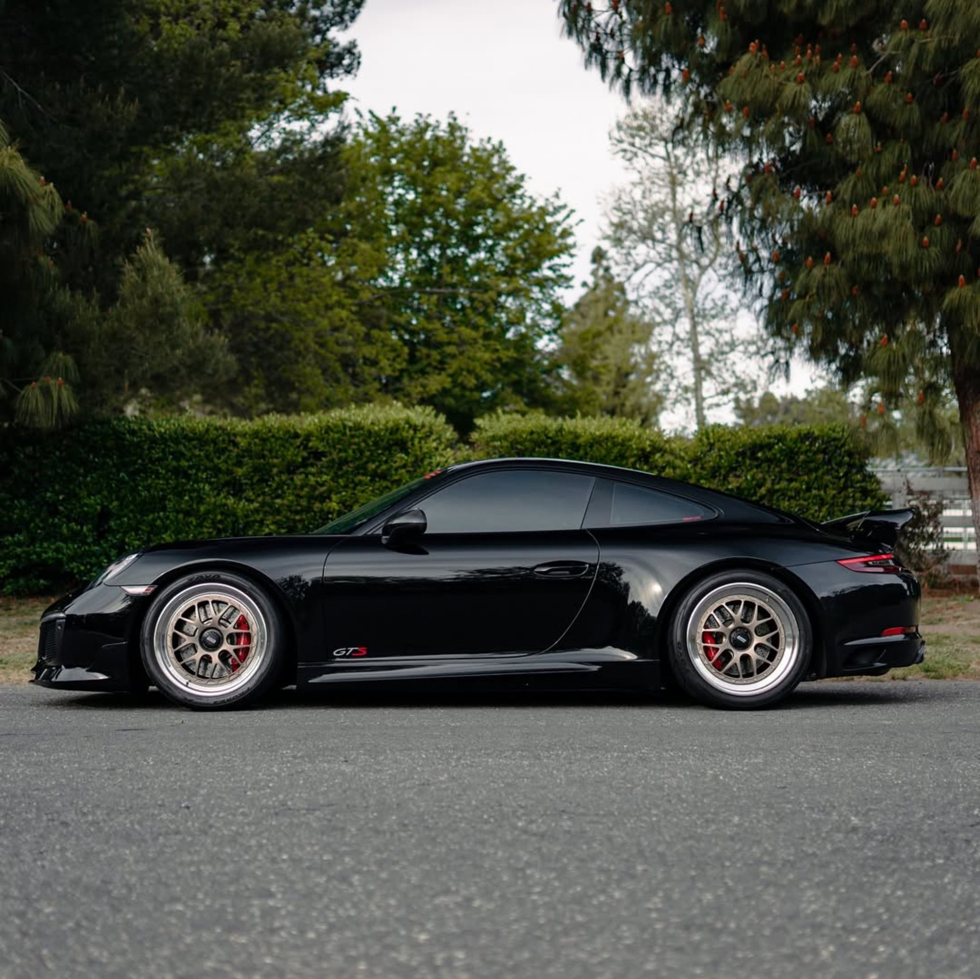

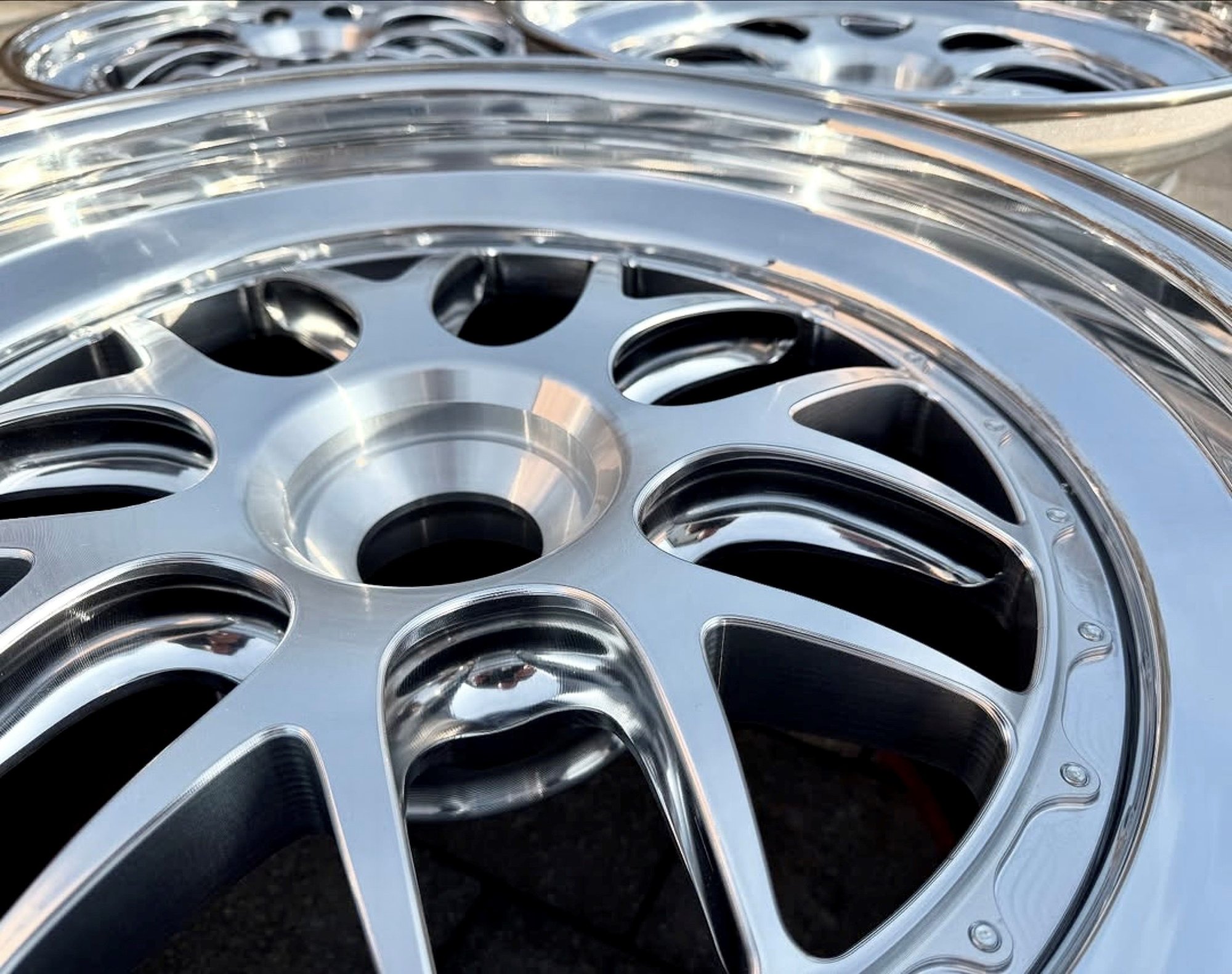

We have new and used e07, e88 & e01 available
e07 cnc clear new
e07 motorsport gold new
e07 motorsport gold used w cup2 265/325
e88 motorsport gold new
e88 silver new
e01 can pick finish
we do not recommend 12.5 et41 for your application though as it will stick out 1/2” more than our fitment below

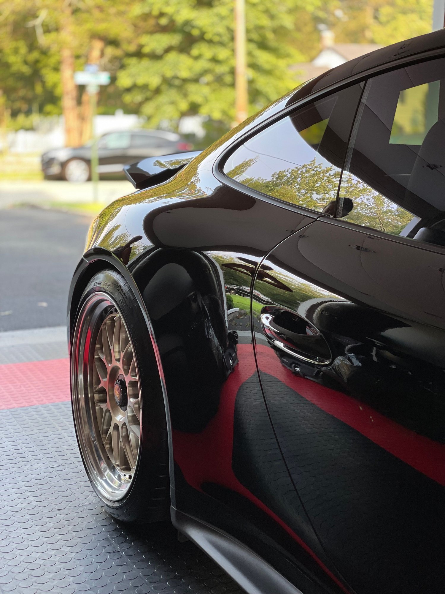

20x9 45 f
20x12 50 r
I ordered this set up with a OEM spec alignment and it fits flushed
