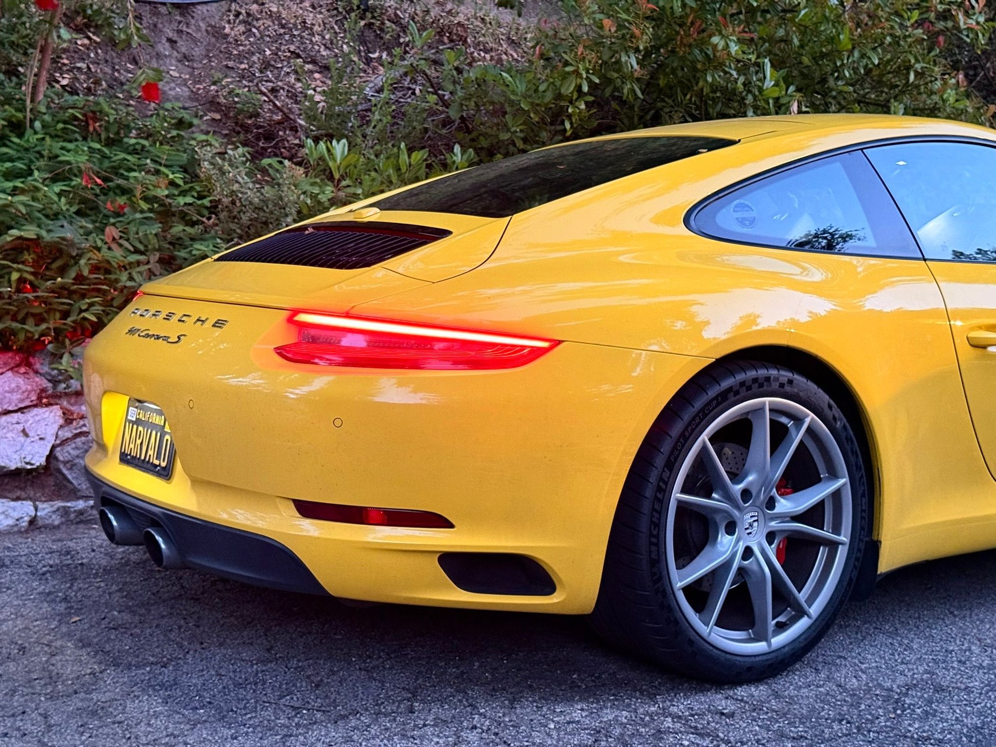

As promised, I got rid of this ugly (to me) black color on the wheels.
Went with a local powder coating company for a "Porsche Silver" coating, and I must say I like this spec a lot better!

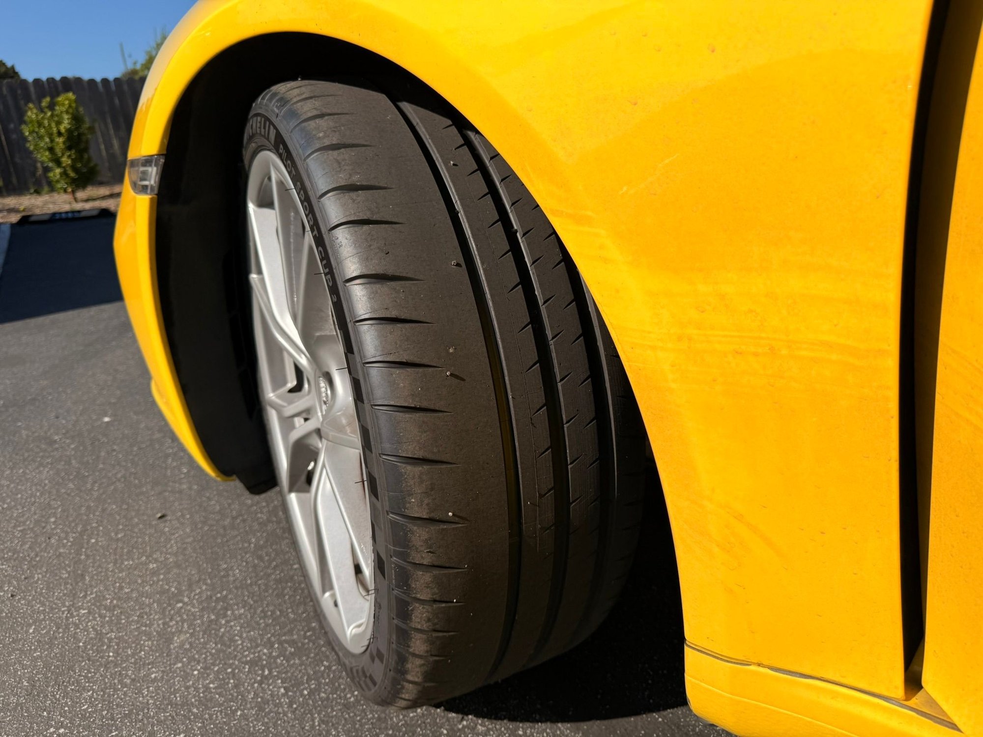

Next up, as you can see on the pictures, was to upgrade the rubber to Cup 2's, and I absolutely love them:
The feel is much improved, and on the backroads... it is like cheating. If you live in a warm ish climate without crazy rain, I recommend this.

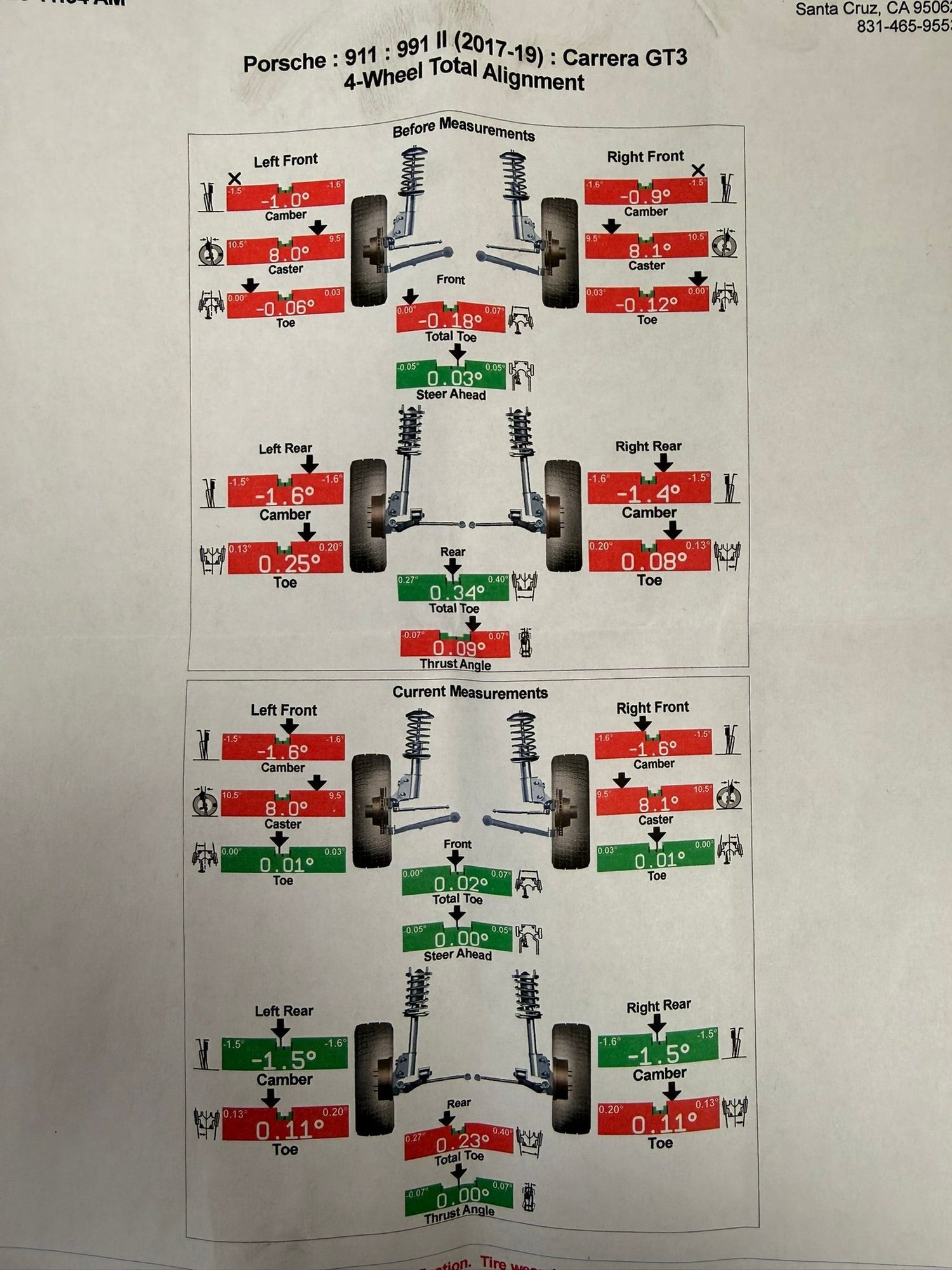

Doig so requuired an aligment, so I asked to maximize front camber, keeping toe minimal (0 is best), and see what I'm working with.
The shop could not get more camber than 1.6, which is way too low for the car to not chew tires on spirited driving.
I will have to work on the suspension components to get more camber (camber plates and control arms).

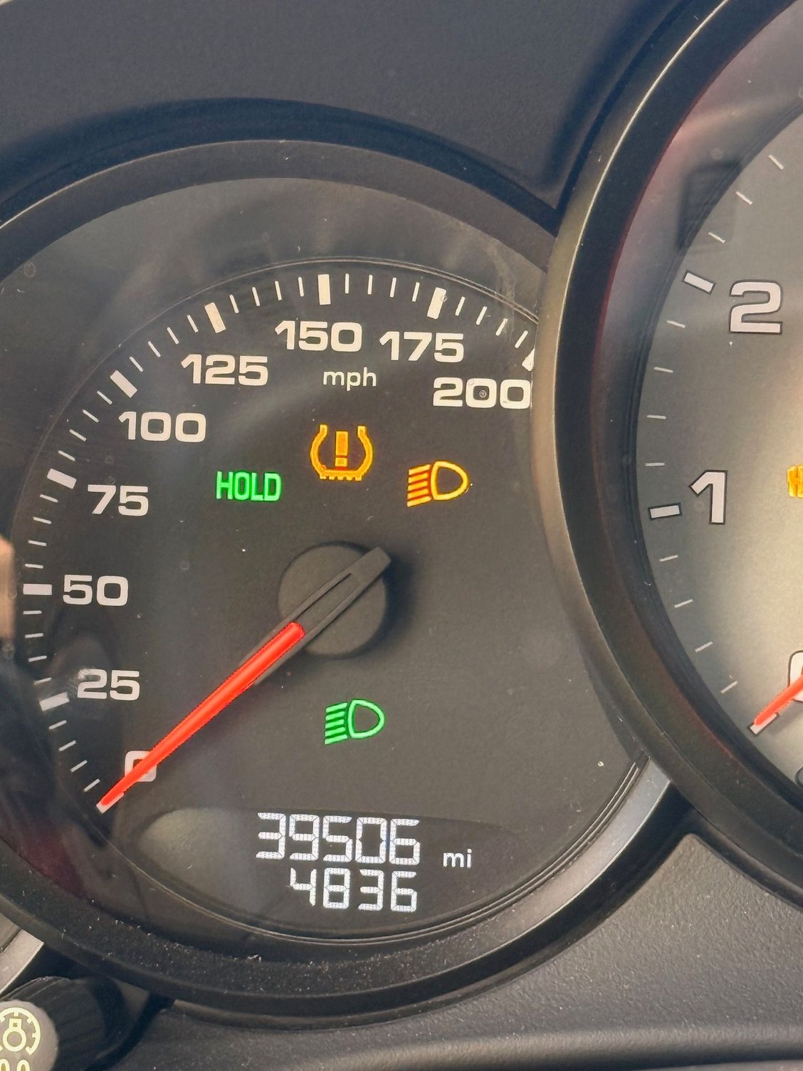

At the same time (05/30/2025) and 36,840 miles, I had the shop replace the transmission mount. This seemed to be a PITA, and given the time they spent on it, I'm happy I delegated this task...$1,148 down the drain, but the mount was cracked.
The feeling is improved, but I didn't quite got rid of this feeling I was describing in my first post.

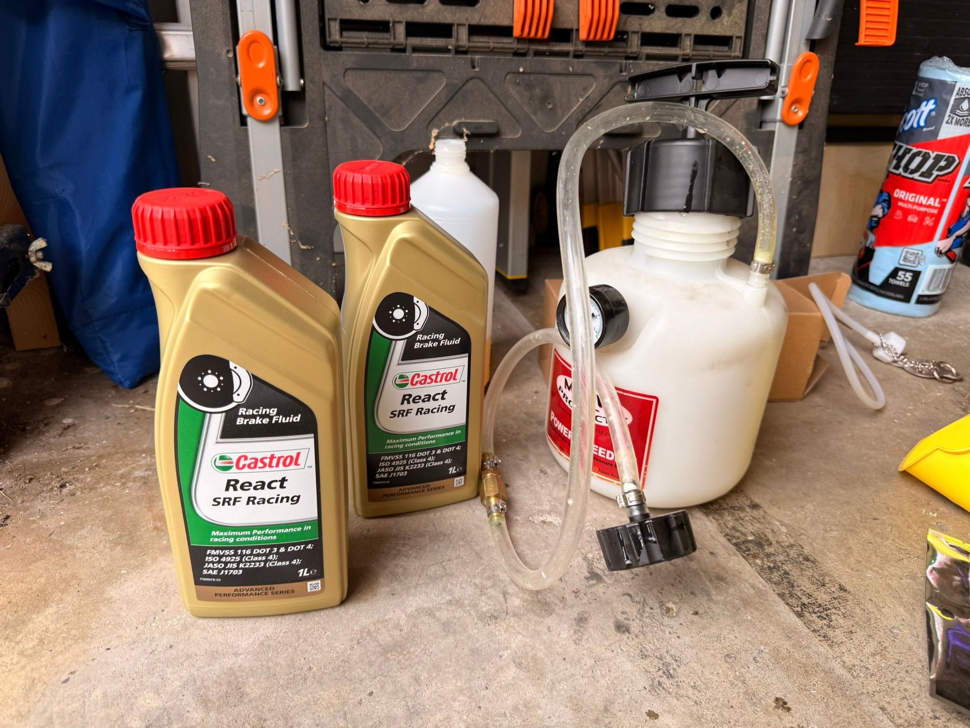

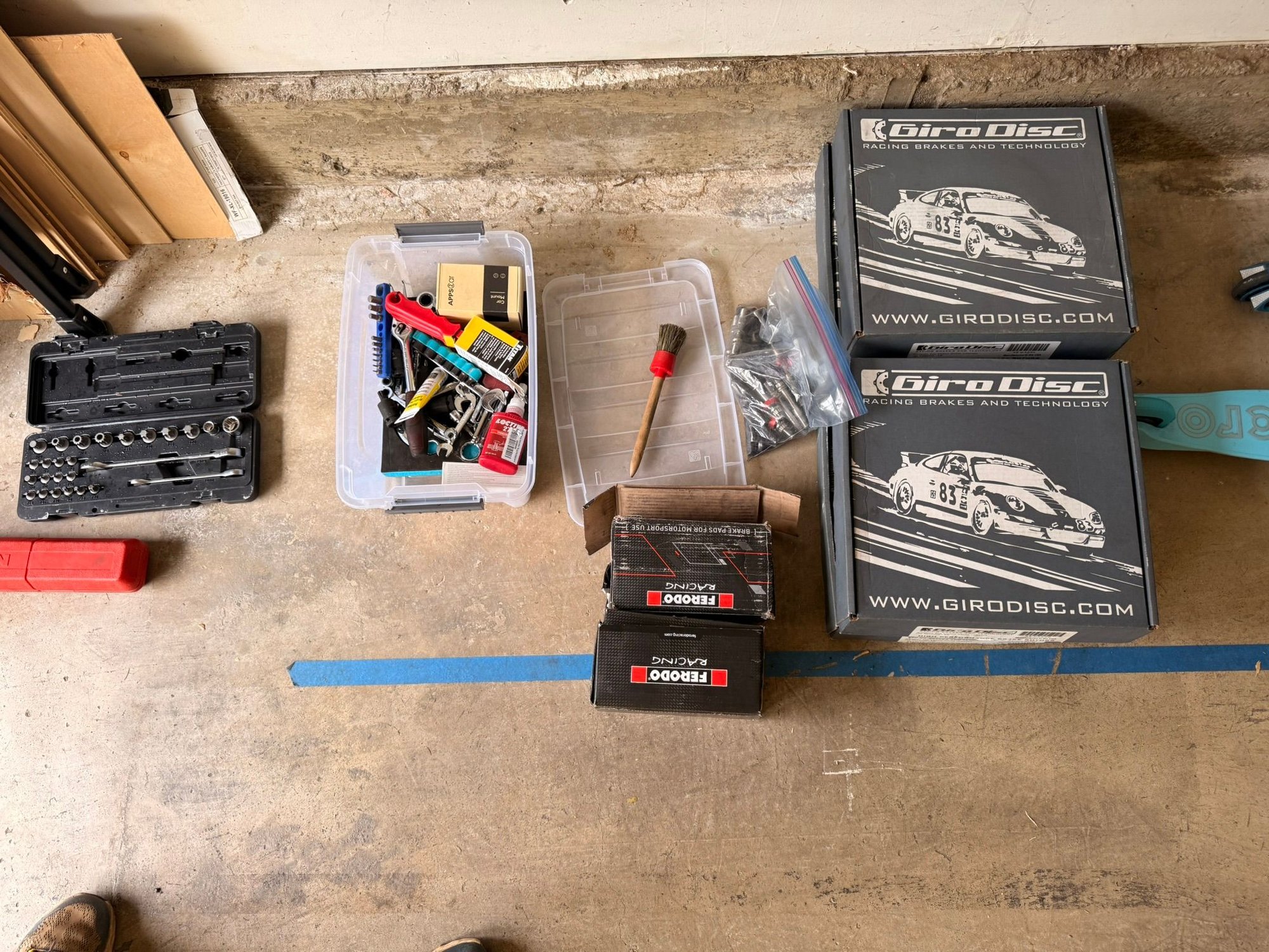

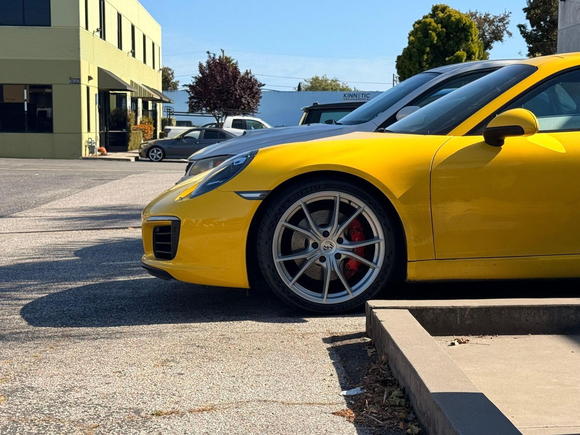

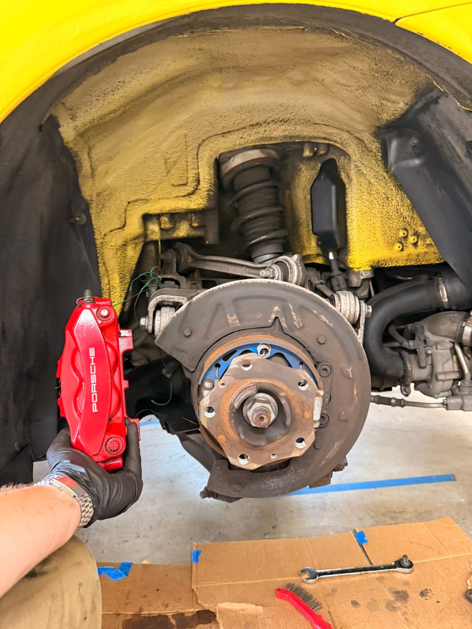

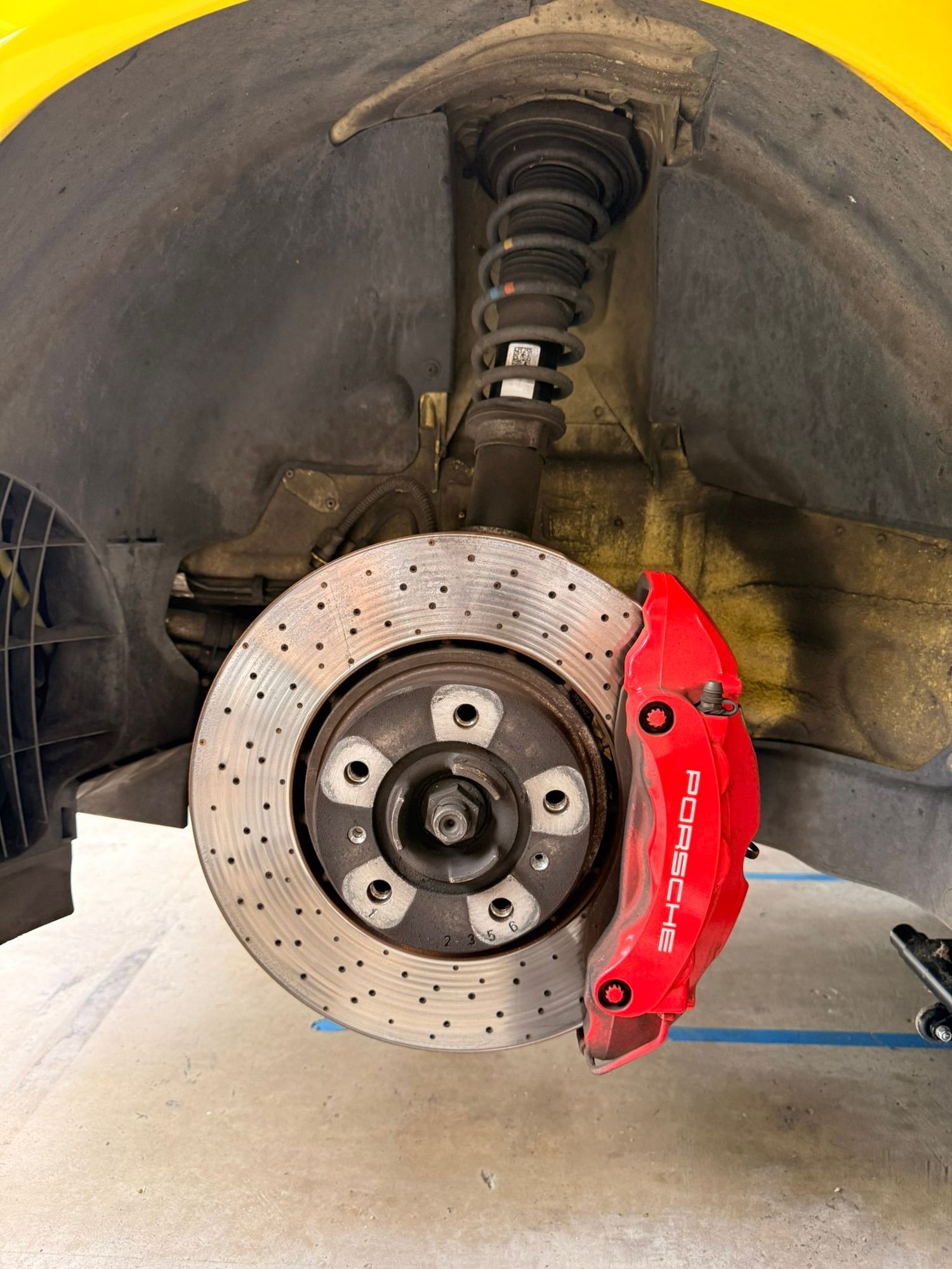

Next up, was revising the braking system!
Installation of:
  • Girodisc 2-piece rotors, 350mm front and rear (caliper spacer on the rear to go 330 to 350mm).
  • Fereodo DS 1.11 pads
  • Castrol SRF fluid
  • Wheel hub stud conversion
I was able to score a good deal on a mildly used set, and I'm happy I jumped on it.

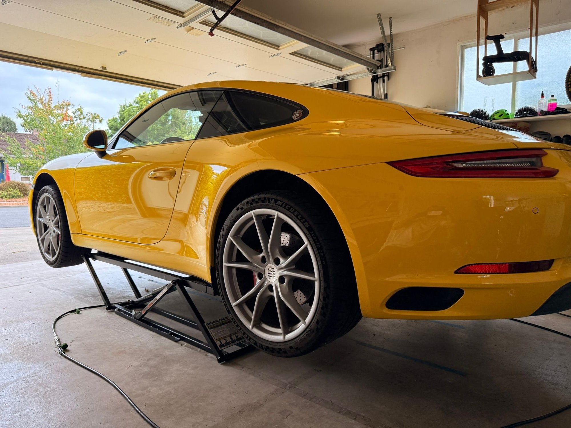

Pretty fun to do with a QuickJack!
SRF Fluid and my trusty motive bleeder
Nice hardware to play with!
Before: the discs are not in a bad shape.
Before: the discs are not in a bad shape, but it is time.
quite dusty environment but not too bad
Quite dusty environment, but not too bad! I spend a TON of degreaser to clean this. Therapeutic activity.

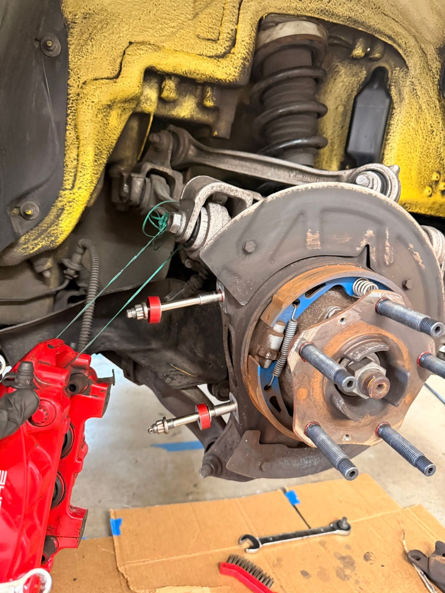

Caliper bolt and stud conversion (for the wheels and calipers)
Caliper bolt and stud conversion (for the wheels and calipers). I cringe, looking at the grime, but I don't have any "Clean" picture to show.

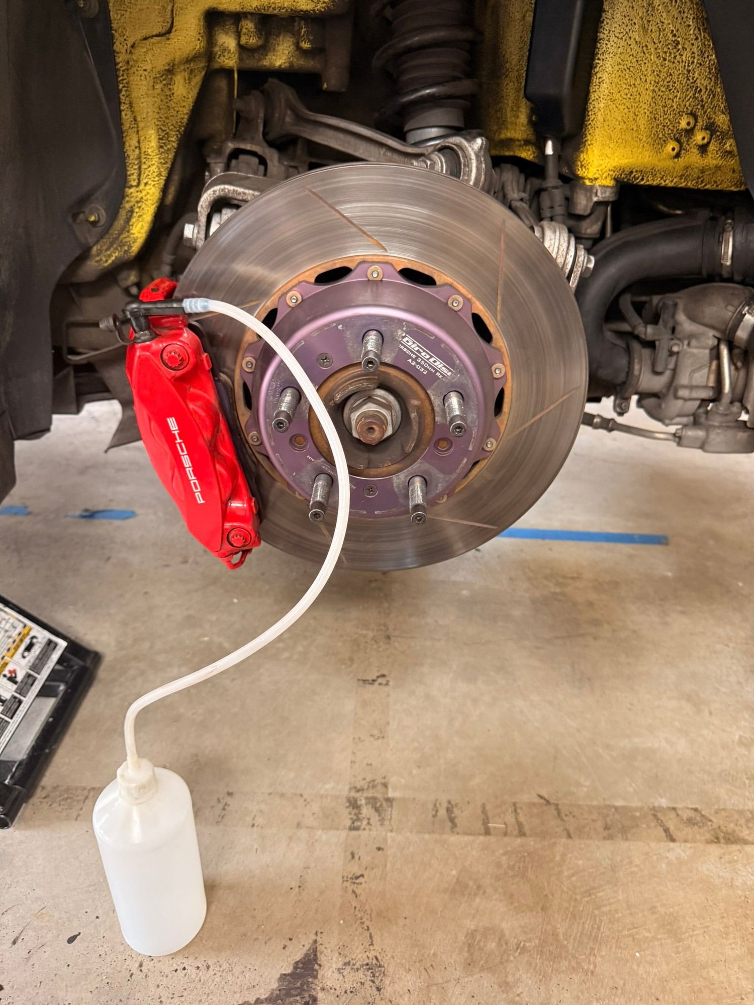

Rotors installed and bleeding procedure ongoing
Rotors installed and bleeding procedure ongoing! Easy with the Foxwell, although you need a friend to push the pedal.
Job done!
Job done!

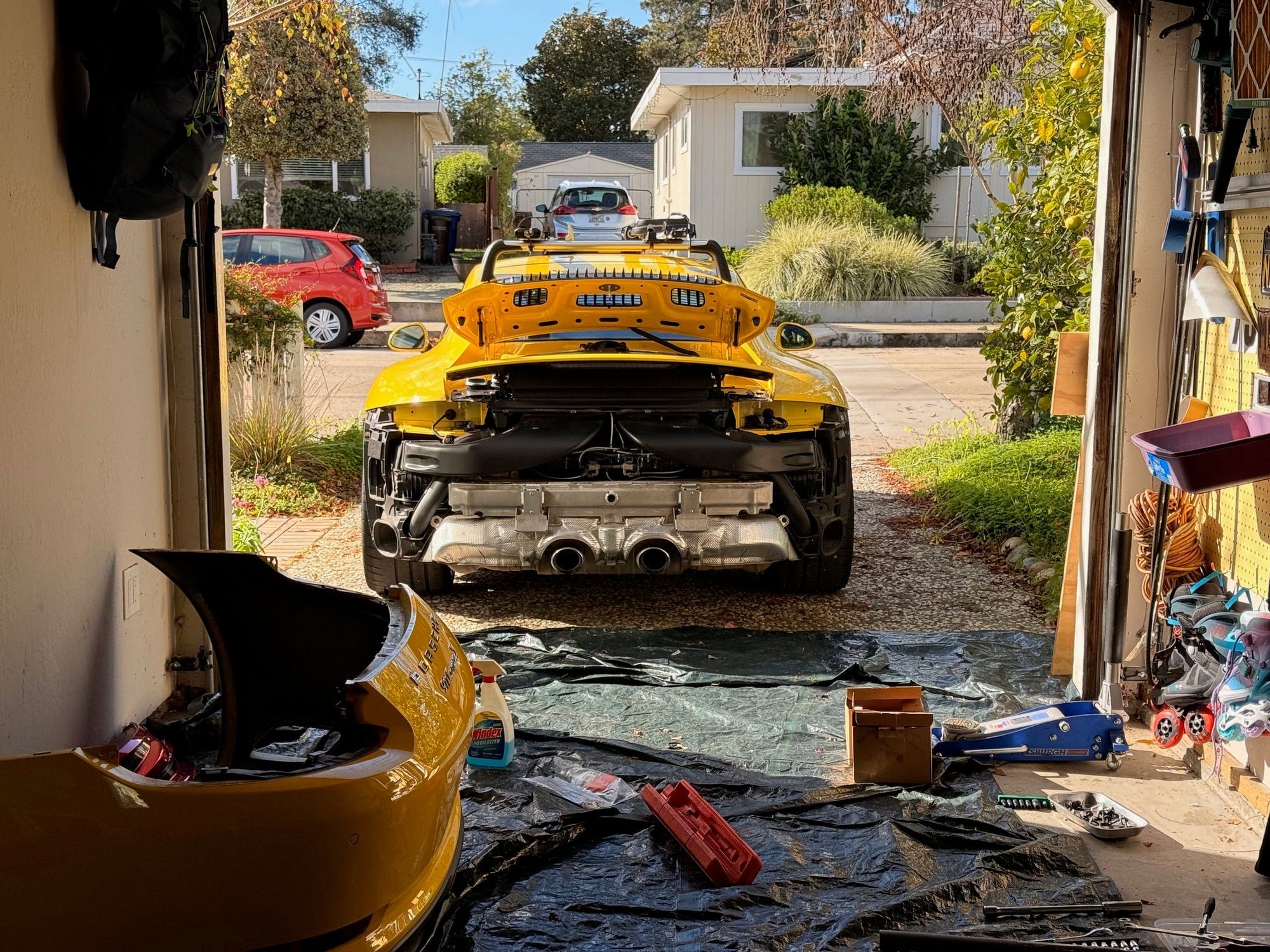

Quick update here, leveraging the break to tackle some stuff.

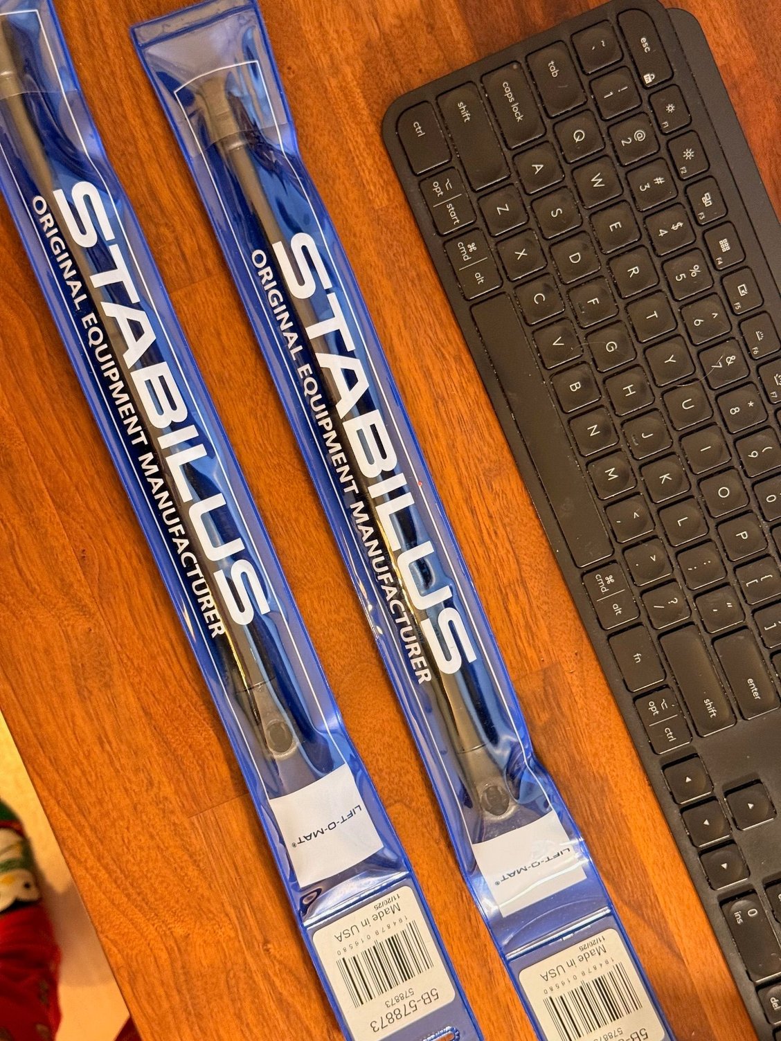

First, a 991 would not be complete without weak hood struts. So I decided to order some from FCP in case (when) they fail.
Quick easy fix, same part as OEM:

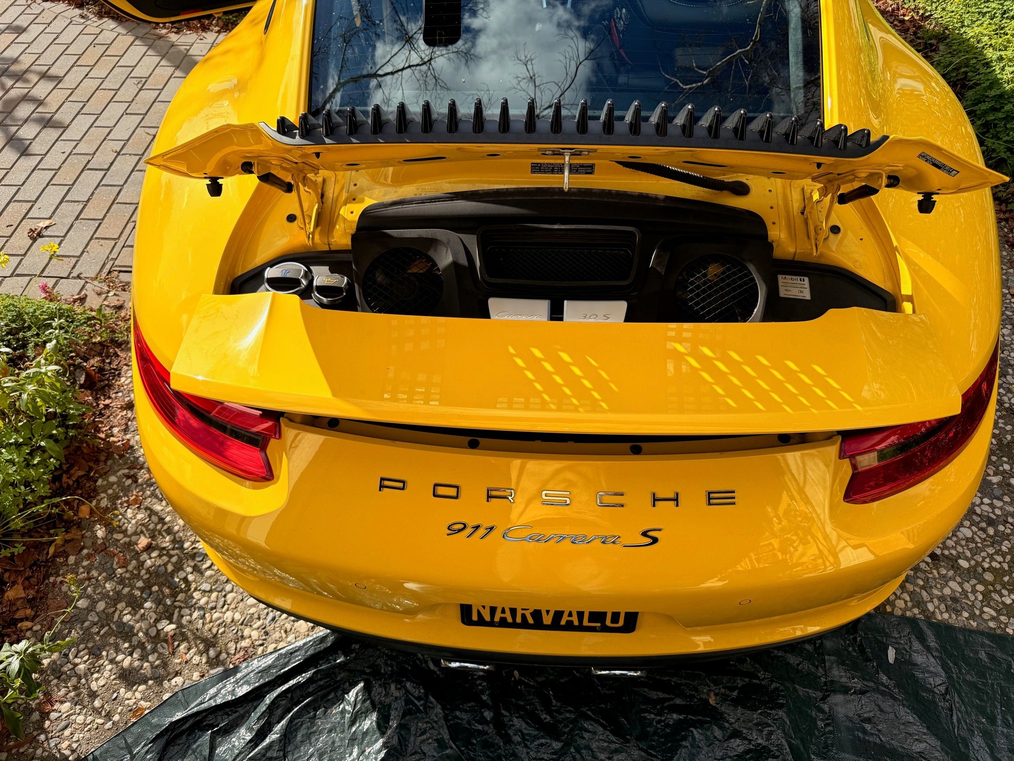

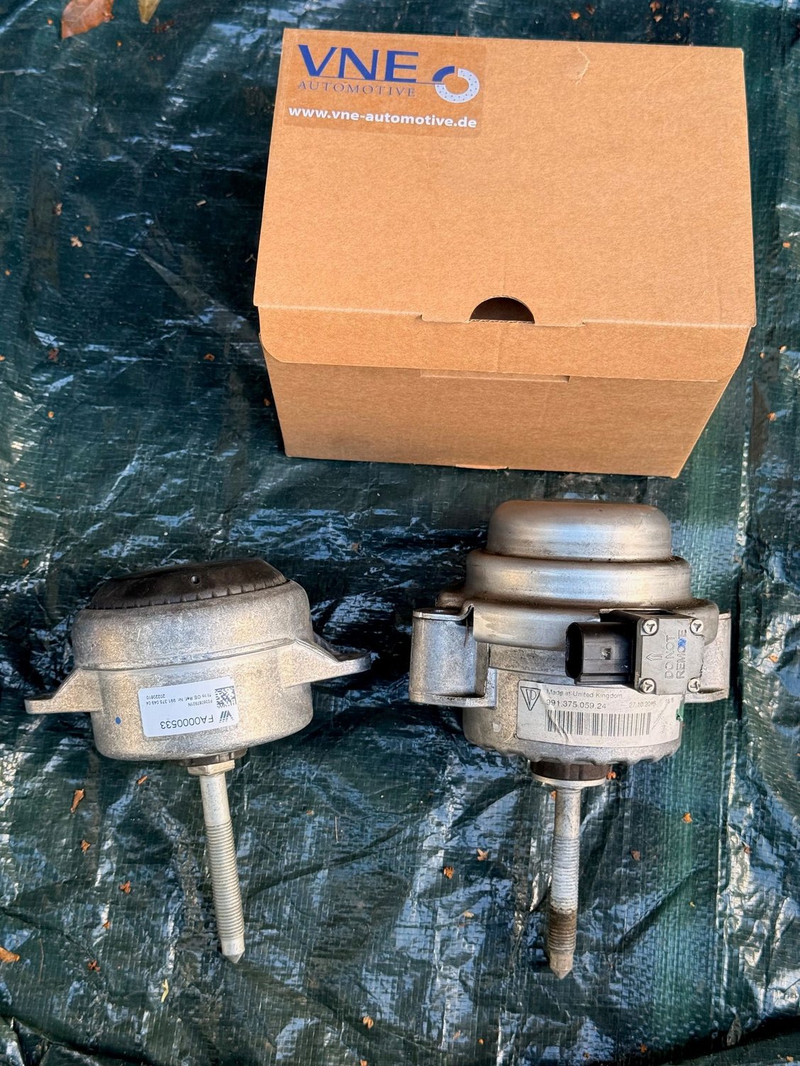

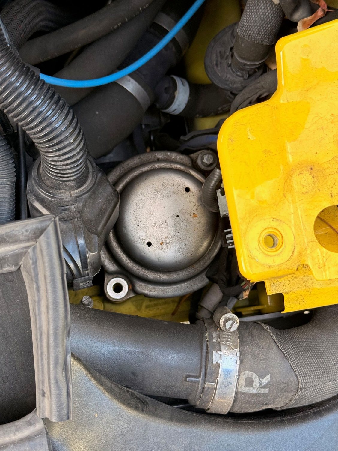

Now, the thing that bothered me since buying this car, which I believe is coming from the active mounts.
Decision made to go with static mounts (OEM) and code out the PADM message. Let's go:

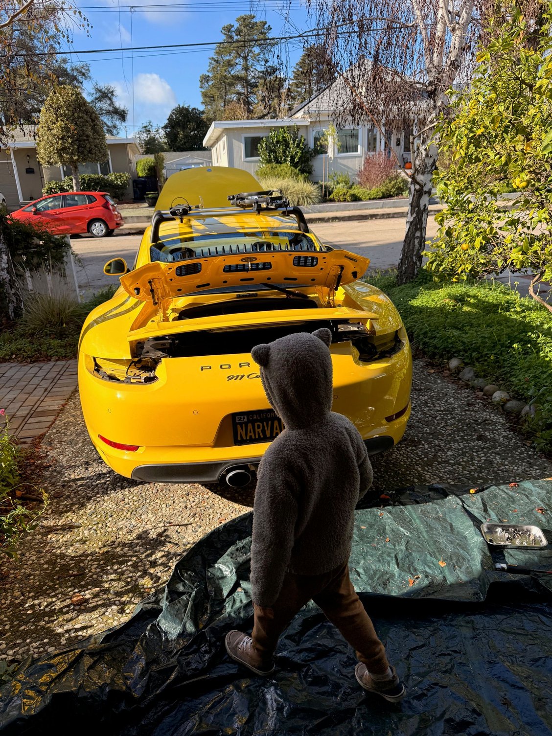

my trusted assistant helping me once more. I'll skip all of the bumper / tail lights / spoiler removal as they are pretty well covered (thank you Pelican for the nice write ups!)

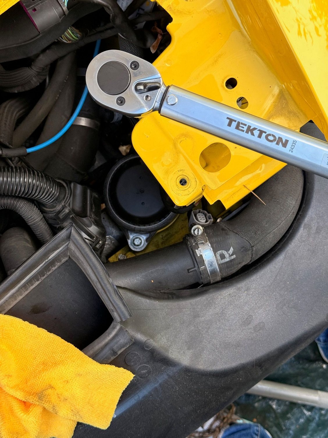

View of the mount from the top. First jack up the engine (just support it), use a sturdy piece of wood to not stress the plastic oil pan. Then remove the bottom 18mm nut, and the two e17 (I believe) screws. The mount can be removed without removing anything else but it is a PITA. the housing seen on the lef of this picture is interfering. See the difference in size below:
PADM mount on the right, Static mount on the left... Weight savings! I will open the active mount to see if there is anything weird with it. I have a feeling it is "tired" which is interesting, as I believe these do not have any rubber, just ferromagnetic fluid.
New mount ready to be torqued. 23 N.m for the top screws and 86 N.m for the 18mm nut. All new hardware of course.
Both mounts replaced, now reassembling the bumper / lights. spoiler...
All done, all clean, feelin' good!

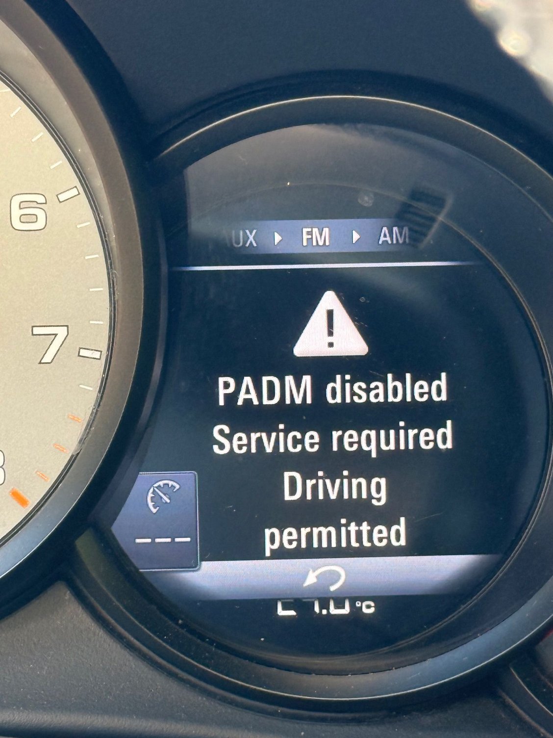

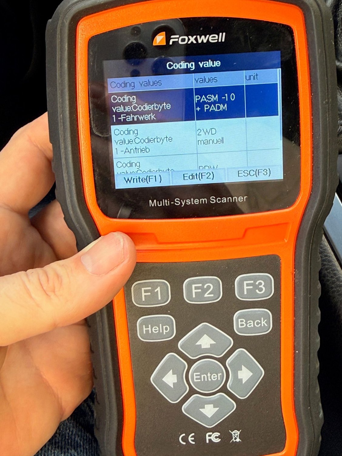

Of course, warning lights galore...
This one was expected.

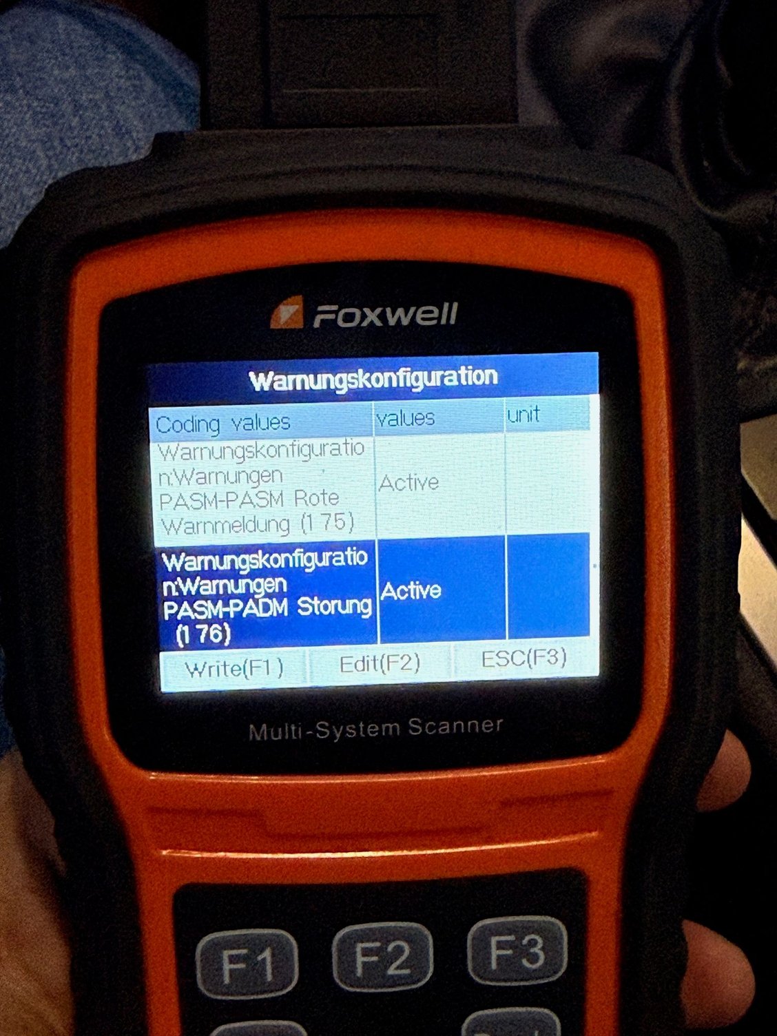

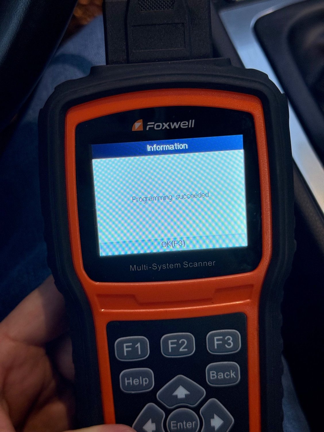

Tried playing with this setting in the PASM module, reverting to PASM -10 (without the PADM function), but it popped a PASM and headlight failure. I was a bit scared but able to revert to normal. oof!
Playing again with coding, I found this setting in the instrument cluster, which basically prevents the fault to be displayed on the dash. This seems to be the ticket, as coding out PADM seems tricky, unless you have a DSC controller. It seems a specific version of PIWIS is needed (not the latest). The fault can be present and doesn't affect anything (PASM / PSM etc.)
BIG SUCCESS! no fault, all good
After driving just around in the city, the car feels more solid. No more weid after shake in the steering wheel. What was bothering me is gone, I'm happy.
I have to drive on the highway to validate the experiment, and open these mounts to understand what happened.
Advice: Your PADM mounts could be tired and not displaying a fault. If you fell the car a bit "loose", particularily at the steering wheel (it is SUBTLE but I'm paranoid), it might be worth going with static mounts.
Oh,and I also coded the true water temp values with the NT530, amazing little gizmo!
See you Rennlist!

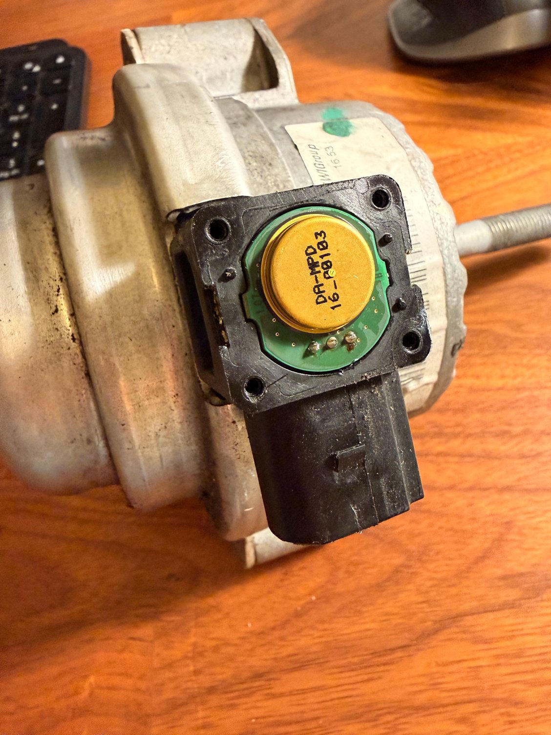

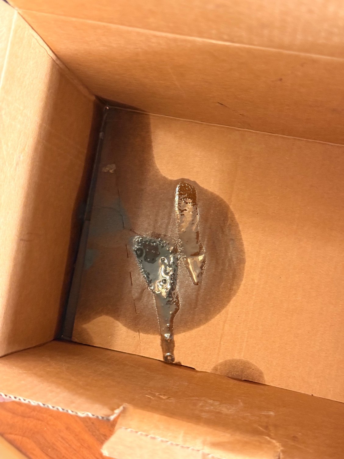

EDIT: checked the mounts themselves, I was surprised at first to see nothing out of the ordinary on the PCB side. This is where they fail (liquid penetrates through the sensors and damages the PCB, leading to a loss of signal and a fault).
Nothing wrong on either mount, dry as new. Weird.

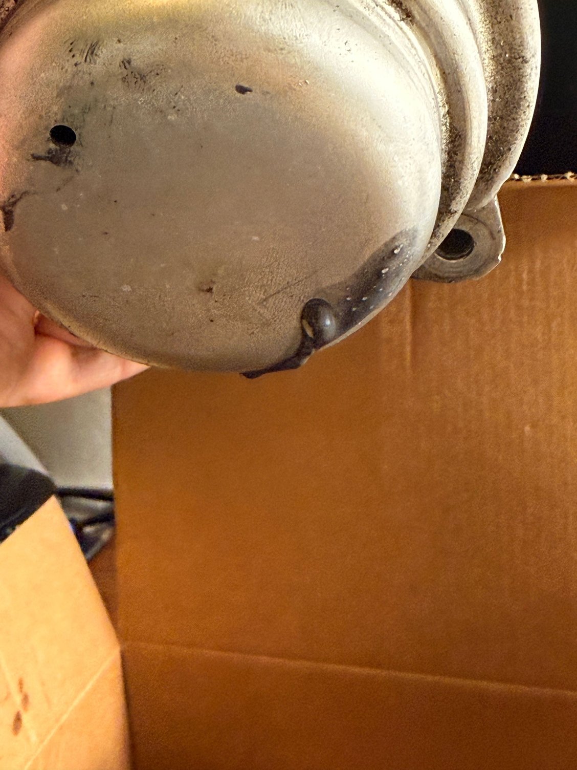

Checking the box I used to store the mount, suspicious stain…
Flipping the mount upside down, yep this is coming from the mount. I’m not sure this is supposed to leak like that… Little bit less on the other side but still some leaking happening, albeit more watery, as if the fluid was contaminated with water.
Interestingly, the values for pressure and current (both signals monitored for PADM) were still within spec, as I had no fault. This means the mounts can indeed start to fail without you knowing about it. Happy I did all of this, my suspicion is confirmed!

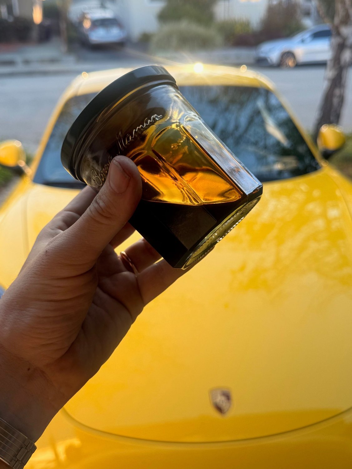

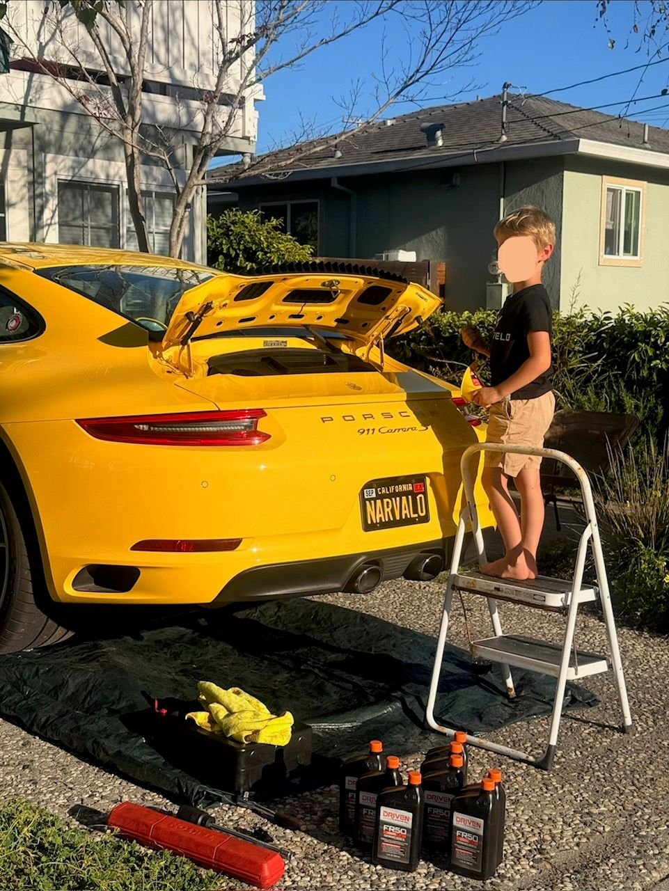

First things first, some maintenance (oil change) at 40,855Mi. Oil was sent to Speediagnostix for analysis, pending results.
I used again Driven FR50:
My little helper always around <img src=" class="post_inline_image" data-size="961x1280" loading="lazy" />
The oil was not looking bad at all, but will be sent for analysis anyway.
Oil filter, cabin filter, belt will come after the racetrack, alongside the first mods.
