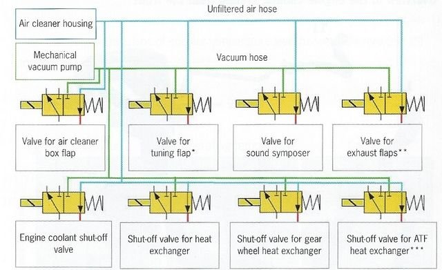

This for my 991.1, but it is probably pretty similar and shows how the changeover valves interact.

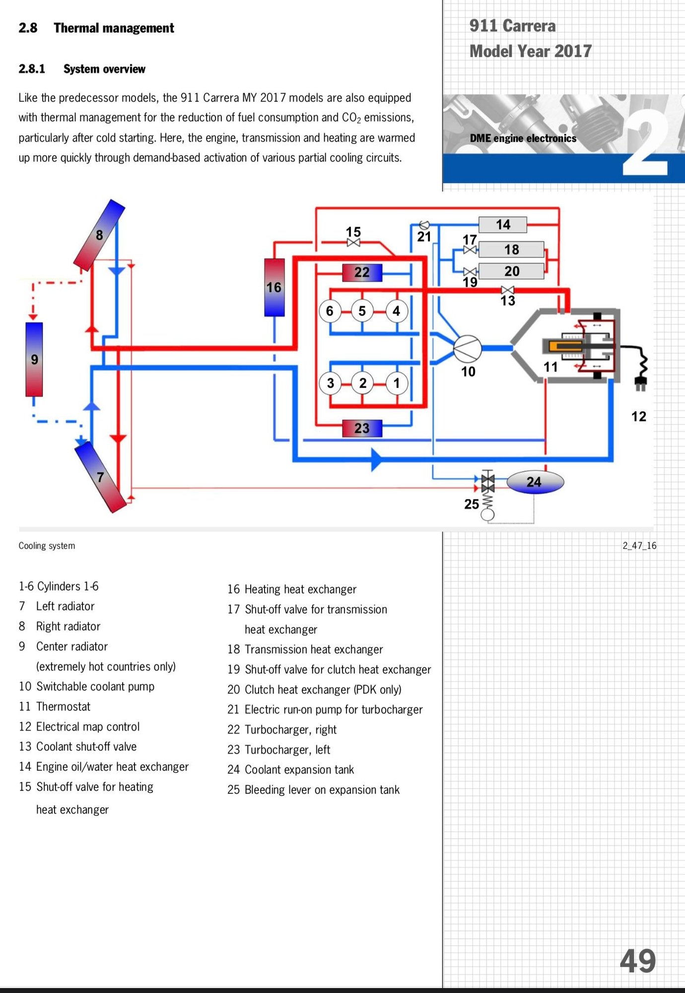

Here is some data.
