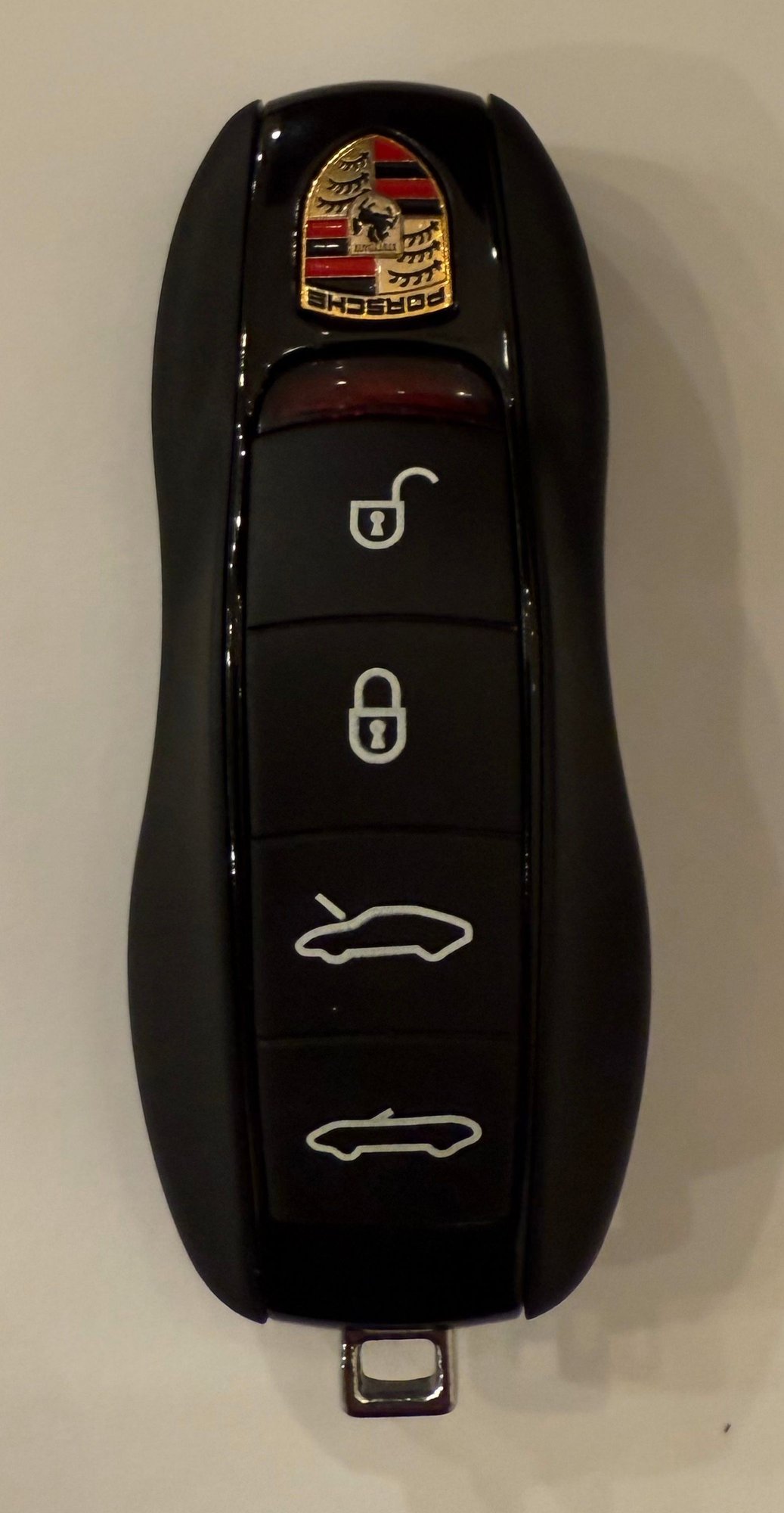

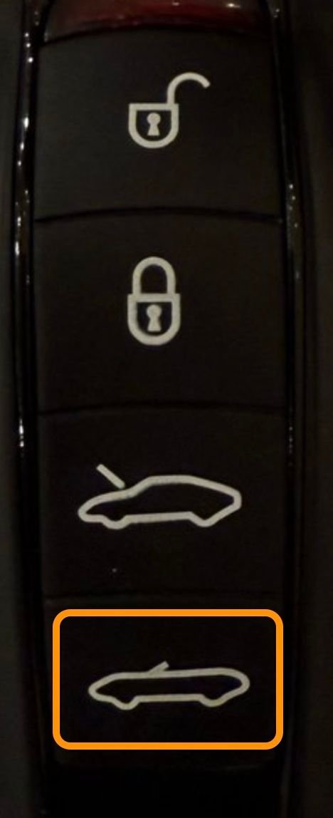

Part 1 - How it started. I have a new-to-me 2018 Carrera Cabrio, and I want the remote (and door handle) to be able to open/close the top without using a SmartTop. I started off by blatantly assuming I could do some coding via PIWIS/Launch x431 to work some magic. That means the first order of business is getting the proper four button rubber cover and four button plastic "mask" installed on my key. I got a basic entire four-button key from Amazon and the four button rubber cover for cabrios from Ali Express. With some disassembly, part swapping, and re-assembly, voila. Links and Pictures below.

The star of the show:

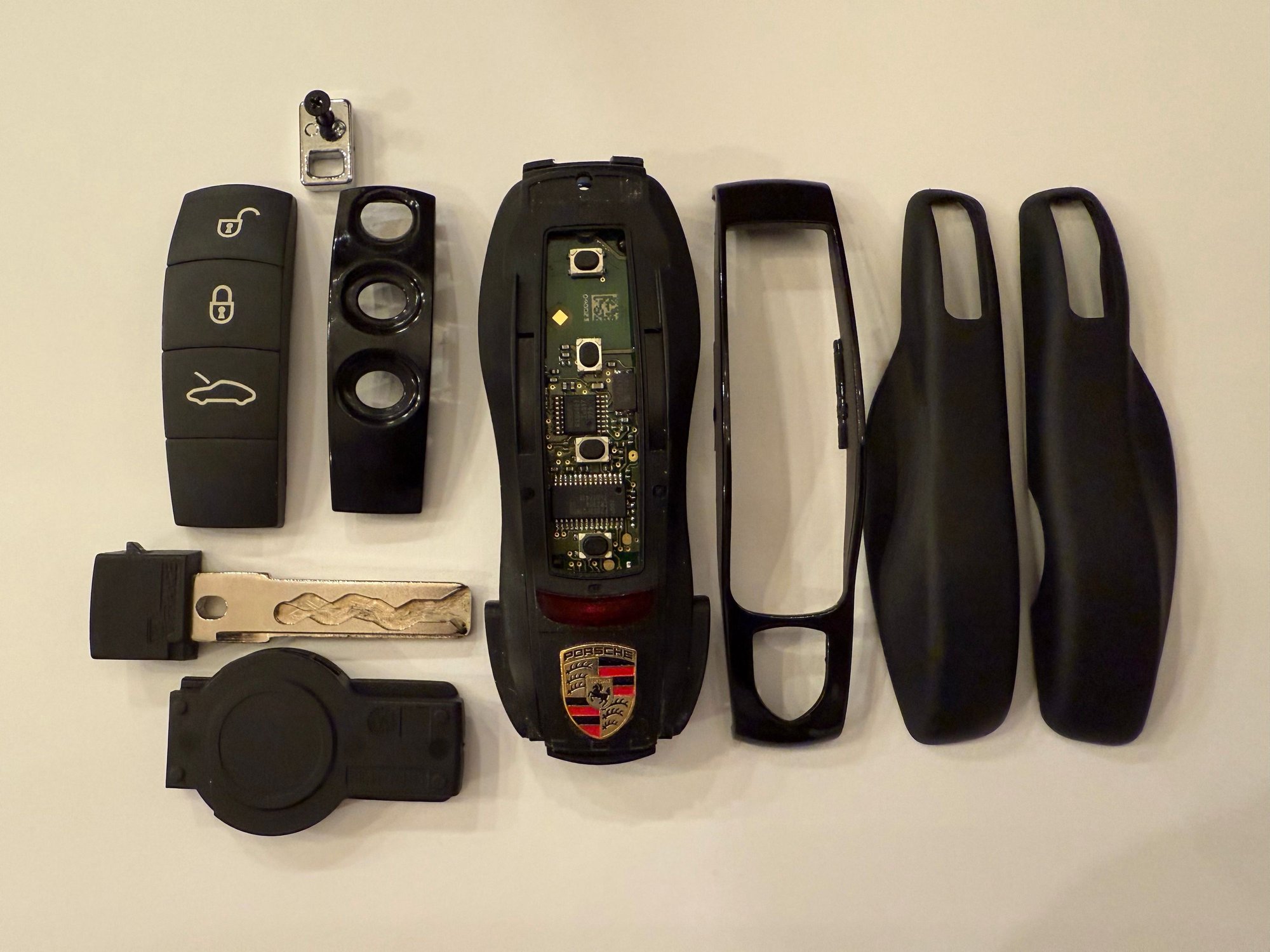

The original key, disassembled so that I could swap out the 3-button rubber and plastic pieces for the 4-button pieces. Note that the remote's electronics have four buttons.
The donor key from Amazon with the 4-button plastic mask (plastic thing with four holes, 1 spot in from the far right), along with the 4-button rubber cover for convertibles (far left)
The key as I hope to use it. Yeah, the replacement side shells don't seem to fit very well - I'll fix that later.

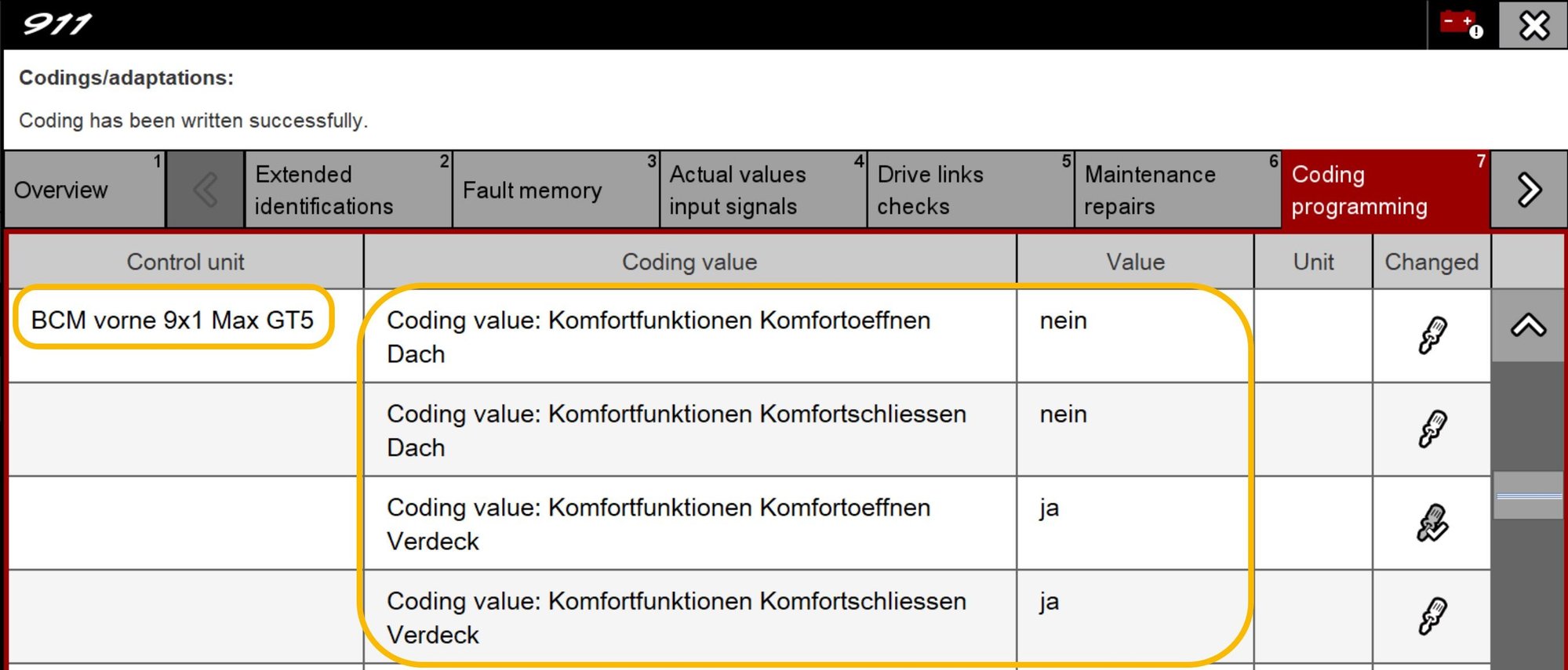

Here's the specifics of what I enabled from a PIWIS perspective using manual code with no rules:

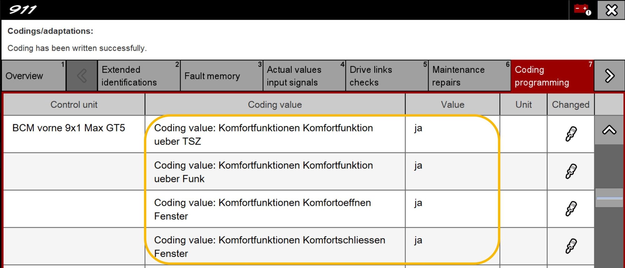

This first set does the following in BCM Vorne (Front End Electronics for you Launch folks). In plain (Launch) English you are setting the following to Yes.
Coding value-Comfort functions-Comfort functions via door lock - Yes
Coding value-Comfort functions-Comfort functions via remote - Yes
Coding value-Comfort functions-Windows comfort opening - Yes
Coding value-Comfort functions-Windows comfort closing - Yes
This second part disables Comfort Access for the Roof, but enables it for the Convertible Top (still in BCM Vorne/Front End Electronics)

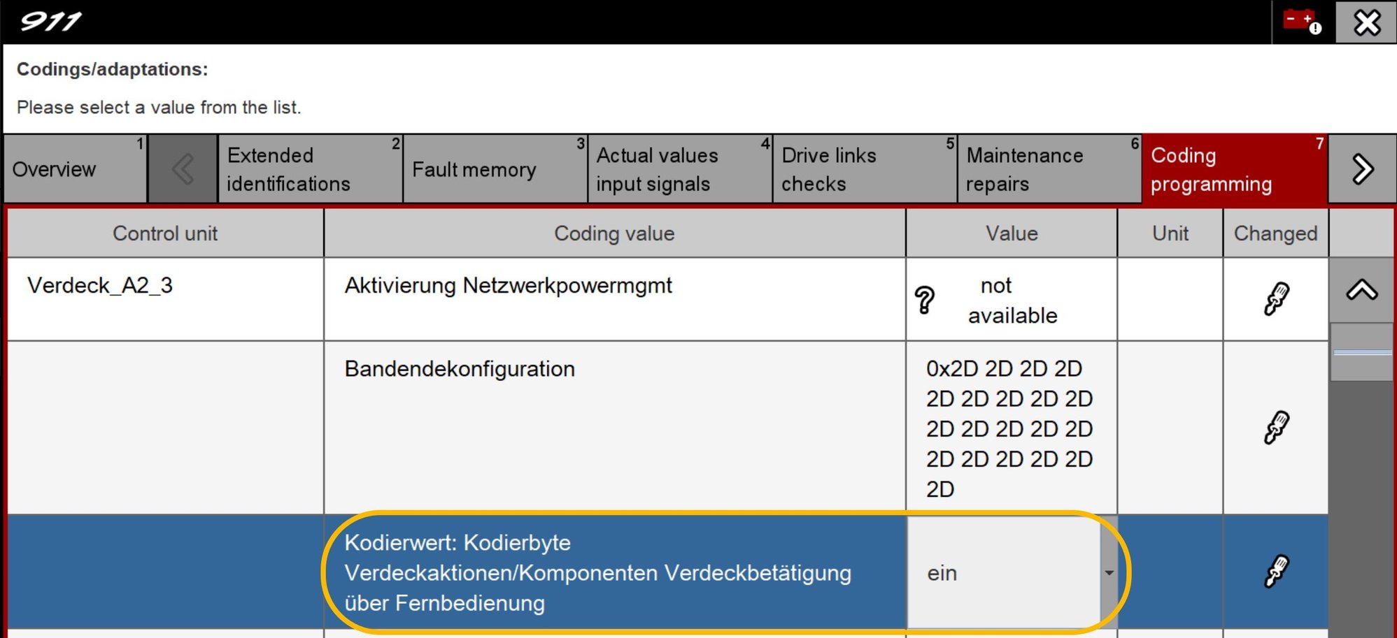

Now - change over to Verdeck (Convertible) control unit, and enable the "top operation via remote control". I cannot perform this step using my Launch x431 (Porsche code 24.42), I had to use my PIWIS (41.400). Your mileage may vary.
