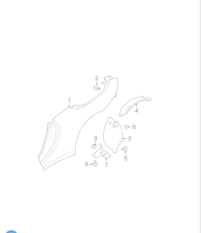

[QUOTE=MarkG123;19013873]You missed replacement of the rear quarter panel, making this is a major repair. Rear quarter will need to be replaced which is major surgery up to the roof line to the front window and the rocker panel below the passenger door both rear and front windows need to come out along with passenger door for replacement of rear quarter panel/rocker panel. This one may be totaled. Interior panels and seats will need to removed in the rear seat area for access to the rear quarter panel.[/QUOTE
The rear quarter panel does NOT to the roofline or front window and is limited to the repair panel as shown.
