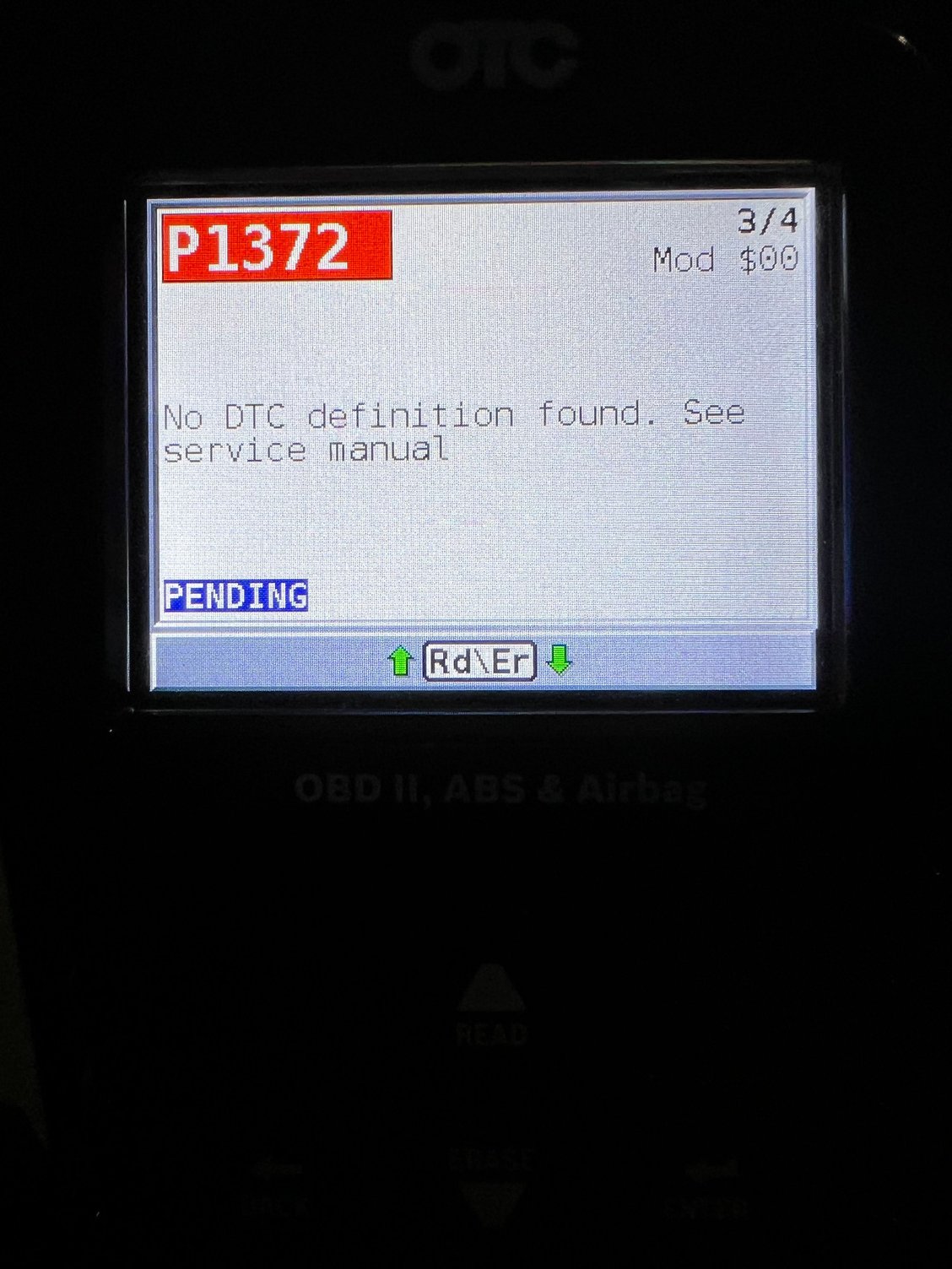

So I recently took delivery of this car and within 10miles of driving I was greeted with the yellow warning and engine check light. Had an oil change place check the codes (screenshots attached). Car is supposed to be under manufacturer warranty so Carvana advised to take it there.
Wanted to know more about these errors and if it’s a result of a tune perhaps?

A quick search shows P2262 came up via a tune (Softronic, which was easily fixed) and from a failed throttle body. No clue which relates to your issue. P1372, I've seen a few references to oil in the passenger turbo causing issues (small amount of oil is normal). When the car is warm, what do the oil levels show?
interesting. So the oil gauge hovers between 1 and 2 on idle. While driving to goes beyond 2 to 3 ish. Not sure why that happens. Also the engine stop start function works erratically, on some stops it doesn’t turn the engine off and some it does. I turned it off on a couple of drives.

Best bet is to see what the dealer says but the threads I read talked about oil frothing when too much/too little oil, which caused additional oil to get into the passenger turbo. The MFD oil measurement is not 100% accurate so maybe too much oil?
