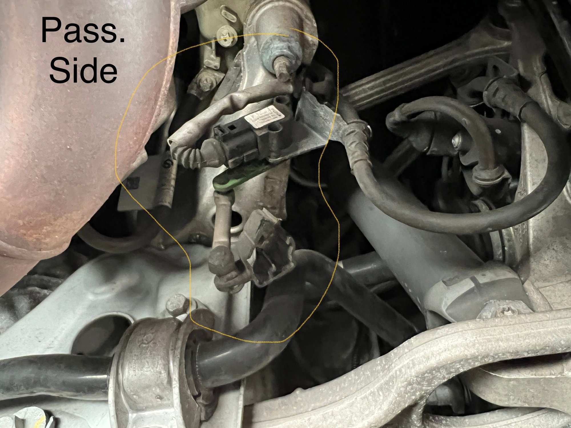

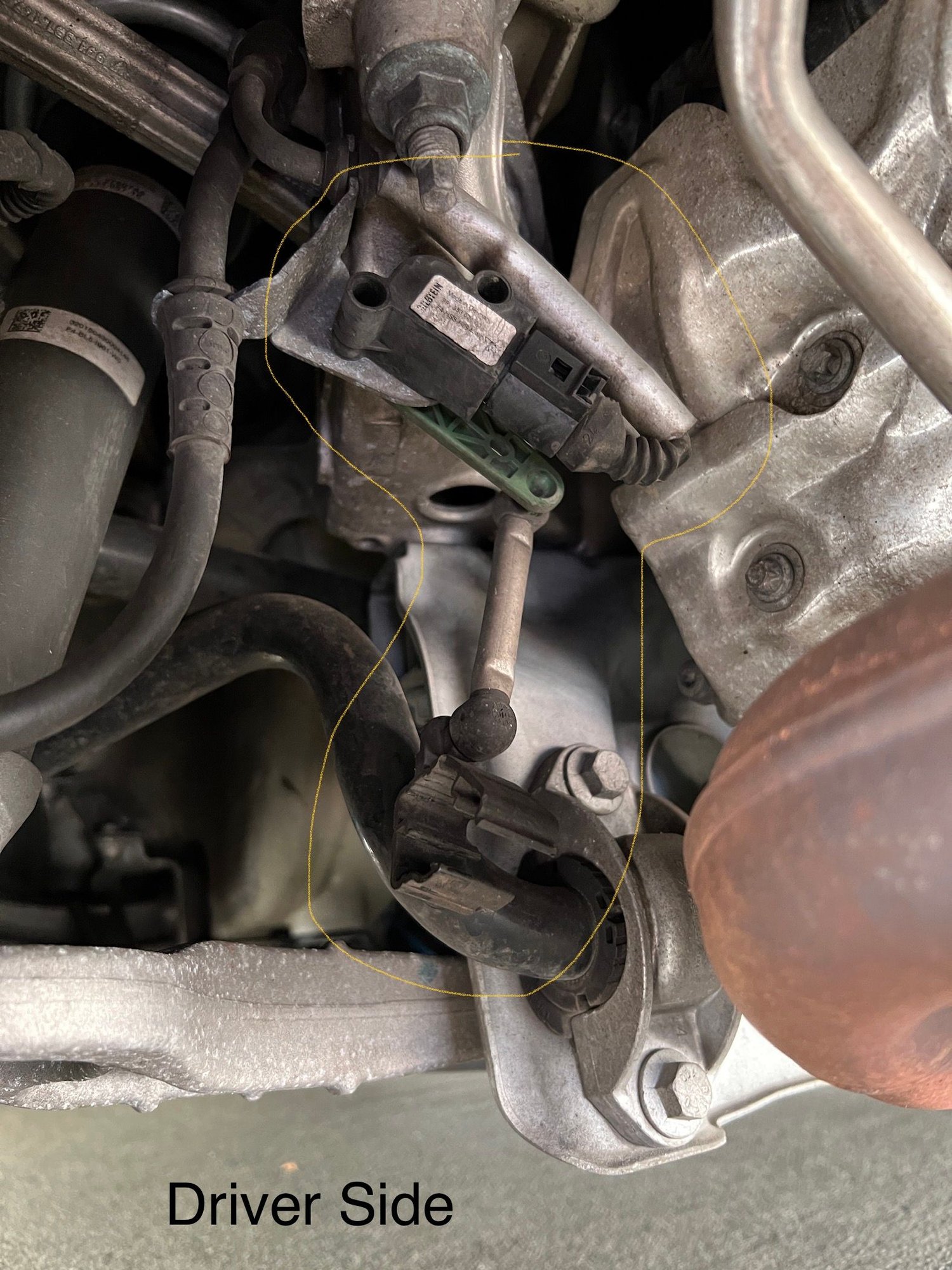

No lights on, but i’m pretty sure they’re supposed to be attached somewhere 😅. They’re right above the sway bar. Could have been forgotten when installing exhaust or springs.
Edit: I found an undercarriage picture online and was able to pinpoint where they attach again on the control arm. Perhaps left unhooked for a reason? I have a 991.1 4S with Techart Springs. Any input would be appreciated.

I believe they are ride height sensors

Isn't that part of your PDCC?

Yep, ride height sensors. They adjust your headlamps as well as serve as sensor input for dynamic suspension.

Thanks guys. I do have PASM so I'm assuming it was just that, and they forgot to put them back in place. Fronts were on correctly. I'm assuming it'll handle even better now since its inputs will be more accurate.
