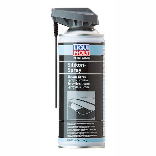

By the way, any suggestions on the type of lube I should use for the top mechanism and rubbers ?

I'm going to be using this one since it was what I was able to find in my country..... the one you are selecting, looks good. I guess anything that is silicone based will work.
