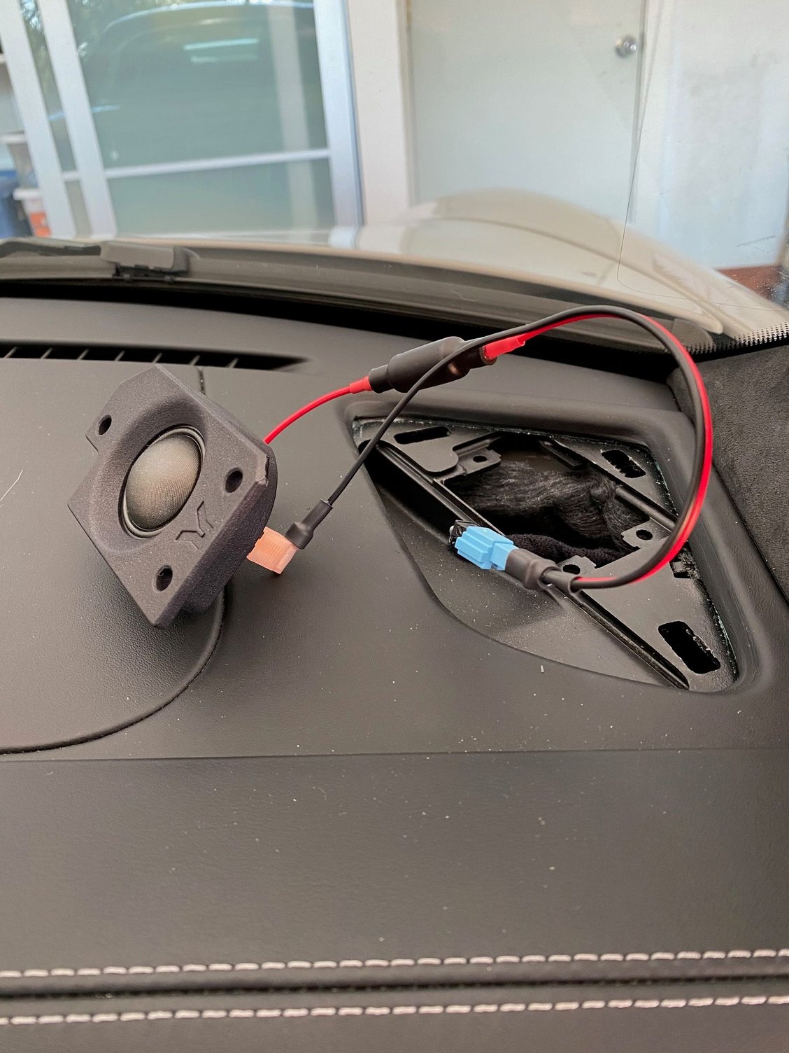

A quick related but unrelated question.
I replaced the factory Bose driver side tweeter with the Dayton Audio. Does it make a difference how the wiring is connected to the actual speaker terminals? The Dayton speaker has a terminal marked red. I’m not sure which wire I connected to that on the drivers side. Everything is cinched up on the drivers side. Looking at the Bose factory speaker, they connected the wire from the R side of the female connector (looking at it head head with the T flanges located at the top) to the cap. I did the same with the driver side.
If the wiring is not consistent side to side will thespeakers be out of phase? I’d rather not have to take out the driver side but will if the wiring must be consistent. Thanks for the help.

So you'll want to ensure the phase is matched side to side, otherwise if they're 180 degree out you'll find they'll cancel out each other in the centre of the 'stage'.
As for phase between them and the door drivers, that's a harder one really as they're already on a different plane and firing on the Z axis (up) vs the X (side to side). Personally I'd check them with a cheap app and ensure they're all phased +ve

Thanks Muu83. I ended up testing the factory wiring to the tweeter with multimeter and indeed the blue with black stripe wire is the positive. This wire went to the cap on the Bose speaker. I did the same and wired this positive wire to the red terminal on the Dayton speaker. Tested using the same audio and with all front, max treble and cycled between left and right. Everything sounds great.
Clearly we all appreciate audio differently and will change the settings to suit our preferences but this small upgrade has made a noticeable difference. Since I changed only one speaker and then a week later changed out the other Bose tweeter, it was an interesting way to hear the difference. Very cost effective option. And the dash has plenty of room for the Dayton Audio 12uf polypropylene capacitor as long as the wiring harness that you create is long enough.
If you have any doubts about this upgrade, you shouldn’t. It’s too affordable not too.
