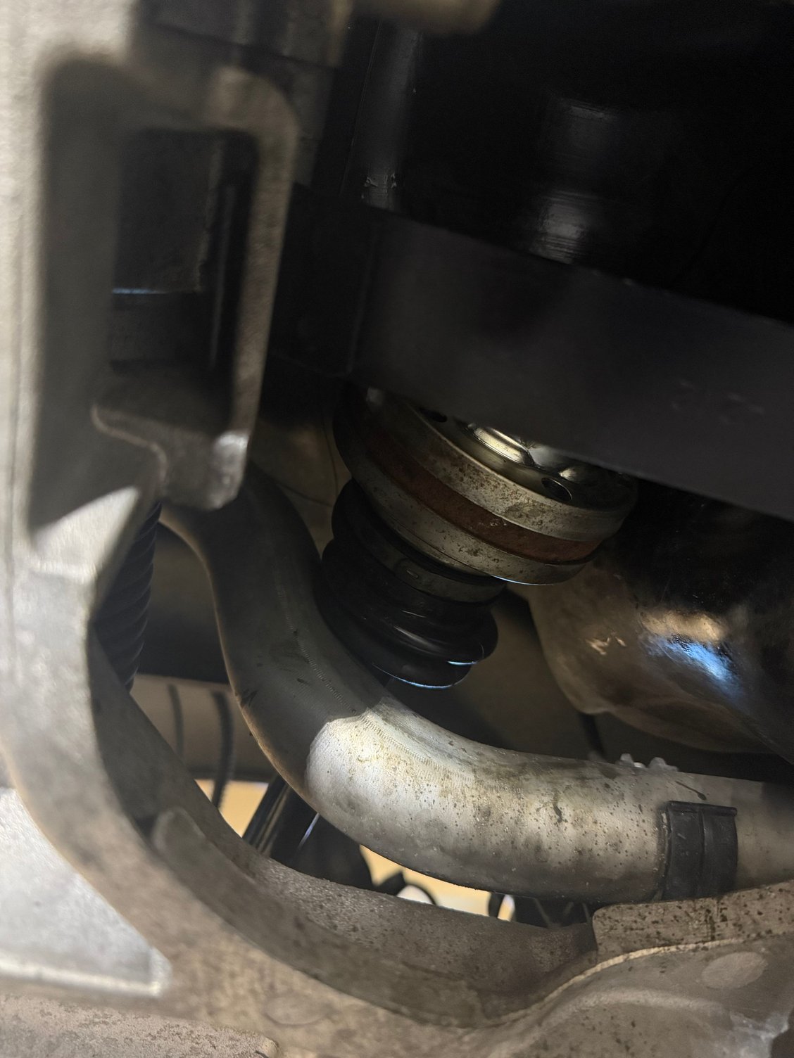

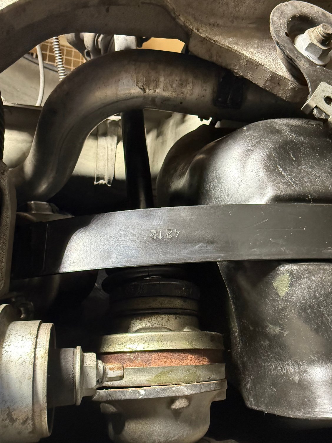

Don't see enough room here to slide inner CV joint past the coolant lines on both passenger and driver. Any suggestions before I move to dropping front final drive?
Thanks!
Did you ever figure out how to do this? I've seen others claim that simply disconnecting the lower ball joint and tie rod end allowed them to move the strut enough that they could maneuver the axle out.
Old May 5, 2026 | 12:57 AM
  #27
FJ4X420's Avatar
FJ4X420
Joined: Jan 2025
Posts: 75
Likes: 19
From: Big Bear, CA
I was able to sneak only one side out by that method.It can be done but you will be using a lot of force a second set of hands would be recommended because it will fight you. For the other side I ended up dropping the finial drive as per the service manual a few inches and it was a lot easier and would have saved me time if I did both sides this way. Always more than 1 way to skin a cat. Good luck!
