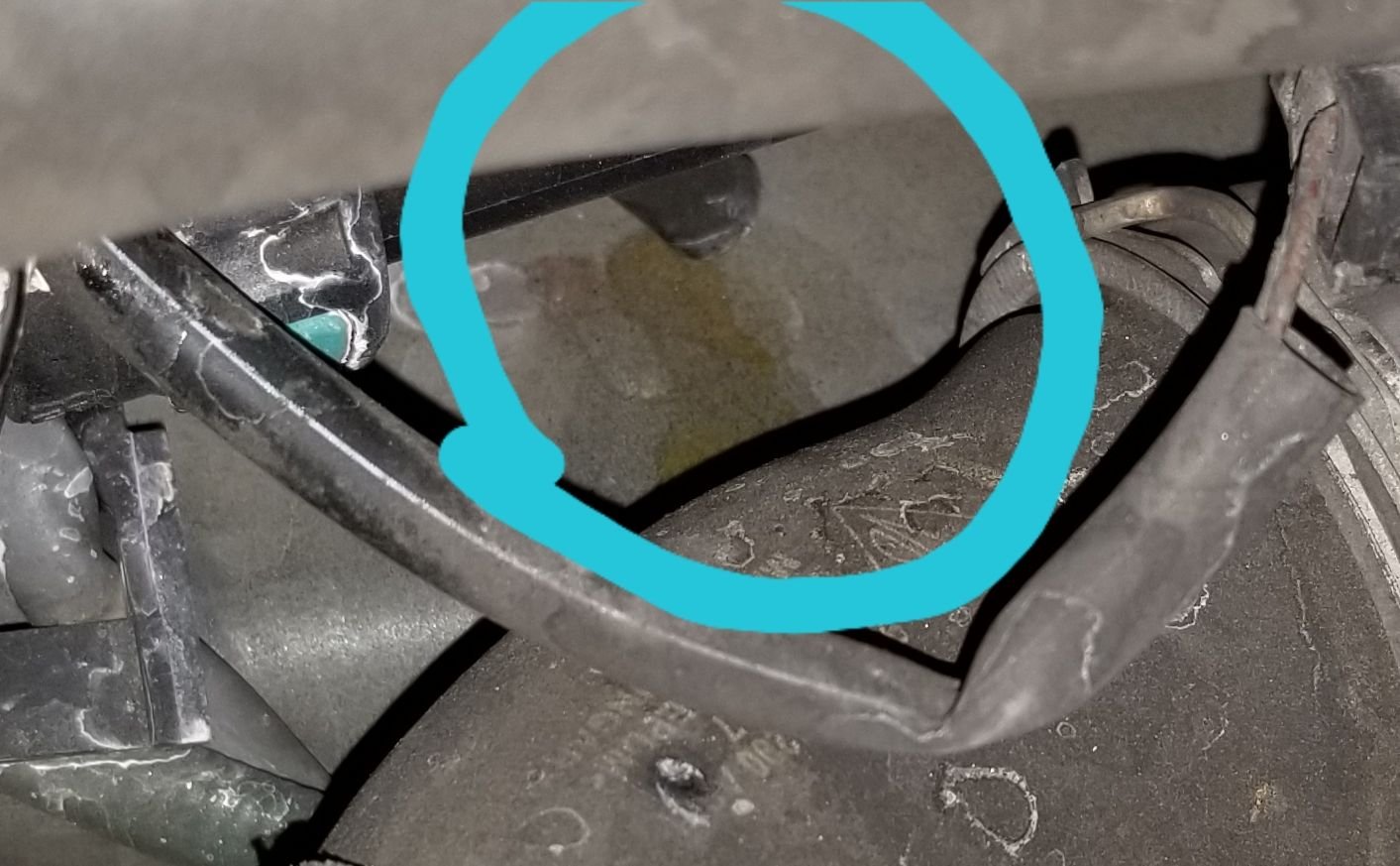

The front radiators are very clear i checked that right when i purchased the vehicle and initially cleaned it. I took the rear spoiler off and i can see the overflow drain hose is letting a little fluid out. See picture. This would lead me to believe that this is the source of the leak . Can someone check a 991.1 and confirm there is no chip/ notch there? If there is then i will replace the cap. If not i have to buy the overflow tank.

Maybe your car is overpressurizing the cooling system. What sensor controls that input? If you are saying that your overfill is consistently discharging coolant then this might be the issue.
You can buy a coolant vacuum system from a place like ECSTuning.com. You can pull a vacuum on the system. You will remove coolant and the discharge hose will almost create a wonderful coolant aerosol. Then you can use the same tool to pull coolant into the system.
There is a purge valve underneath somewhere that allow the system to purge air out but this should be closed. Maybe check to see if your is open for some reason. This would make sense since you are losing coolant and the car attempts to pressurize.
