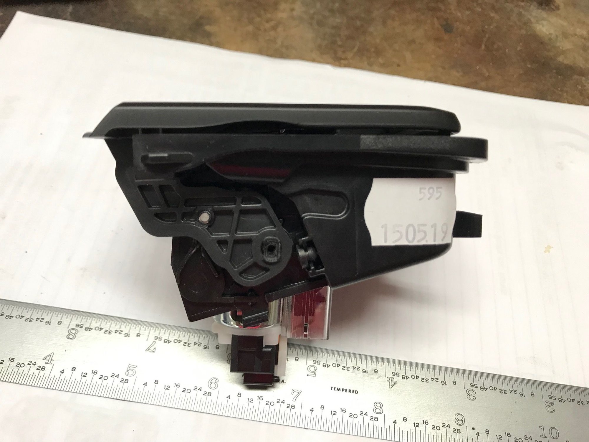

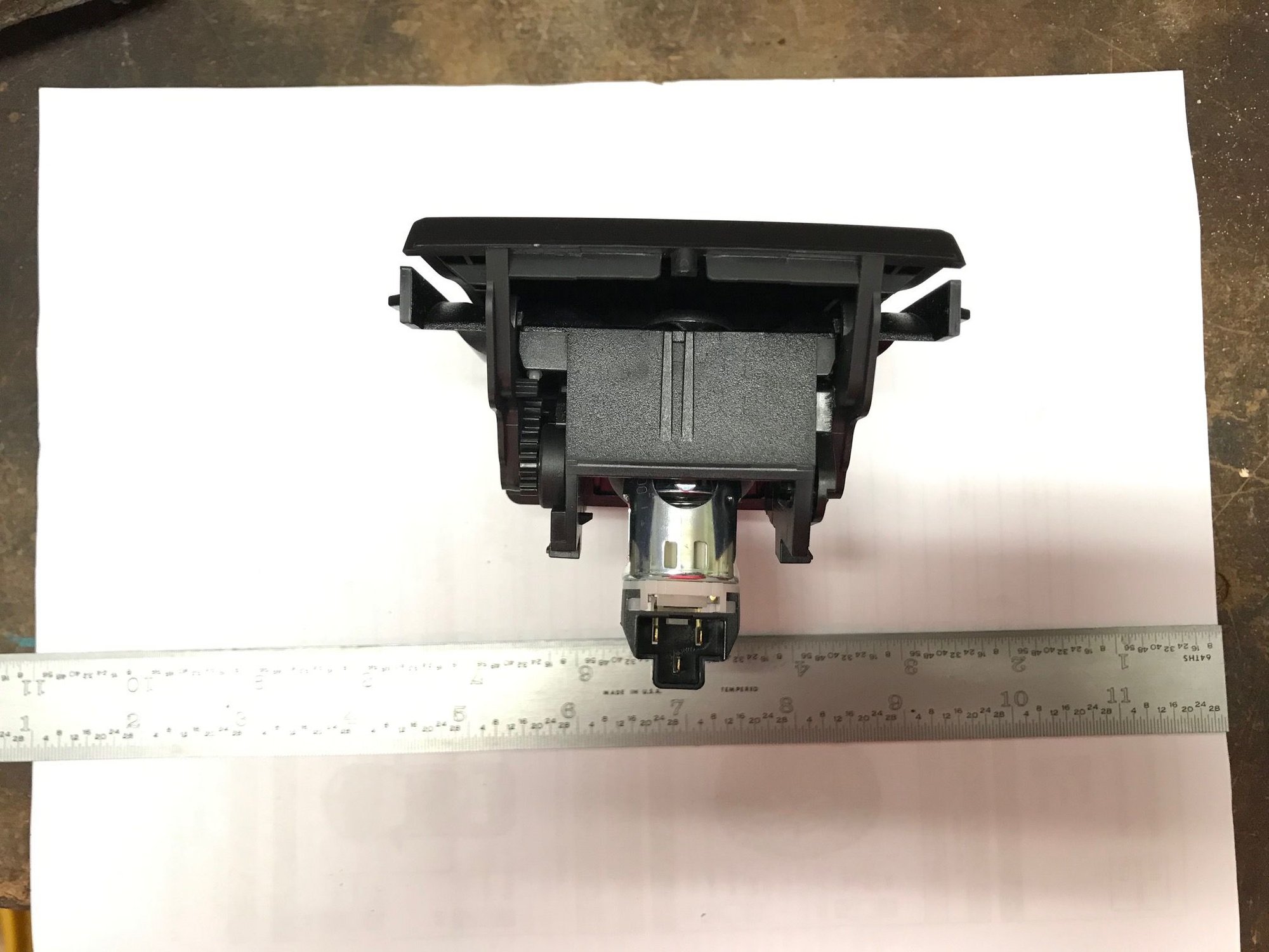

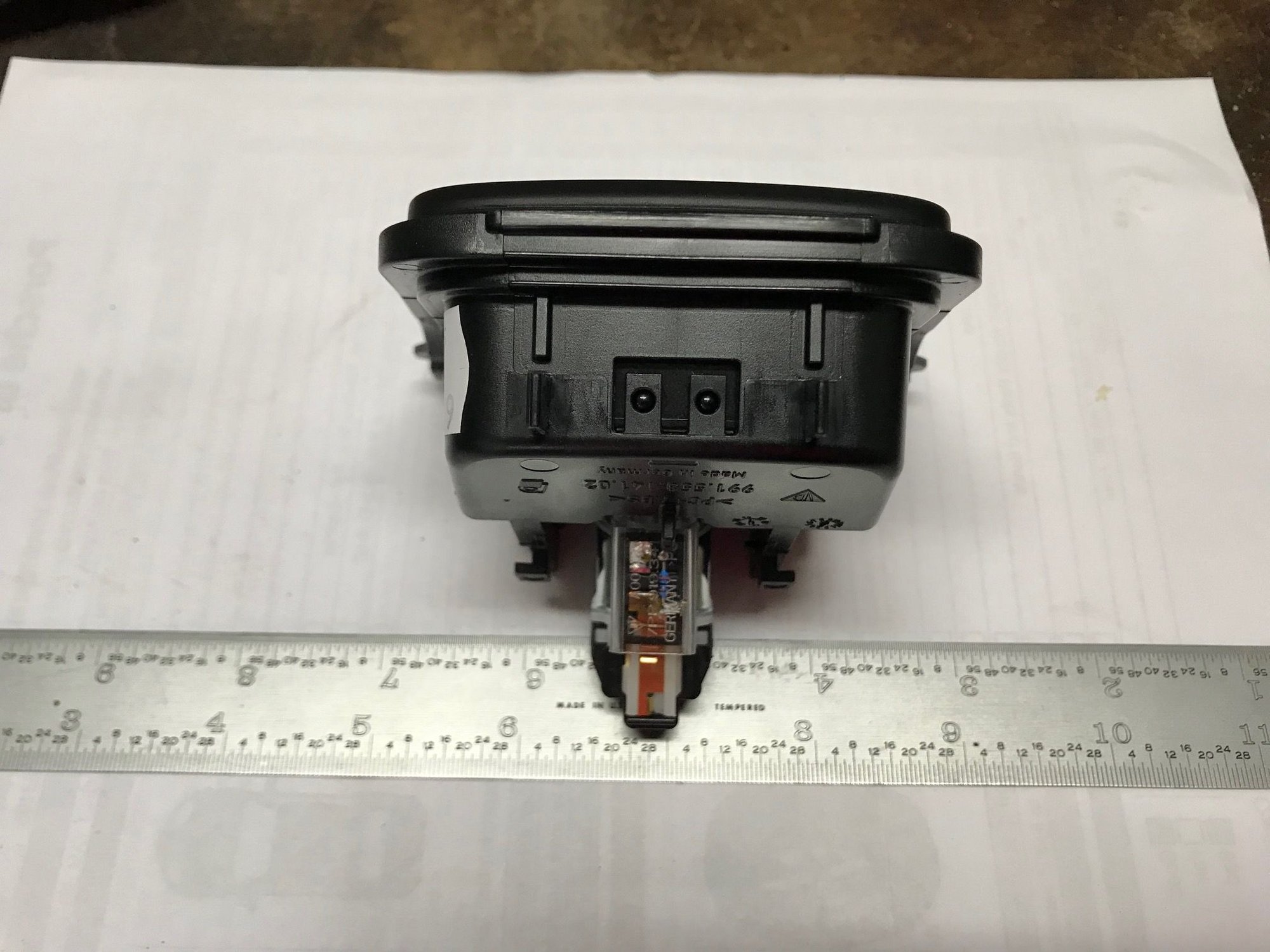

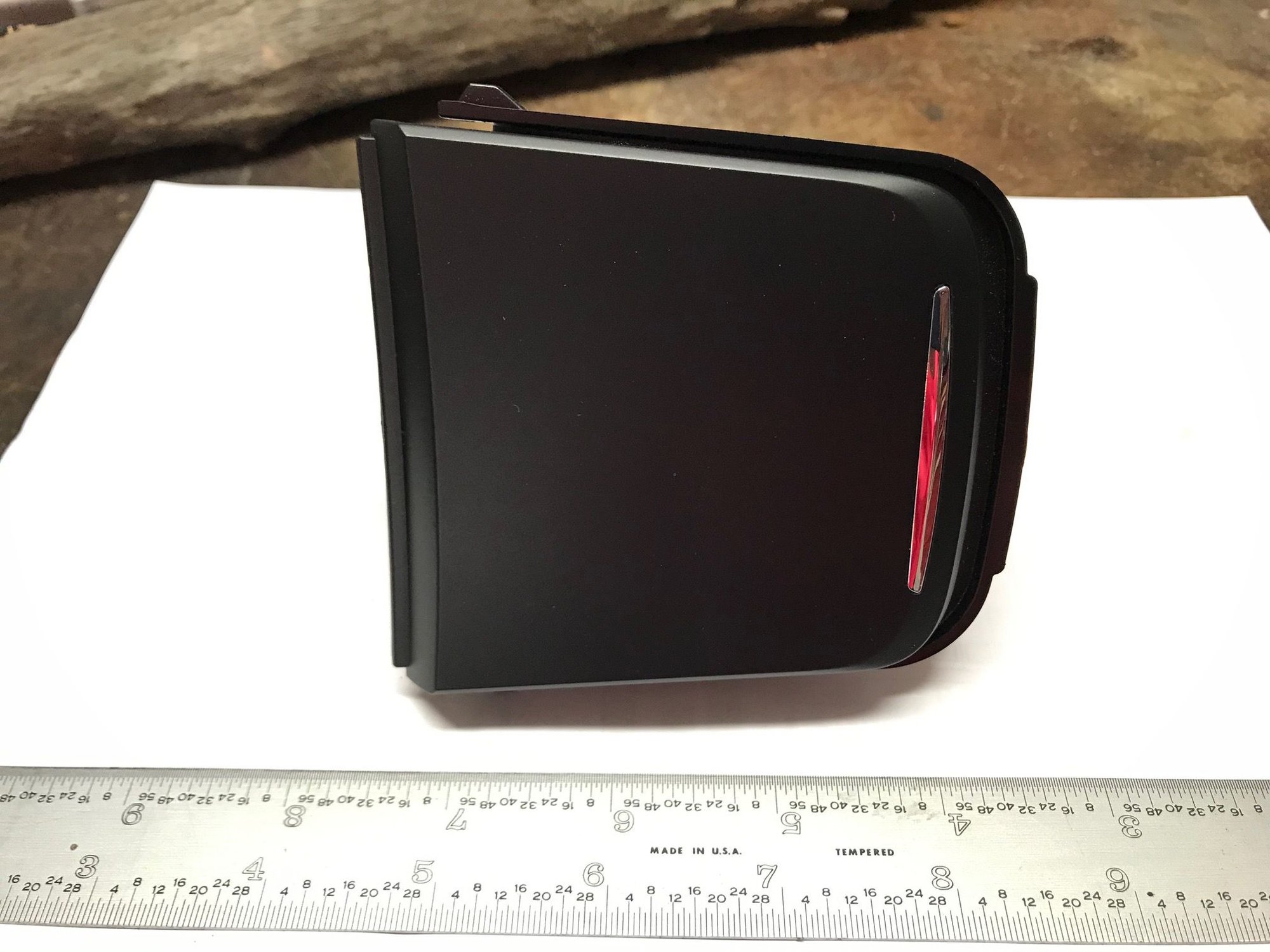

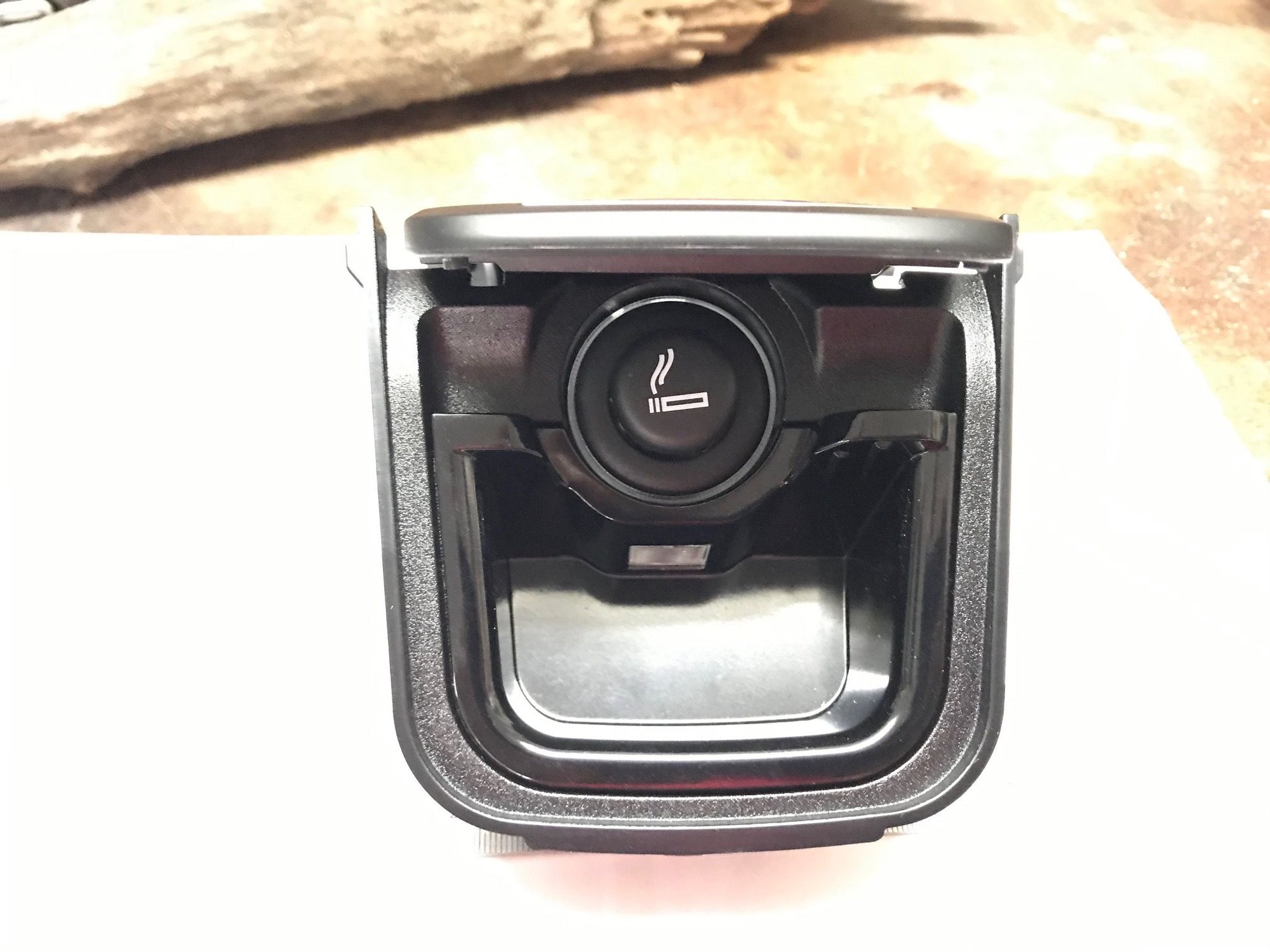

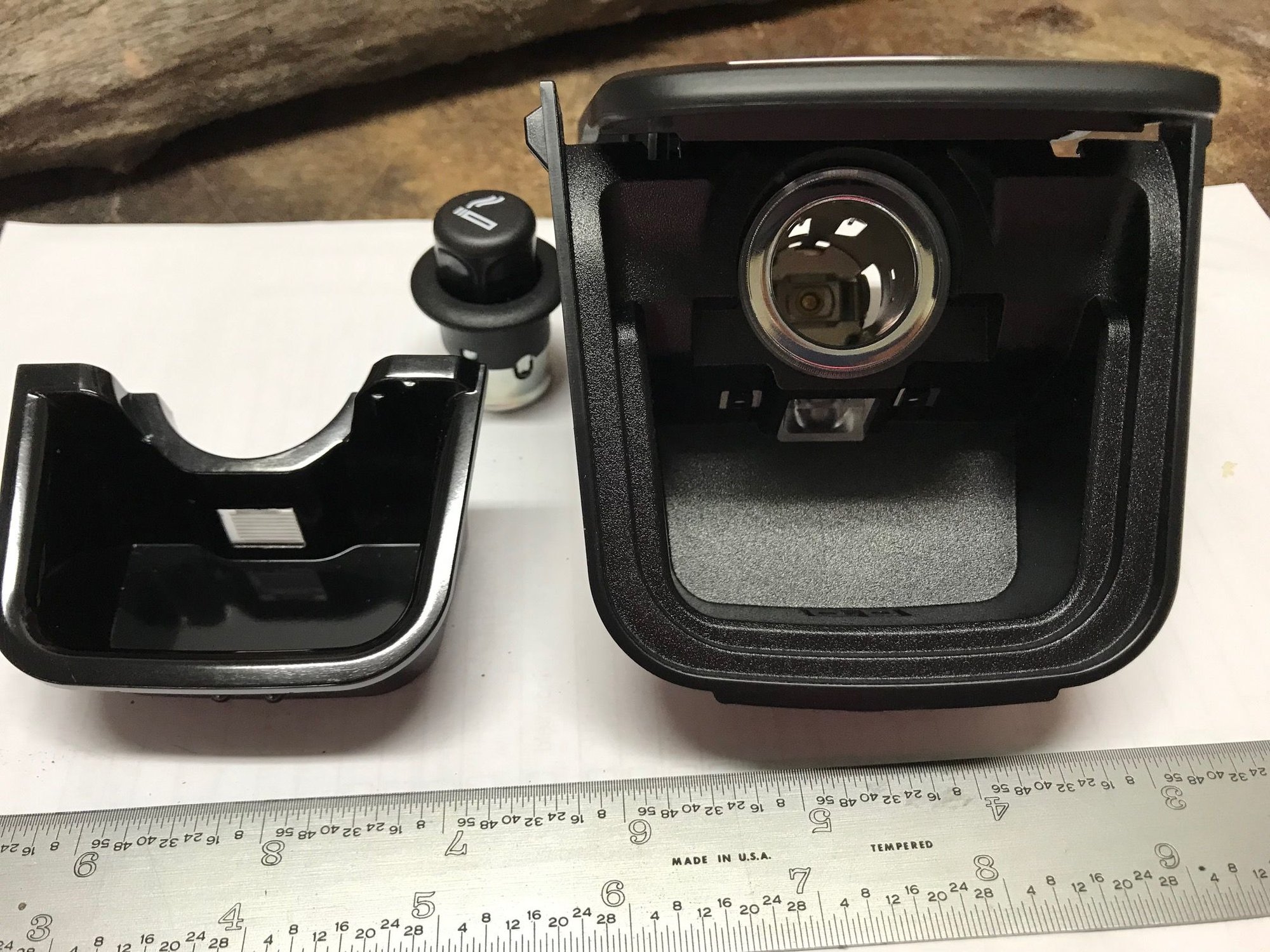

Mine just arrived from Suncoast. The $99 version for the 991.2 includes the cable harness to wire the lighter. I'll snap some pictures of all angles. It looks to me like it would need some major modification to drop in an insert, i.e., dremmel tool.

SP insert from Suncoast...

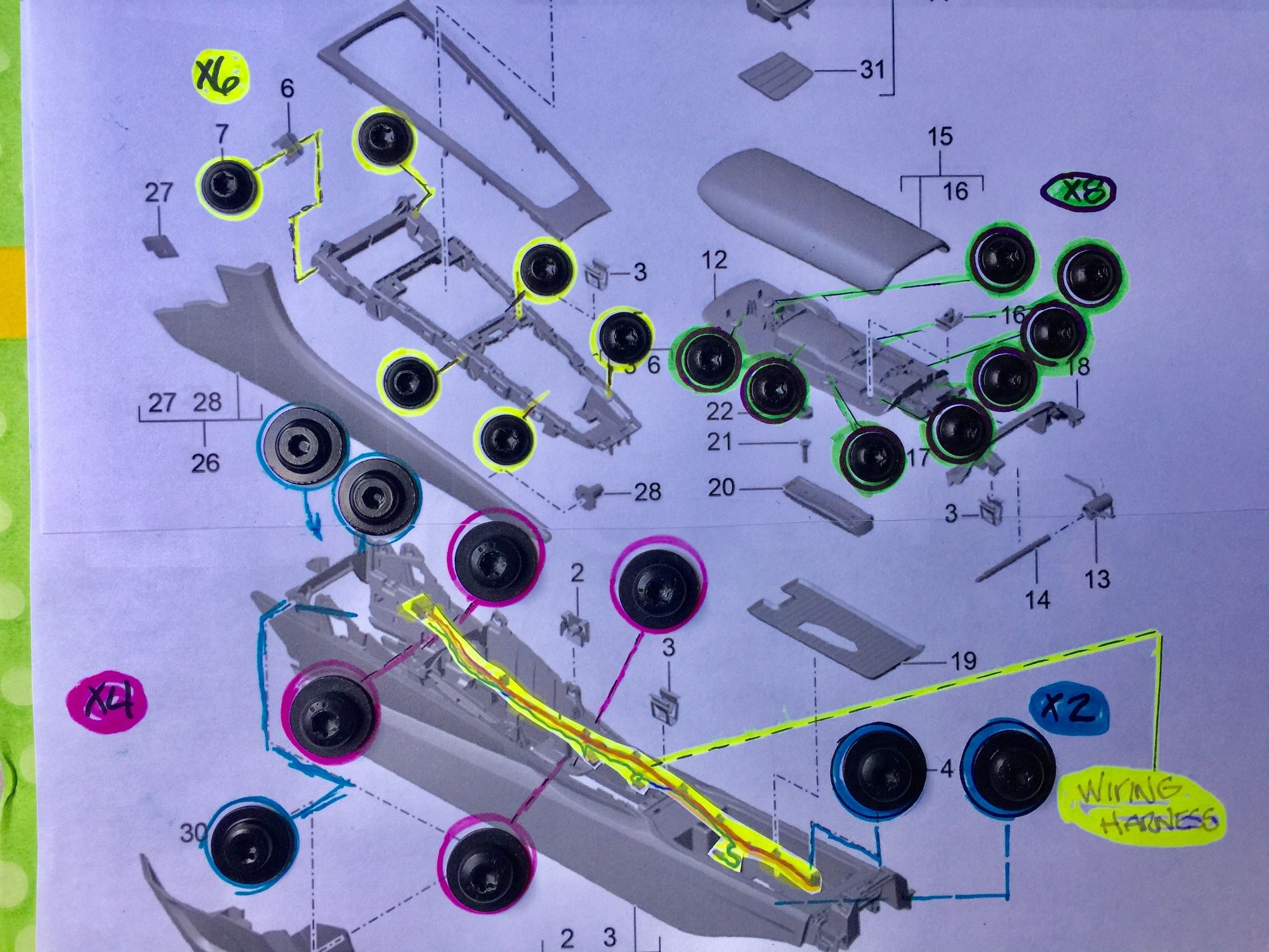

I replaced the coin holder with a smokers package January 2018 on my 991.1 because I didn’t like the hole in the center console. Here is a diagram I put together when I installed the smokers package. If you have questions just reach out to me.
BTW: Part # 1 which is the side frames and center railing stays intact and there is no need to remove it.
2014_Smokers Package - 991.1
Center Console Diagram
