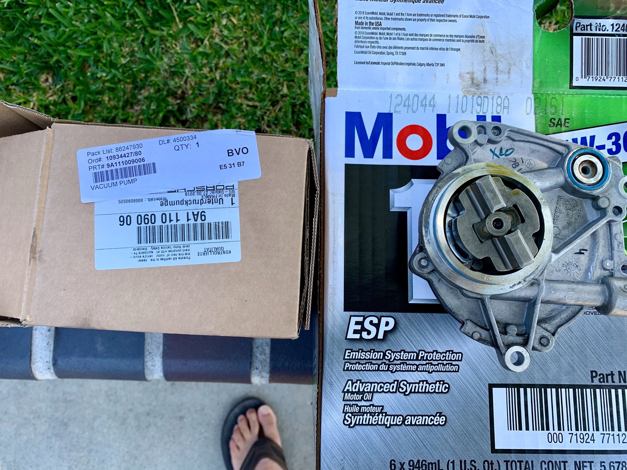

Originally Posted by BOPE
That's what it looks like to me, too.
You can see the same size opening on the right cylinder head, which interfaces with a vacuum pump that is driven by the camshaft. If you remove the vacuum pump or damage the o-ring, oil will seep/leak out. I suspect the same at the fuel pump interface.
Jason
You are correct, both units have o-rings. My vacuum pump failed several week ago. However, the vacuum pump is 1/10th the price or $200 compared to $2200. When your vacuum pump fails the MFD will display a “Coolant Failure.” Here is a picture of the back size of my pump.
Vacuum Pump.
