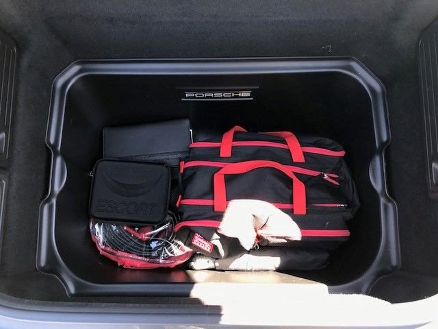

Stop-N-Go Plug Kit
Viair 12V Air Compressor (super powerful/fast)
Harbor Freight Compact Scissor Jack
Rennline Jack Pad
Wheel Carrier Bolt
Torque Wrench w/ 19mm Socket
Digital Tire Pressure Gauge
Several Pairs of Latex Gloves (keeps hands nice and clean....also can be used for medical emergencies)
All fits nicely in my frunk in a Griots Detailer's bag. I've had to use it once on the side of the road. The other two flats were slow leaks discovered in my garage. I still plugged them with my stop-n-go (but used full sized floor jack, impact wrench, etc), and then took the car to the dealer for new tire to be mounted once it was ordered and came in.
