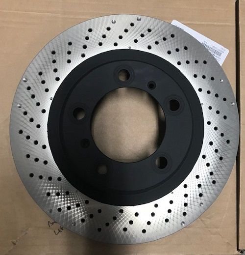

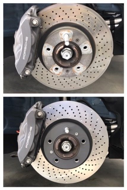

I did a full brake job on my 991.1 shortly after I bought it. I really only needed new pads (rotors had lots of life left on them), but I'm super-**** about how clean I keep my cars and the rotors were rusting on the hats (common for German cars) and instead of taking the time to refinishing the hats on the old rotors I just bought new ones and painted the hats flat black with high-temp paint before installing.

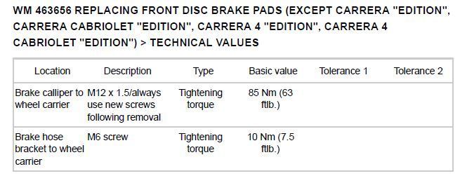

Mine were done by my local shop but I decided to do the next round.
Do you have a chart with torque figures to reassemble?

Here you go! Torques are based on the bolts used. Pretty sure mine were all M12 x 1.5, but the service manual I have shows the rears have M10 and require a lower torque. It's been a couple years so I don't remember exactly. I ordered all my parts through Suncoast and all replacement parts were exact. I just can't remember if there were two different size bolts.

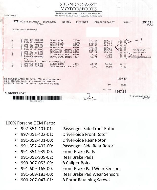

I dug up my receipt from my maintenance binder. Here's all the parts used for a base 2014 991. The bolts were all the same.

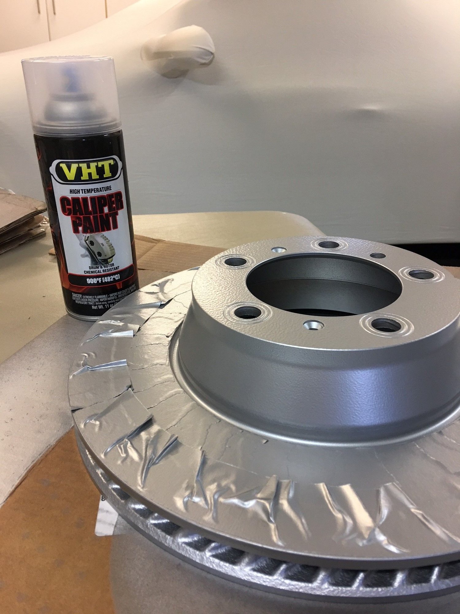

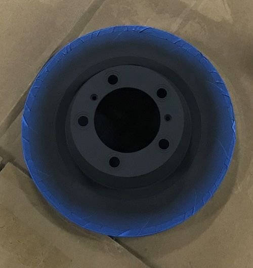

And do this to the new rotor (hats):

Oh yeah (I have dark wheels so I went with flat black)
