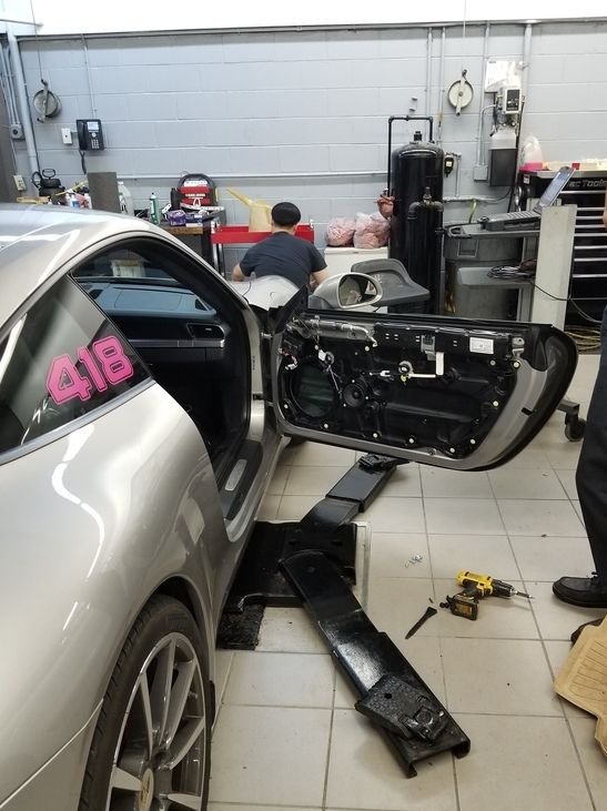

Definitely can be lubed to fix, had the same problem on both doors, each door card came off within 3 minutes and lubed, done.

You don't need to remove the door panels...
I had mine done at a dealer, supposedly this tech has heard this complaint quite a bit, I'll assume this is the best way to go about it based on his experiences
