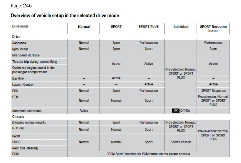

It is too bad "Individual" mode doesn't really let you be very individual: picking and choosing between those first seven items would let you customize your experience in much more detail.
It almost seems like someone decided "we need a dial on the steering wheel" but it looked silly with only three selections so they added one more that didn't really do much...
You can make "Individual" mode the exact same as either Normal or Sport or Sport Plus except you can totally customize it by deciding 1) which Dynamic Engine Mount setting you want and, 2) if you want Auto Start/Stop to be on or off. Wow.
My apologies for the sarcasm, I may have had too much coffee today.
From the manual: (note: 2017 Carrera manual - I am not sure if the Carrera T settings are any different)
