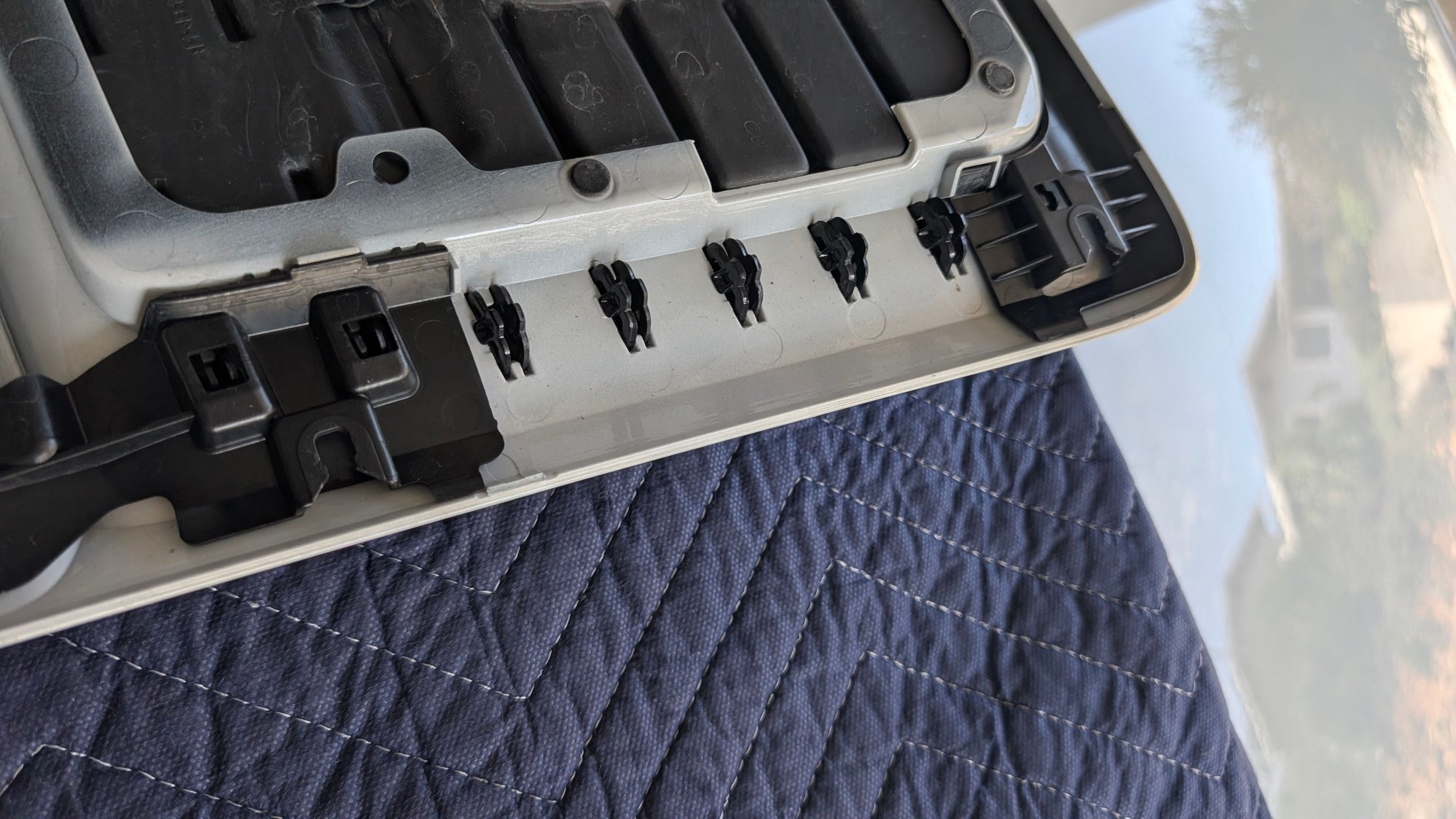

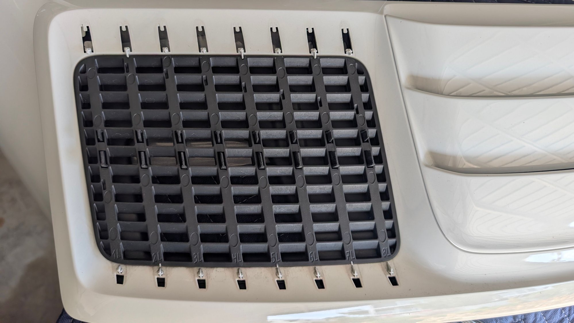

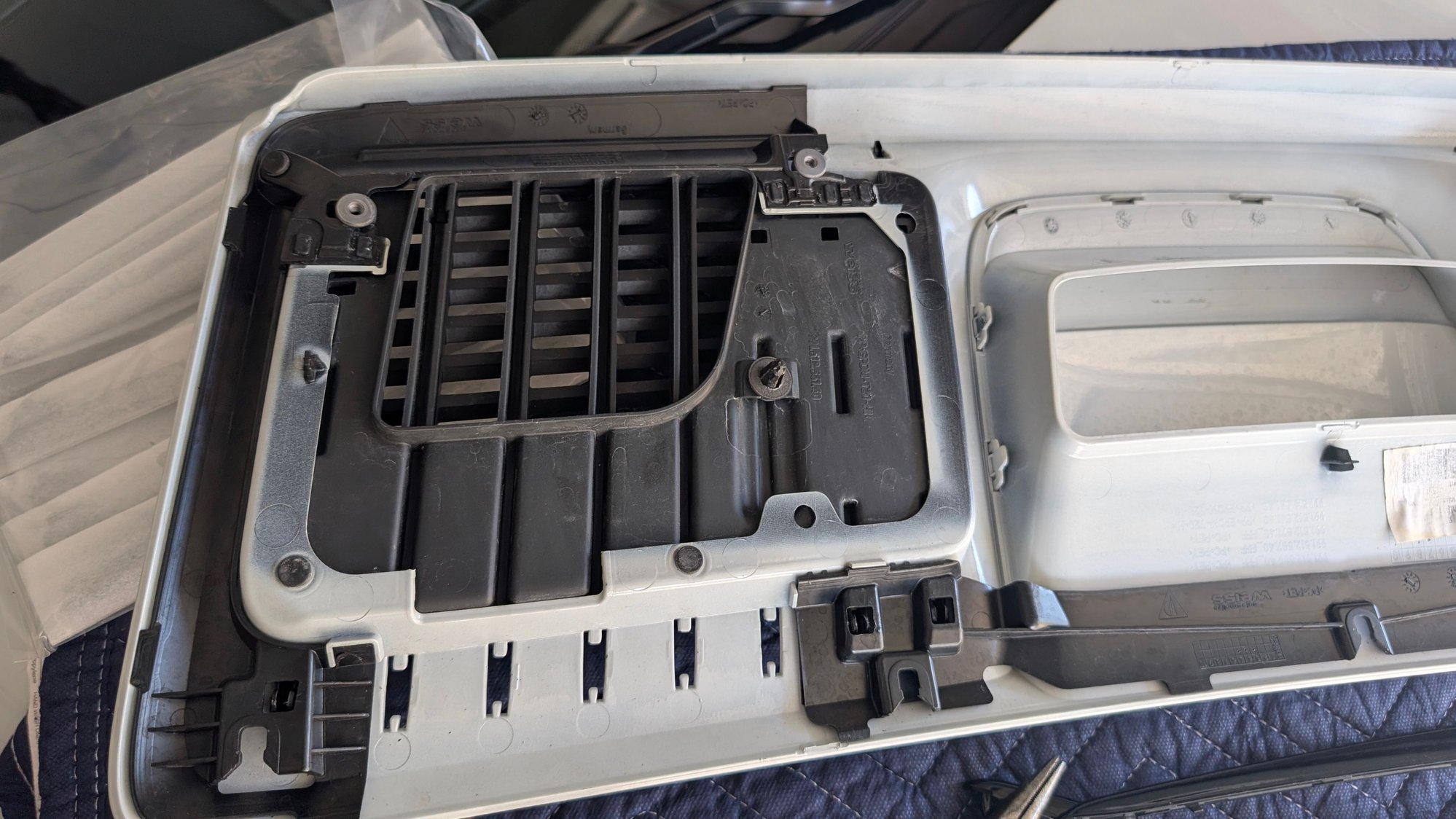

Ok..left side is done. I mistakenly thought that whole grid needed to come out to swap the fins out. Nope. The fins get pushed out from underneath, but like someone previously said.. you're gonna break the OEM plastic so consider those trash.
I'm gonna work on the right side and then figure out how to break the center.

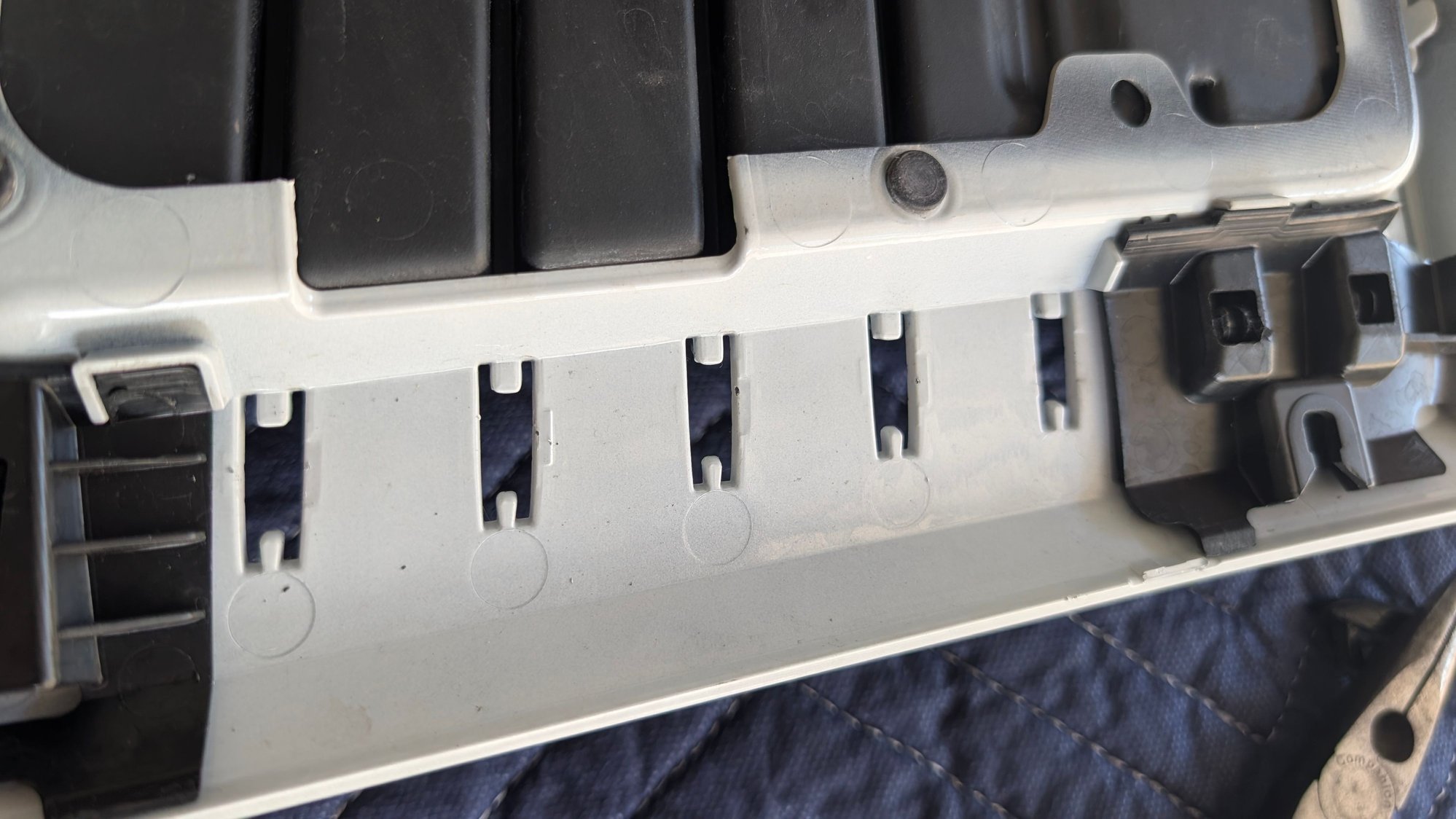

I don't see how the OEM parts are salvageable unless you have a special tool. I used a small needle nose pliers.
I tried to salvage the middle section but after the first clip disintegrated, I went full Godzilla on the rest of them.
