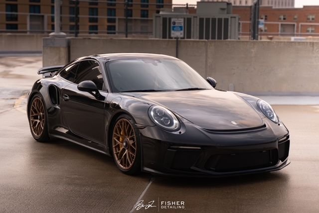

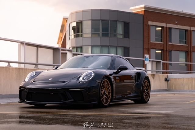

First weekend having it out and I attended two events on Sunday. The first was a Cars and Coffee in the morning and then an evening event that a friend of mine puts on. The car was a crowd pleaser and an absolute blast to drive! I love this thing, I did a quick cut/buff/polish on it and the paint glossed up really well.
I'll be dropping it off at my detailer this week and I decided to just go with standard clear PPF. I really like the gloss so opted to stick with that. Since I'm still planning to install the RS fenders and carbon hood this winter, we'll skip putting film on those areas now and I'll bring it back to him once I get those installed. He's really good about documenting the process on the cars he works on so I'll share some of those once I get them, I can't wait to see it after, he makes paint look new again.

Alright I've got some good, bad, weird, and kind of funny updates here. For the good, I had my car at the detailer for the last week+ and he installed Stek PPF on the front bumper, headlights, mirrors, and the one-piece A-pillars/roofline/rear quarters/lower rockers. It was quite a bit of effort to do those one-piece rear quarters and he really did a great job on it. I'll post a few photos at the bottom, if you're in my area of central IL and you're looking for a quality detailer, Fisher Detailing is the guy.
