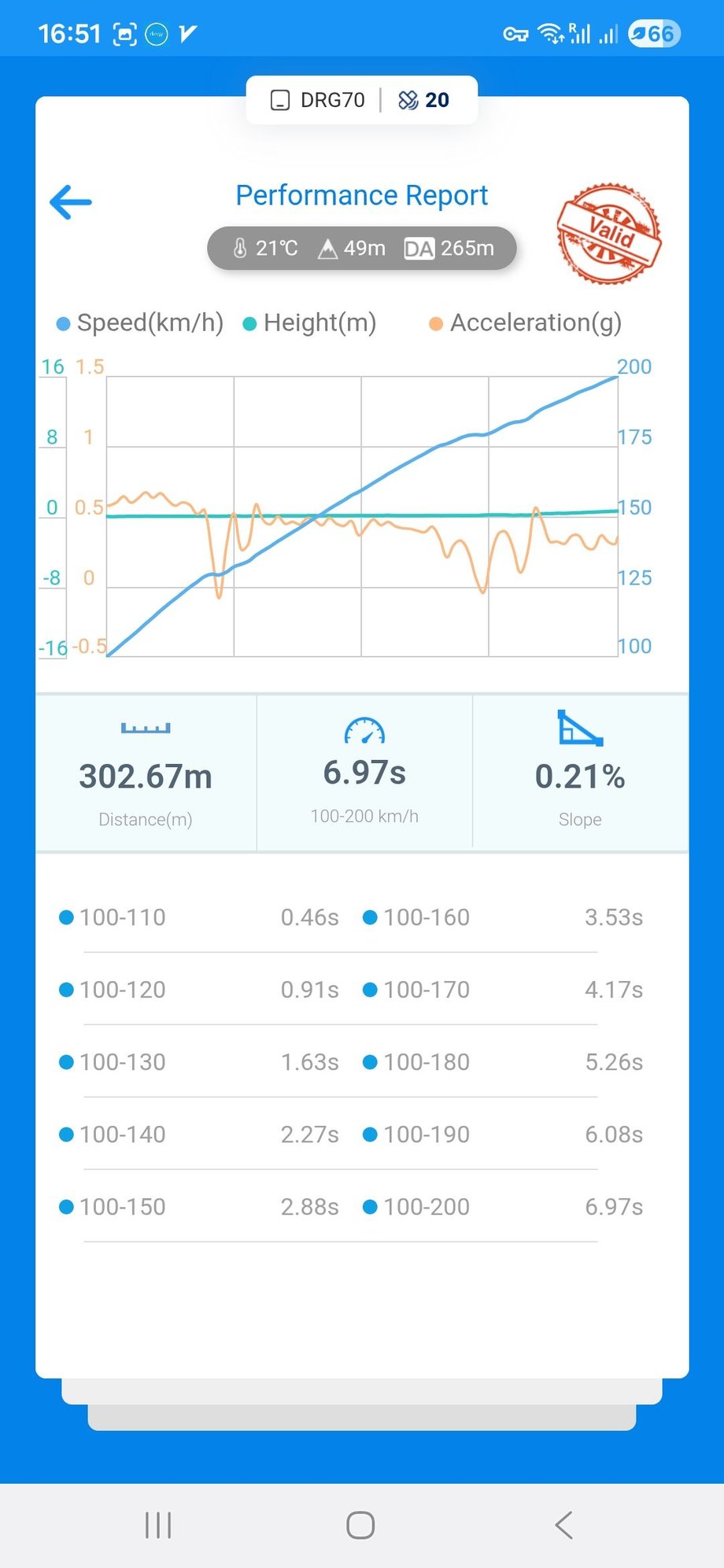

Where are you running those times? I mean altitude and ambient temp... makes all the difference in the world on NA engines.
Seems I was wrong and I did a 6.8 later with an insane - 2000DA, but it did a just under 7 once with a more reasonable +900ft DA.

Im in Florida (US) always warm or hot and humid LOL.
And the difference between our conditions must be insane. But what that time implies is, that GT3 will be neck and neck with my S2000 and I know for sure that wont happen. The car makes 500wtq and spins a bit at 60 if the tires arent hot. It did a 7.79 60-130 with full and pretty aggressive aero.
The next test I will have on Dundon canards and Verus Rear wing at 10 degrees. So that wont really help.
