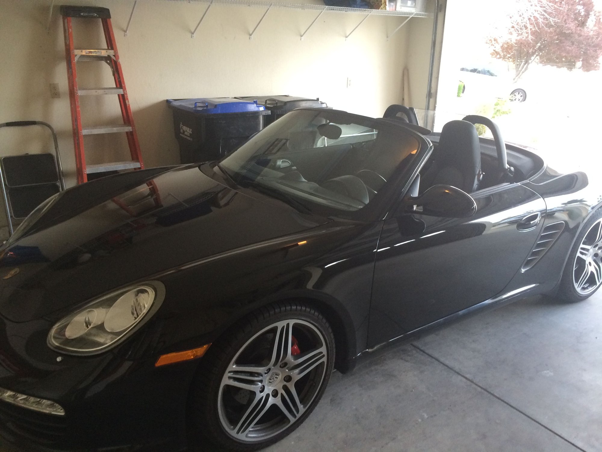

Search was for a 09-12 Boxster S MT with sport chrono, PASM, private seller as musts. Found a 2010 on AT with that in Sacramento-47K miles with 19's, bi-xenon, lsd, heated seats, 5mm spacers, Bose.
Had a buddy in Sac put eyes on it and with his OK set up a PPI at Niello--PO was taking it in for 40K service so Louie at Niello gave me a significant break on a very professional and thorough review of the car. Everything worked, readout showed only six ignitions range 2.
Bought car sight unseen $35.9K with PO paying for shipping to Las Vegas. Not a great deal, not a lousy deal. Showed up in great shape, put a new set of Pilot Super Sports on to replace the off-brand (Acceldera) that needed rears anyway.
Having a blast driving this car--the tranny is incredibly smooth and plenty of power. PSM was very intrusive until new tires put on-now only bothersome-a little more seat time and break in of the tires PSM going off I think.
One problem is intermittent starting-suspect clutch microswitch and have researched that and found a pic of it on top of clutch pedal but doesn't seem to be there on '09. Always starts but takes a few cranks on the clutch. Getting a "depress clutch" message. Any thoughts?
