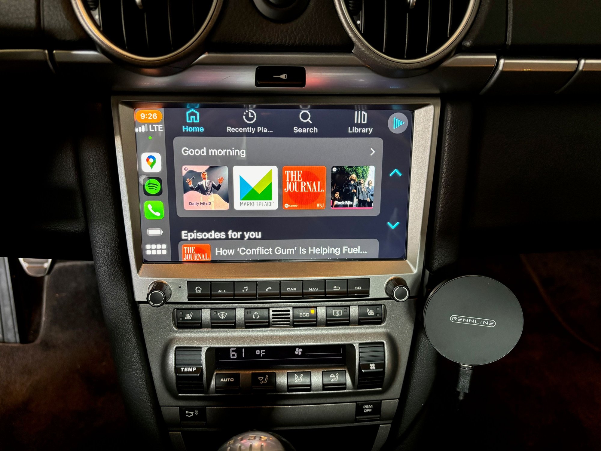

Here's the $140 Walmart unit in a 360 - best look and feel and night and day compared to the brand name aftermarket options.
Before - Becker radio, blends in nice with the interior
After install, $140 Power Acoustik Walmart unit
Driving with Android Auto connected

I recently installed the AliExpress head unit in my 987.1 (2007 Boxster S) with Bose. I ordered an 8GB RAM + 128 GB ROM unit with the MOST adapter for Bose; cost with tax was about $400. I ordered it from Sadocom Official Store on AliExperss, and the wiring harness came with the MOST adapter and the Canbus adapter already pre-wired in the wiring harness and it was completely "plug and play" into my existing vehicle wiring and I did not have to spice any wires for the basic head unit installation (I did have to splice wires for my back-up camera install). The silver color AliExpress head unit for my 987.1 was about a 95% color match (it is not a perfect color match). I have enough RAM/ROM that the unit turns on very quickly, and I've now got wireless Apple CarPlay, radio, USB-A (I use one of the USB-A connections for my Rennline magnetic phone mount that charges my iPhone), back-up camera, and the unit sounds great.
Since it sounds like your familiar with Android-based head units already, this AliExpress unit may be something worth trying out.

It's been up and operating in my Cayman for one year, and in that time I've had to reboot it twice - once as the GPS antenna wasn't being read (though this might have just been my navi app), and because I could not get the NHK TV app working without a reboot.
No rotary *****, but Volume Up and Down buttons (Skip and Home too) kinda meet the need.
Laggy and slow though it isn't, and the native audio apps are just great.
Twin Bluetooth channels, rear camera with god-view, OBD interface for proper tunnel tracking, TPMS integration, and a few other high-end attributes allow it to easy exceed the capabilities of the aged OEM navi.
