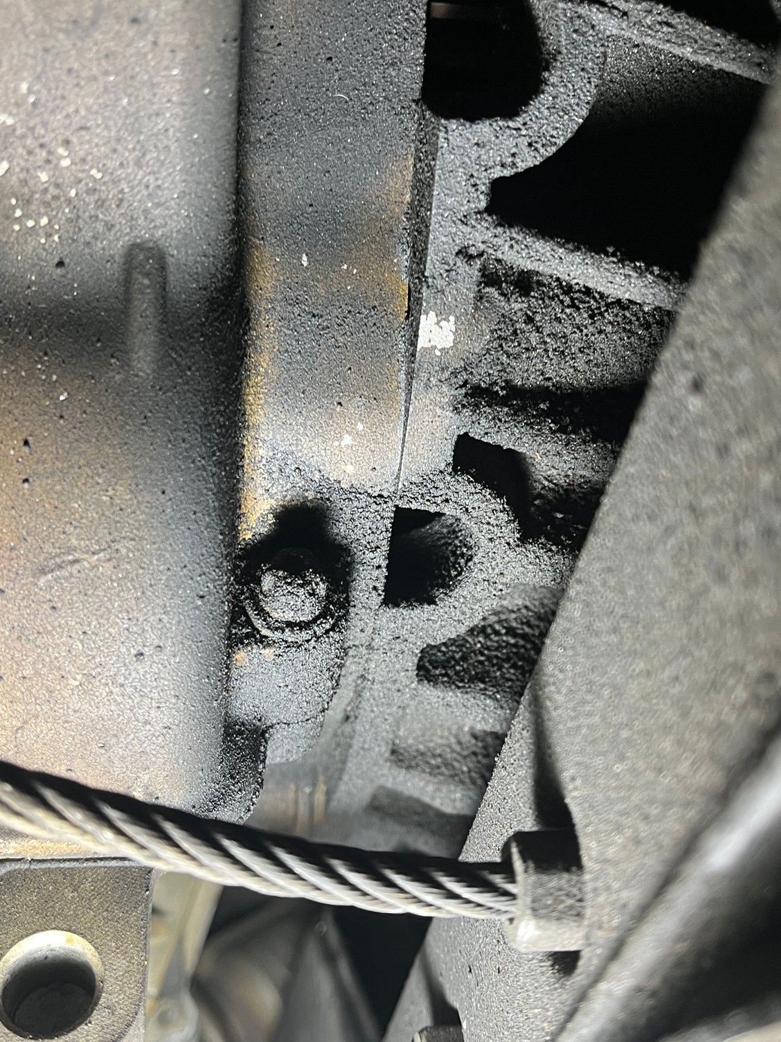

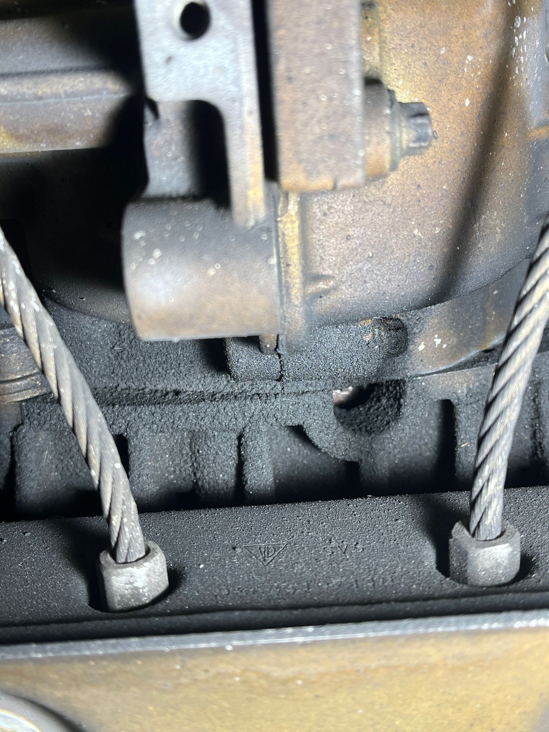

Hi, this is my first post. I recently bought a 2008 Cayman S with 60K miles. Bought it from an older gentleman, first owner, who had kept all records, and changed the oil frequently. He even had a report from a mechanic indicating that the bores had been scoped earlier this year, in preparation to sell the car. I took the car to a reputable independent shop this week to replace the shift cables and to take a look at the brakes. When they inspected the car they noted a rear main seal leak. Sent pictures which showed an area of accumulated oil and dirt. That leak is not of too much concern (yet), but they also said that if they were to replace the seal they could also replace the IMS flange seal with an upgraded one which would significantly reduce the chance of an IMS failure. I have read a fair amount on this and other forums about the IMS issue, and I understand it is uncommon in the 987.1. I was not aware of any upgraded seal. They were also suggesting replacing the clutch and possibly the flywheel depending on what condition it was in. They quoted $3200 if they were to do all of this. I would appreciate any input that would guide my next steps. Thanks!

Well, I couldn't have asked for information from a more authoritative source. Thank you very much. Part of me wants to wait another 10-15K miles or until the leak gets worse, just from the point of view of getting more life from the clutch and flywheel. Would that be associated with much more risk re: IMS bearing? Also could you please give me your thoughts on the PTFE seal mentioned by harveyf? Below are photos of the area around the leak in case that is helpful.
The fixing or not fixing oil leak will have little to do with the life of your original IMS bearing other than you obviously will want to get the grease seal off the bearing as soon as possible as that's the only thing that will extend the life of the bearing.
If it has been already been recommended to replace the rear main seal, it's for sure not going to get any better. For sure, the only rear main seal you want to use is the most current Genuine Porsche seal. Do not use any aftermarket seals:
https://lnengineering.com/products/rms.html
