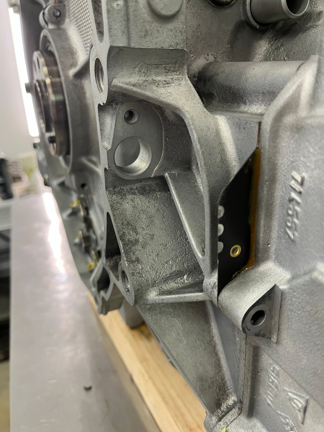

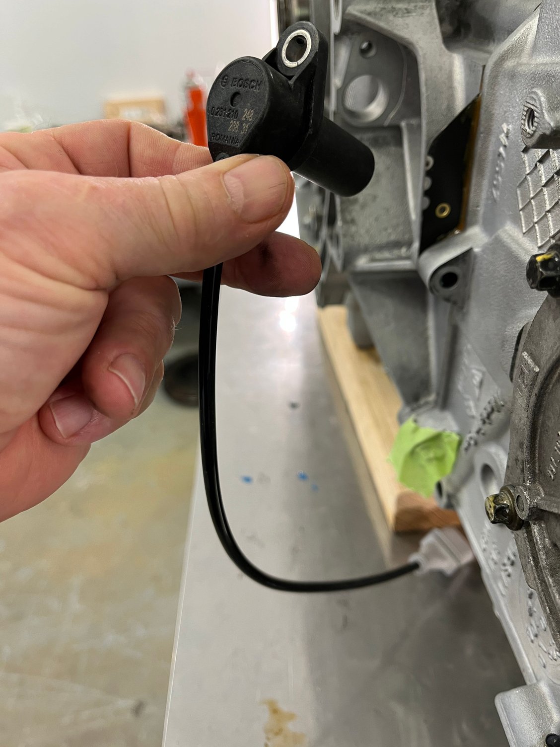

It is a Hall sensor that faces the teeth on your flywheel. If you are looking at the flywheel end of the engine, it is at the 3 o'clock position. Pictures below are taken of my engine, which is out for rebuild. I have no idea how hard it is to reach when it is in the car but you will most likely come in from below.

Harvey, thanks for the pictures! That verifies what I figured out last night. To reach from the bottom there are two coolant lines that prevent me from reaching it, I even had the wheel off. (I'm short so short arms) The manual I have says the connector is accessible from the top. Since I have to do all the work to get the roll bar off, I'm going to see if I can access it from up top. I'll also be replacing the AOS. I'll take the AOS off and then see what kind of access I have.
