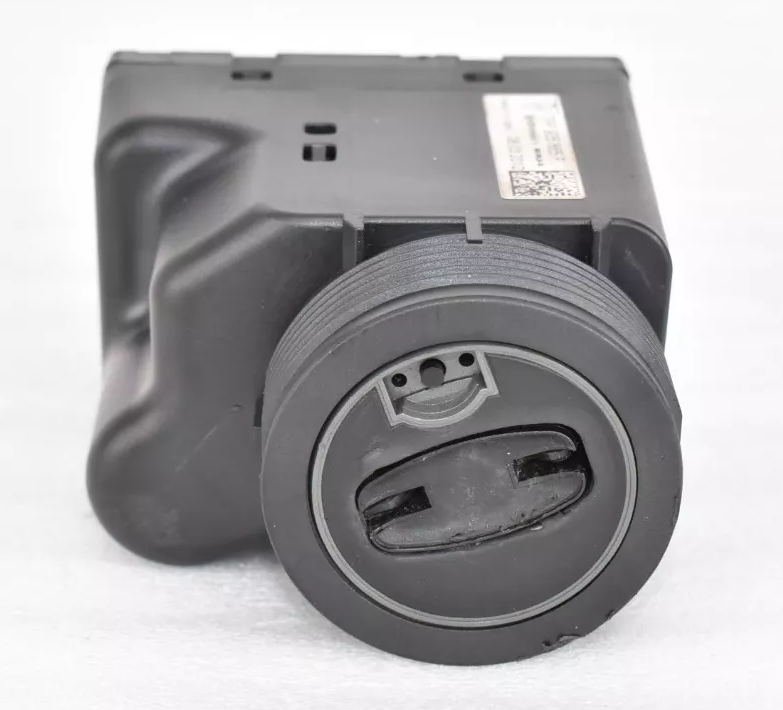

987.1 Cayman S 6-speed. 100k+ miles.
Sometimes (25% of the time) I put my key in the ignition switch and turn it and absolutely nothing happens. No click of the steering lock, no lights on the instrument pane, no cranking... nothing.
I turn the key back and on again and this time it works perfectly.
I've heard there are issues with failures on these ignition switches, but usually it's stiff, or not returning, or trapping the key. I have none of these problems, just this occasional 'no-fire'.
Any help would be much appreciated.

It may be your clutch switch. This is the same problem I started having last summer. I know it sounds odd, but yes, turning off the key, back on, maybe a few times, got it to start.
I actually jumpered the socket with a male-male spade-terminal cable about 2" long. That fixed it, it was the switch. I have a new one coming and will install it when the car comes out of hibernation in a few weeks.
You can get at this switch and socket pretty easy. look under the dash above the clutch. You could jumper this easily to test it

Sounds like you need to replace the ignition module. It's an easy repair. There is a wire tie inside the knee panel that you will have to cut to release the wiring. Otherwise it's not difficult. Undo the trim ring at the key switch then unscrew the retaining plastic nut, cut the wire tie and follow the wiring to the connector. Reverse to complete the work. When I did mine I found that jiggling the key would get the car started and that pointed me to the switch module. Good luck

Gotta say that "easy repair" is an understatement. I can't remember the last time any repair took me this little amount of time. Switch is a bit expensive (for what it is) but I think I was inconvenienced a grand total of 30 mins. It cured not only my intermittent starting problems, but also a condition where my car would repeatedly start and stall.

Sure, here you go: 997-618-159-07 I paid $283 from my local dealership which was actually the cheapest I could find. Two things... if you stick a key into the new part and turn it, expect to have to pry the little plastic piece off the front and hit the release to get your key back. Second, no need to reprogram or rekey anything. The switch fits any key of our type, and the brains of the operation is not the switch, its the PAS computer.
Removal:
Pretty sure the connector popped right off, the experience was not memorable. There is probably a release on the connector.
Installation:
I used a long piece of tape, taped to both sides of the ignition switch to be able to pull the switch up near the hole&connector while I reached up from the bottom and snapped the connector back together one-handed.
