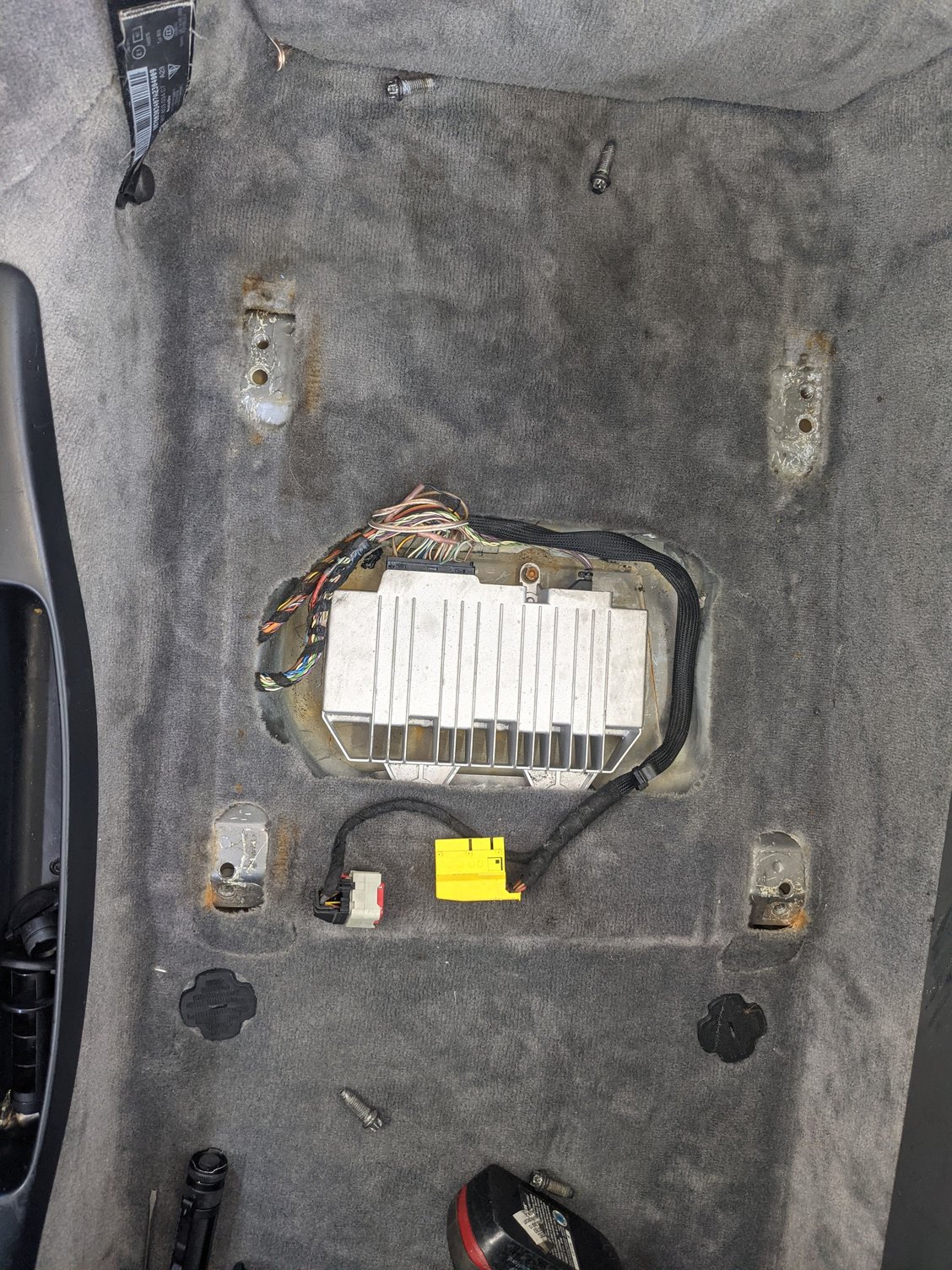

Thats correct, my 2009 has the non BOSE with PSP package and
ASK amp under passenger seat, powering the 7 speaker front only system. Still trying to figure out how to add the rear channels to that since i have wired up speakers in the factory spots. 2007/08 should have the amp in frunk for same system.
