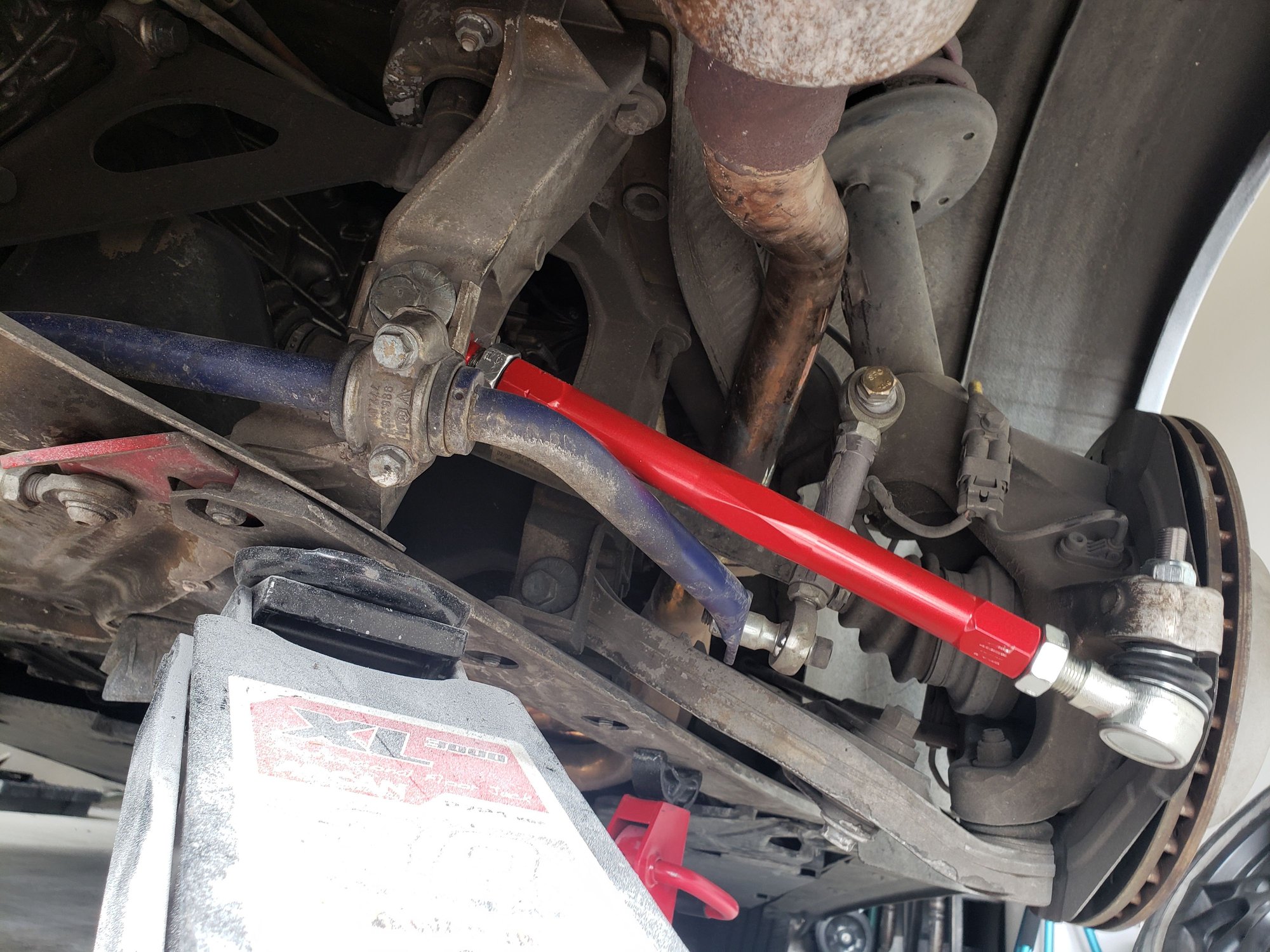

So, i'm coming up to getting coilovers in the next 1-4 months. car has plenty of mods rear and front
adjustable toe arms
hr rear sway
rss adjustble end links
vogtland springs 1.2"
chassis sifftening (frunk and trunk)
However, with almost 110K miles on the stock shocks, i am thinking about getting them replaced with coilovers.
My list goes below, but i do want to stay in the 1000-1300 range. I need to get new ties, and i assume an alignment is needed again.
BC coilovers
megan racing
biltstein (low bc of cost)
wheel spacers
What is your input? have you used any of the three brands. Ease of installation? I'm not a heavy track user, but i love a few spirited rides with turns.
below is a picture of my rear mods for suspension

Haven't tried them but have read some good things about Redline Coilovers. Who's rear toe links are those?
Disregard! Can't seem to find them right now

The adjustable links are godspeed,, the end links are RSS, sway bar is H&R. I was cautious with the adjustables, but the porsche dealership had no issue adjusting them with my alignment. Also, those things feel like the RSS end links. Super solid.
Thanks Jesse, nice choices! Those toe links look very solid and are priced a bit better than most of the machined ones.
