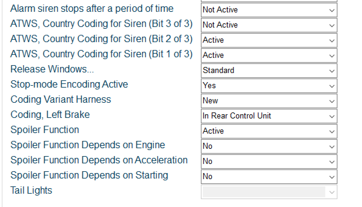

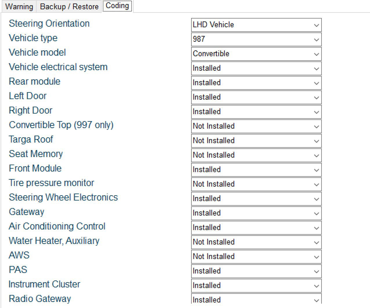

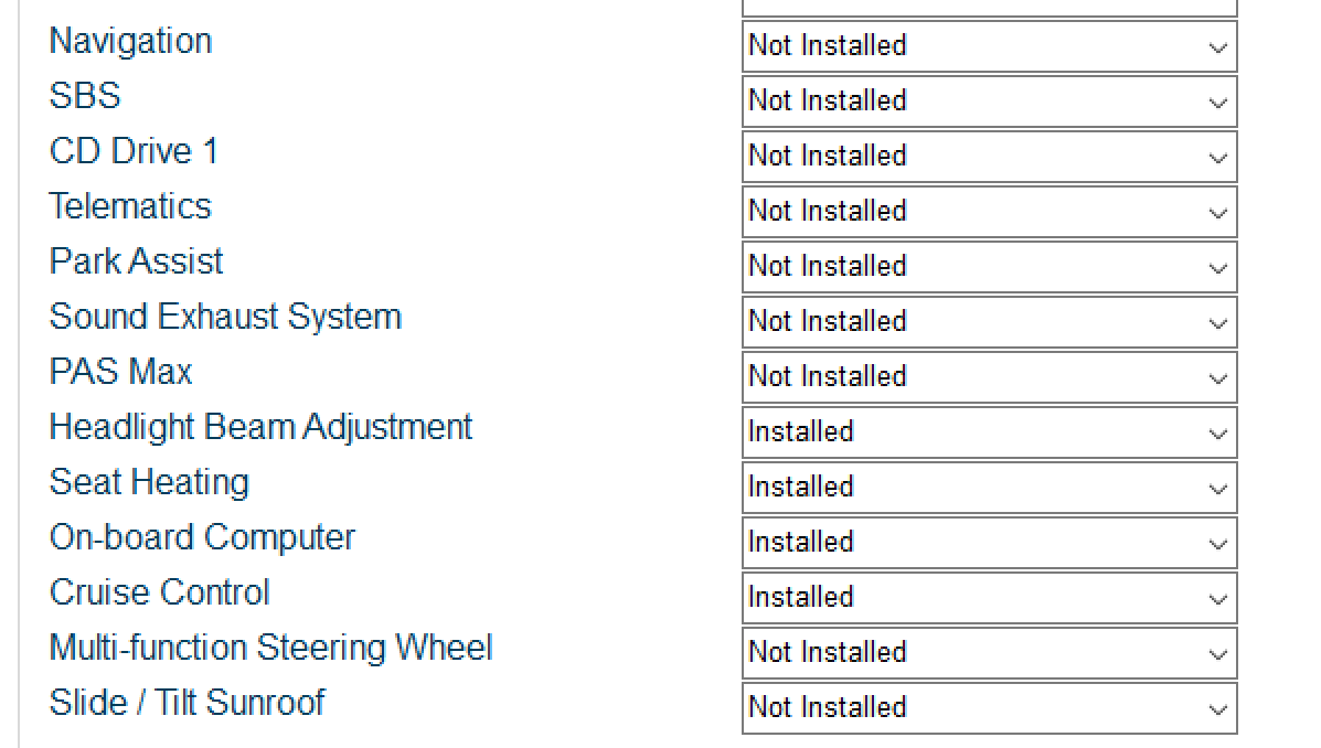

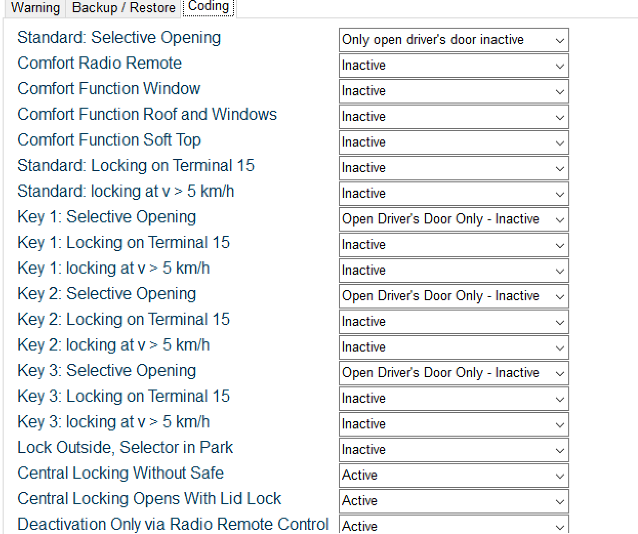

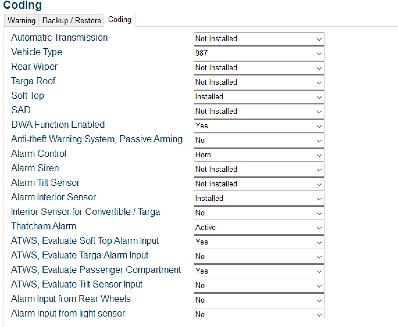

For those curious, I took the liberty of renting a Durametric Professional version which allows the coding of the computer modules. I specifically needed this to code the rear body control module as this was replaced in my new to me Boxster by the former owner without programming it. I have not seen much documentation on what feature sets can be coded through their tool so figured I would post it here. Beyond what's available through the user interface, apparently you can do some custom coding, provided you understand what bits you are flipping. Obviously you want to be very careful here and take backups of the original coding. See pictures attached which code the 3 modules(Rear, Front and Gateway Control Modules) in my 2005 Porsche Boxster.
Rear Body Control Module 1
Rear Body Control Module 2
Front Body Control Module 1
Front Body Control Module 2
Gateway Control Module 1
Gateway Control Module 2
Gateway Control Module 3

The table of various adjustments posted by jferguson6 is very timely in my case. I have just installed a Mr12v (Dension clone) device in my 987.1 Bose audio circuit. My Boxster S did not include a CD Changer and the Mr12v that mimics a CD Changer is currently not recognized. However, the manufacture of the Mr12v suggests that the vehicle must be re-coded in some cases. In reviewing your table, I note that in Gateway Control Module 1 there is an option to change "CD Changer 1" from "Not Installed' to "Installed". Your information provides me to a way to explain this to my Porsche technician in some intelligent manner so he understand what I am asking him to do.
When using the Durametric coding device, can one go directly to the the Gateway Control Module 1 and scroll down to "CD Changer 1" without having to go though the other modules (such as the Rear Body Control Module, etc.)? Since I am paying for this by the hour, I am hoping to keep labor charges to a minimum. Once again thank you jferguson6 for a very useful posting.

As far as I know the durametric menu and wording are exclusive to the durametric and not necessarily identical to the Porsche PIWIS menu used at the dealership. Of course I am not 100% certain since I never used a PIWIS.
And yes you can navigate to just the settings for the gateway control module and change the selection on the drop down. Those are actual screenshots from the durametric so what you see there is what you would see if you installed the software.
