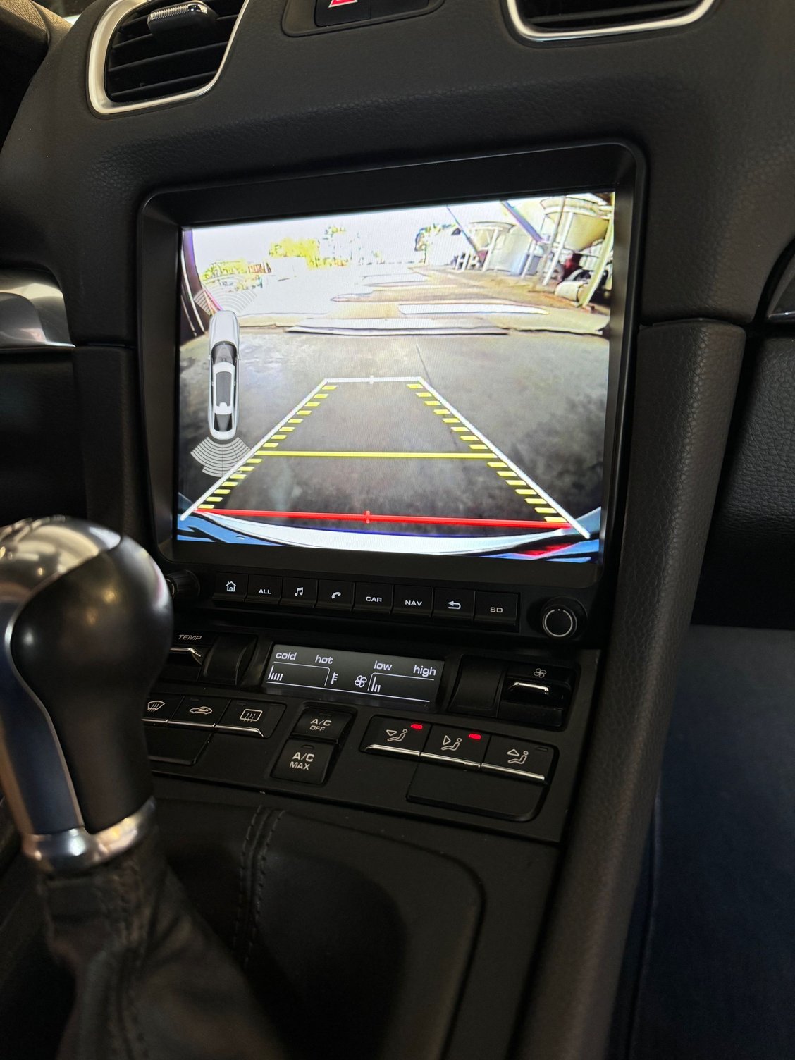

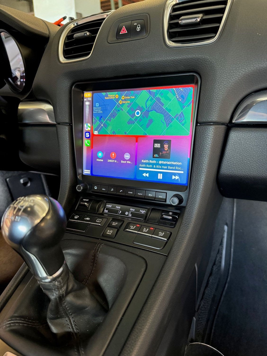

-Another option is to replace the HU with an Android unit. There is a huge thread on the 991 forums about that and the members on there created an install manual and will help with any troubles you may have. This is the way that I went. I got the CHSTEK unit and am very happy with it. The screen is large and I looks good in the car.

This is my CHSTEK unit.
Reverse camera with parking sensor overlay.
