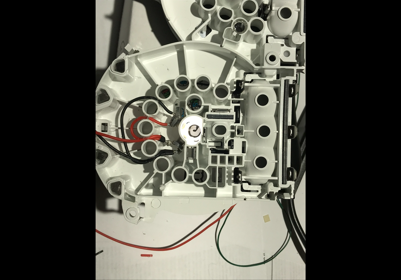

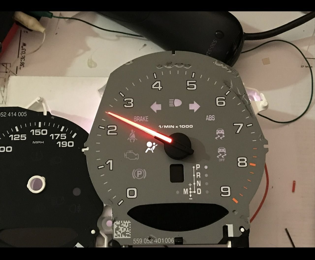

I don’t recommend my cure for only lightning the tach needle (fairly labor intensive), but I had what I suspected a bad circuit board in my instrument cluster that did not allow the tach needle to illuminate even with the headlights on. The 981 CS was new to me and before I purchased my PIWIS2 and was unfamiliar with Porsche repairs. The dealership told me that the cluster was not serviceable as far as LED’s and wanted $4000 for a new cluster plus labor to install and program. I decided to disassemble the cluster to see if the LED’s were replaceable and discovered that there were 2 LED’s to illuminate the tach needle (both did not illuminate) and did not appear to be replaceable to me. So I went old school and purchased 2 small (NEO3-WPH) 9-14.8 VDC LED bulbs and drilled and glued the LED’s into the plastic “tunnel” that illuminates the tach needle. I soldered 22ga wire and connected it to the dimmable light ring that illuminates the ignition key. This $20 repair not only repaired my defective cluster but had the benefit of having an always fully illuminated tach needle even when the headlights are off. I later used PIWIS to code the cluster to be backlit full time. The two LED’s I installed are dimmable with the cluster **** but are even brighter than the OEM LED’s so the tach needle is VERY easy to see even in bright daylight with sunglasses 😎. This also would have been a good time to change the gauge face color if I would have thought of it in advance of my repair.
Jim
Added and glued two LED’s in drilled holes in tunnel
Bench test of new LED’s

Great solution, love it!
