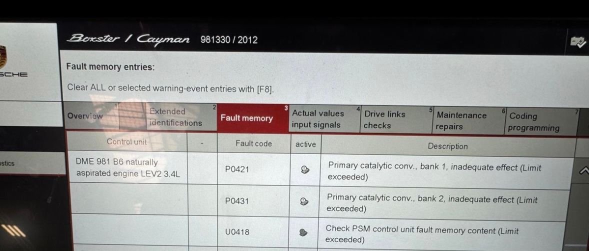

Default Any luck fixing this?
like the title says, anyone fixed this?
I have the catted top gear headers on, initially no codes after installing. After about two months I started getting this code sporadically and now it’s every time I start the car. No o2 spacers on the car either. I never got a CEL before on the car either.
The shop tells me that the cat could be failing. Which is unfortunate since I had the headers on the car for less than a year and I never track it and it’s street driving only.

P0421 is post cat code, very common CEL on aftermarket headers with lower cell cats (for more flow) or de-cat headers but no effect on car's performance. O2 spacers are hit and miss.
That’s what I was thinking but there were no codes initially for a good two month period of solid driving. What’s causing this to come out of the blue?
