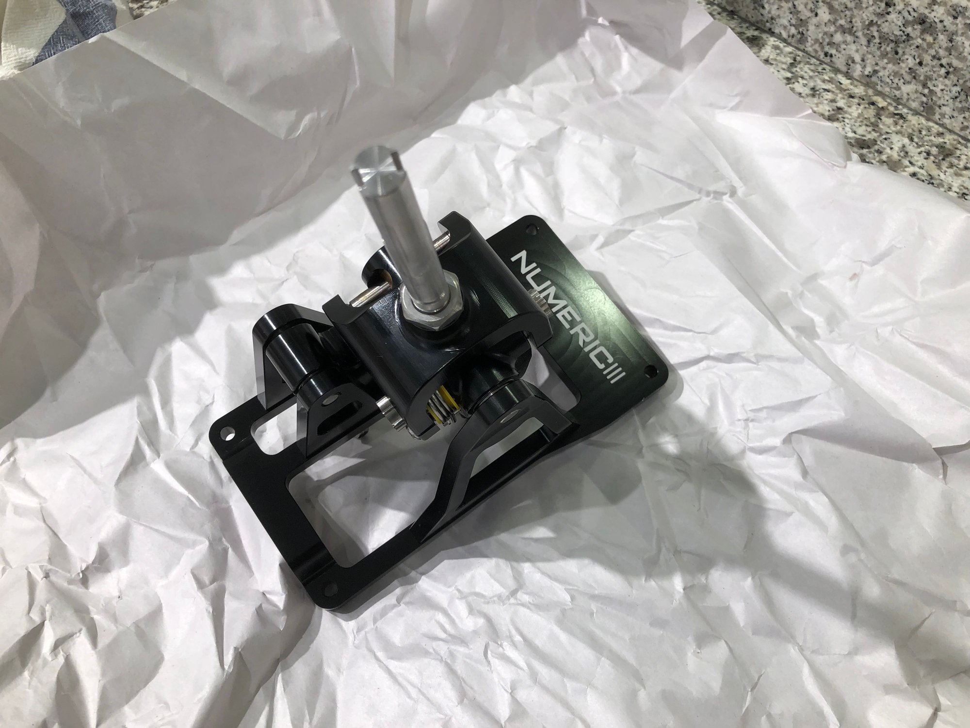

Quick post to share some experience with the 981 (and 991) Numeric shifter.
i replaced the stock 6-speed this morning. Took about an hour following tutorials online. There are really no complicated parts... you need to zip tie the lower console button harness to the shifter somewhere, and the stock unit had holes for this which the Numeric does not, but no worries, just zip tie in non-interfering places and you will be good.
In terms of feel, the Numeric is much tighter than stock, and also taller than stock, though the shifts are shorter. I ordered a Function First shift **** to shorten the height of the shifter a bit, but it is not too tall to look good, just too tall to have a phone mounted on the Rennline mount and still see the screen comfortably, perhaps a centimeter taller than stock.
Here’s a video after the install for visual and audio comparison:
and here’s the control video, stock 981 shifter:
Miscellaneous pictures from install attached. Let me know if you all have any particular questions... I found the tutorials online and the 981 factory maintenance guide to be accurate in all regards here... Numeric doesn’t seem to have instructions for the 981 themselves, but it really isn’t hard.
I recommend this upgrade if you are ok with the cost. I do not have Porsche OEM short shift kit experience, however, so I can’t compare to that. I did this because I came from a Honda, and, by comparison to the exemplary manual shifter in my Honda, the 981 has considerable play and vagueness. The Numeric brings it back to precision for me. Steel cables might be even better, but I’m not ready for dealing with that install at this time, and I have heard tales of noise and harshness being transmitted into the cabin by steel cables, which makes me reticent.

I'm surprised you took out the whole screen too. When I installed mine, it didn't have to go to that point, but glad you got it in. I love mine!

I only took the PCM out because I needed to remove the climate controls to get at the forward bolts. Was easier to just remove it and set aside than try to navigate around. Honestly, this is way less work than it looks. The 981/991 dash, at least center console, comes apart easily and safely... it is a surprisingly good and uncomplicated design. Having worked on W124/W140 Mercedes interiors as well, this is practically a lego!
Regarding cables, that’s good to know that the noise reducer is effective. I may go for cables next... did you do your own install, or did you have it done for you?

Ok, 250mi later on the new shifter, and I have noticed the following:
- First gear is far less reticent to take a shift, at least at an appropriate speed. I used to have trouble shifting into first even at 5-10mph, which is irritating in parking lots and when approaching a severe incline. This hesitation is completely gone with the Numeric shifter, and I have no idea why, but I'll take it.
- First-to-second gear is much easier to perform. This, like the first gear reticence noted above, is a very welcome feeling.
- Reverse is very, very hard to engage. I have seen this complaint elsewhere, but I have not seen anybody trying to fix it. I can live with this... it's far less annoying than the first gear reticence which the Numeric solves, and reverse is certainly not unavailable, just takes a lot more effort than stock.

The shift lever is threaded on. At it's lowest position it is 11.5mm lower than the stock shifter height. 8.5mm taller than the GT4 Sport Shifter. You can also raise the Numeric shifter up to an additional 18 more mm from it's lowest position. There is plenty of room to adjust to your liking.

I need to correct this statement. Numerics shifter lever will be 7.5mm taller than the GT4 and can adjust up to 28mm taller than the GT4 sport shifter. Compared to the stock shifter it can be adjusted to 11.5mm lower and up to 9.5mm taller.
