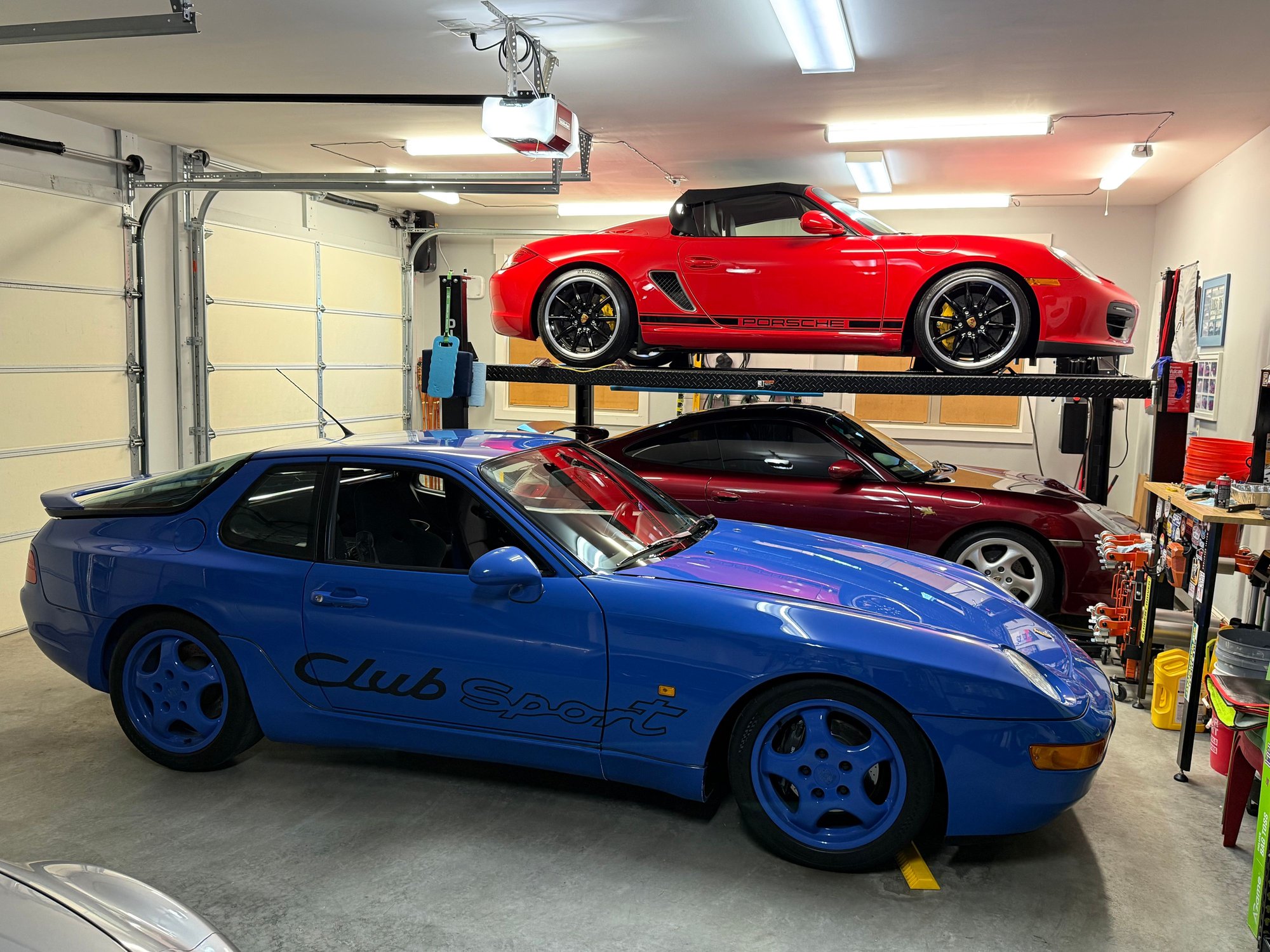

I'm not going to answer your question without pics of the new Clubsport! Congrats!

I’m definitely a proud papa. This car was local to me and I’ve been following her since she was at the 2021 Werks Reunion at Amelia. Japanese market car, Maritime, Recaros, M030, 220, slicktop. 😍
She and a Tahoe Blue 968 were also featured in an issue of Panorama within the past year.

That car is beautiful! What is the voltage when the car is turned on, i.e. the alternator is running and the volt meter is pegged high. I assume it's just the meter reading incorrectly, but you want to be sure.
