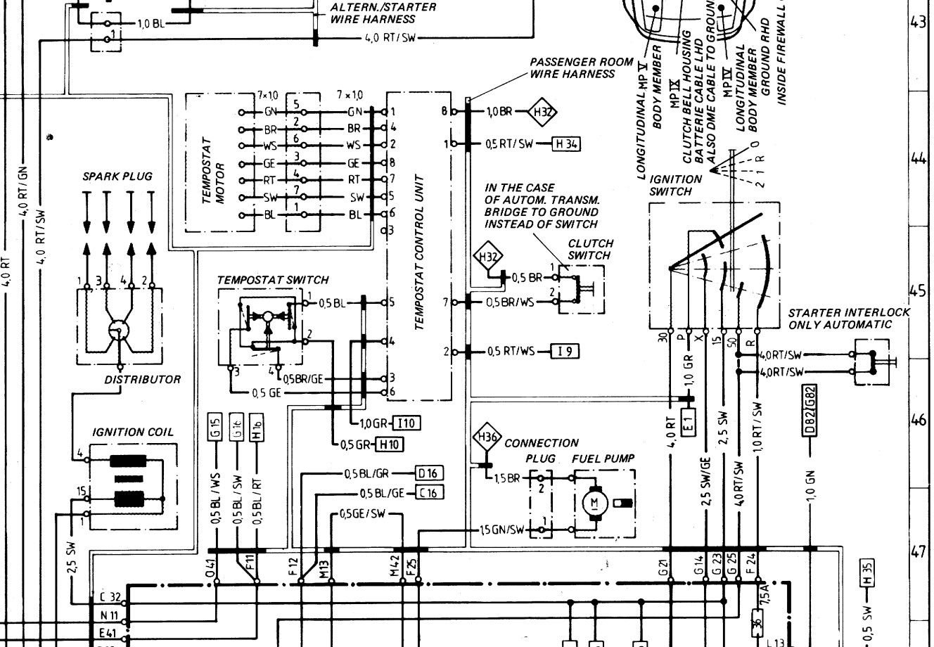

I went through almost the exact same thing on my 968, so before you pull the control unit, I’d take a look at the clutch and brake inputs (assuming your car isn’t a Tiptronic).
Per the factory wiring diagram and WSM, the clutch input is simply a ground-triggered logic signal. The cruise module has an internal pull-up resistor.
So:
  • Switch closed → input sees ground → cruise allowed
  • Switch open → input floats high → cruise disabled
If that input stays “open,” the module thinks the clutch is pressed all the time and won’t engage.
In my case (Tiptronic), there’s no clutch switch. The wiring diagram literally says:
“In case of automatic transmission bridge to ground instead of switch.”
Pin 7 had lost proper ground. Once I restored it, cruise worked immediately.
Since yours disengaged after a brake tap and never came back, I’d strongly suspect one of the interrupt inputs (brake or clutch) is now electrically open — even if the plunger moves fine. Mechanical movement doesn’t guarantee electrical contact.
Before pulling the module:
  • Disconnect the cruise control connector.
  • Check clutch continuity to ground (pedal released).
  • Verify the brake and clutch switches per WSM procedure (attached PDF).
Very often it’s not the computer, it’s just a missing ground signal.
I’ve attached the relevant wiring diagram and WSM pages (PDF-File) for reference and testing.
Hope that helps before you turn yourself into a yoga instructor under the dash 😉
Checking Pin 4 and 7
