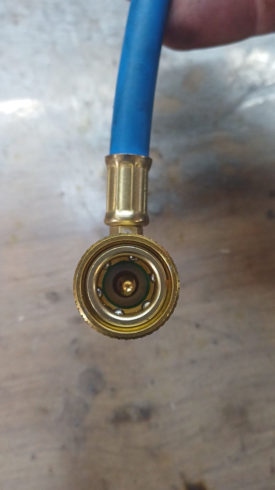

Yes – just wanted to add two photos to the discussion, showing the R134a low-side port connection on my 1993 968: the charging port near the AC compressor and the Snap-on fitting.
And don’t forget to put the cap back on ;-)
R134a Charging port near the AC compressor
R134a Snap-on fitting
