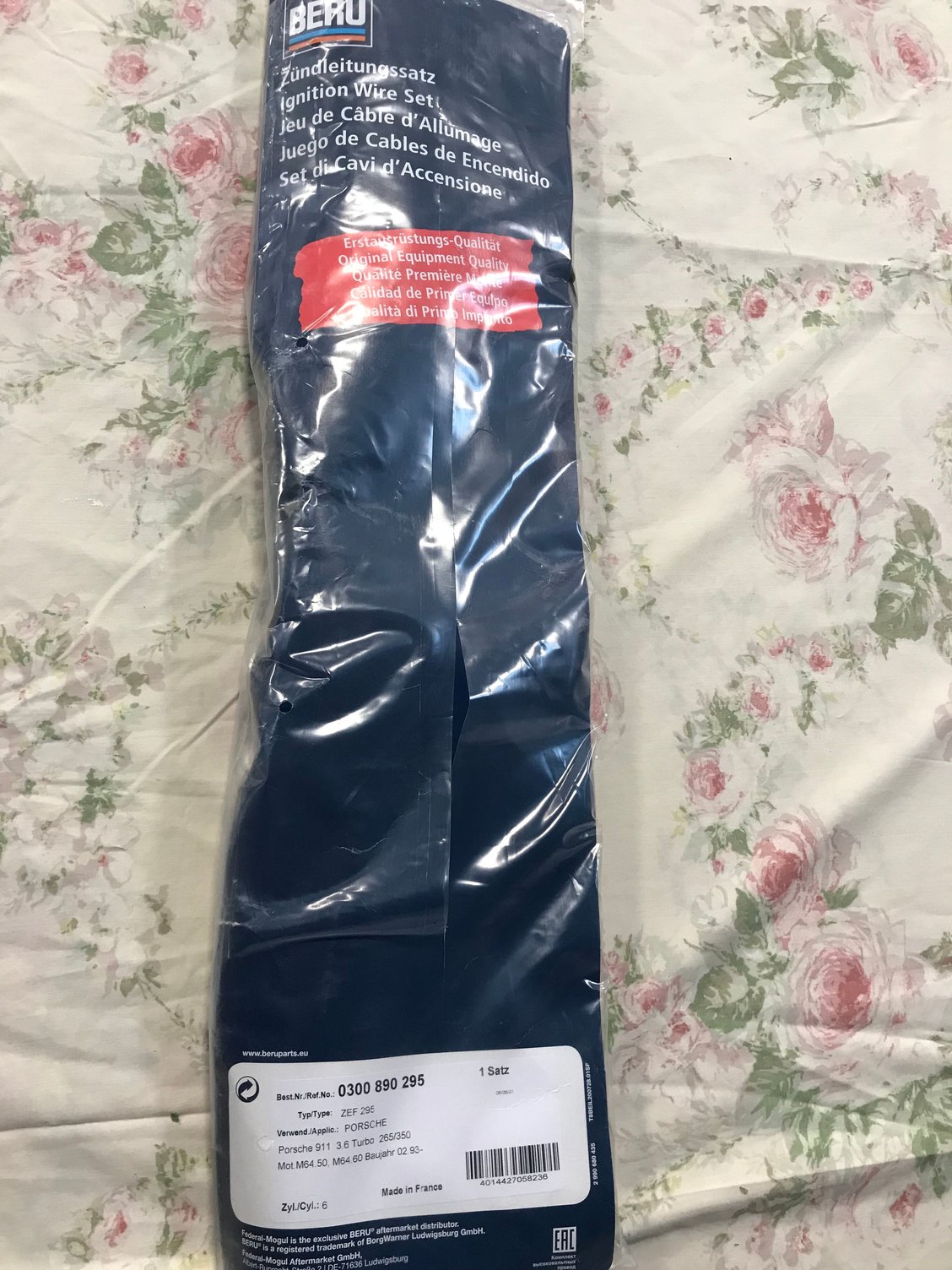

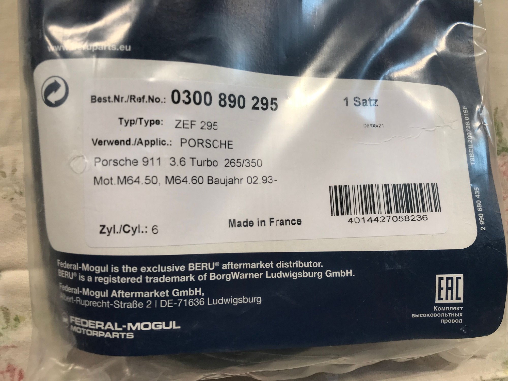

To close the loop on this thread!
The Beru plug wires for the Turbo 3.6 arrived! The package is marked Made in France, and the wires are marked Made in Germany! Wires are nice and fresh OEM looking, and the 6" coil wire is included. Purchase via Pelican Parts; P/N: 10-8533-119-M47

For those following this thread, or find it down the road - THOSE Pelican WIRES ^^^^ WILL NOT WORK ON 1991 3.3l Turbo
The shoulders are not the same (hence the reason I was having such a hard time finding the right ones), PLUS the end caps are SCREW ON for the 3.3 type.
Supposedly the ones for the 930 Turbo 3.3l would work,.... but finding them was the hard part. I never did replace mine as they were still in excellent shape. I only needed to replace the screw-on end caps.
