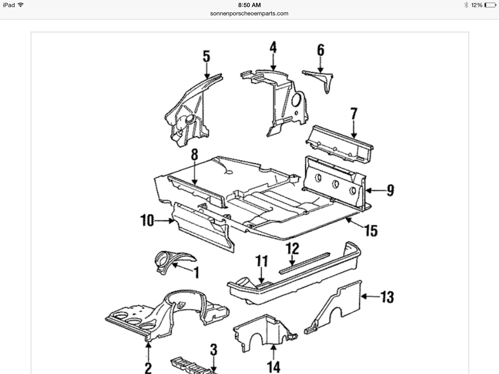

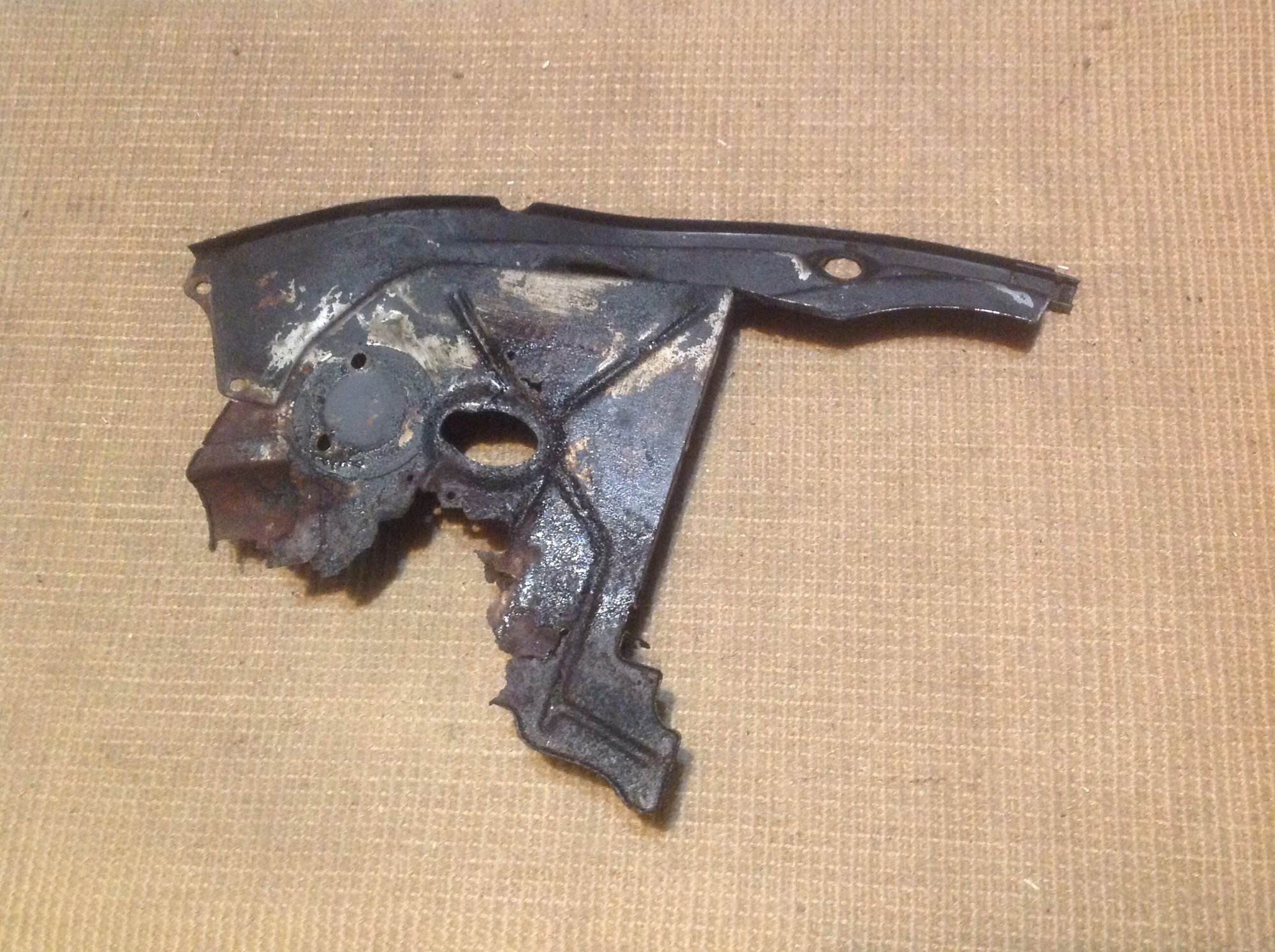

This is the front/drivers side engine tin (#5 in the diagram). Not looking very salvageable as you can see. Interestingly the adjacent passenger side is in perfect shape.
Are my options...
1. Pay the $300 for the Dansk tin....ouch.
2. Check the various dismantlers for a decent used tin
3. Try and tack weld the missing piece using an outline w/aluminum?
Any solutions welcome....

If you have a template, you can weld on the missing part. Looks pretty destroyed though. May just be easier to buy a new piece. Try DC Auto to see if they may have a replacement. My experience with dismantlers is that they tend to be almost as expensive as new (except for DC). Mine had a bit less corrosion than that, so I did weld on a small part.

Goto an autobody shop and buy some sheet metal... $15
Goto harborfreight and get a pop rivet gun, $15
Cut the metal to shape
Drill in 5-10 holes and pop rivet it
Take a hammer, and smash each aluminum poprivet flat
Spray with rubberized undercoating
I did that to make an air deflector to get more air into a radiato for cooling. Looks 100% factory, cme out great. No need to weld anything.

I'll need to trace out the missing remains & line up with the engine curve (using pictures as well). This piece is not visible so just looking for coverage & once painted should look fine.
Love a good homemade solution, nice tip Bo.
