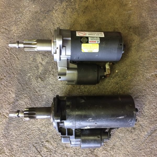

After researching this extensively a few months back, I decided to go with this remanufactured Bosch unit for my '94 C4. It was noticeably smaller and lighter than the OEM unit but I didn't bother to weigh it before installation. It fires up fast and on a single turn of the key every time.

well guys: i did a little bit research (background: i`ve so save 10kg every winter/hibernation period, at the moment i`ve saved 1.8kg with lighter brake-discs and 3.5kg with a Lifepo4 battery, so i need some additional sources for potential weight savings).
Std. starter is ~6kg, 996GT3 starter is round about 3.7kg. So a ~2kg weight saving is expected.
A GT3 starter is available for round about 150,-€ - but not with brand BOSCH. What do you think guys? Is BOSCH necessary or just a nice to have? I do not see any fancy features in a starter, to grab to the upper price-levels...

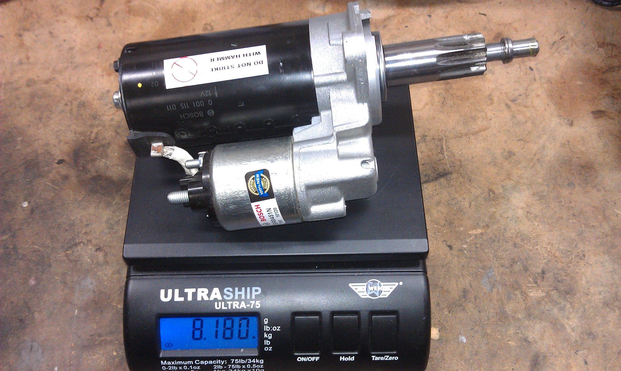

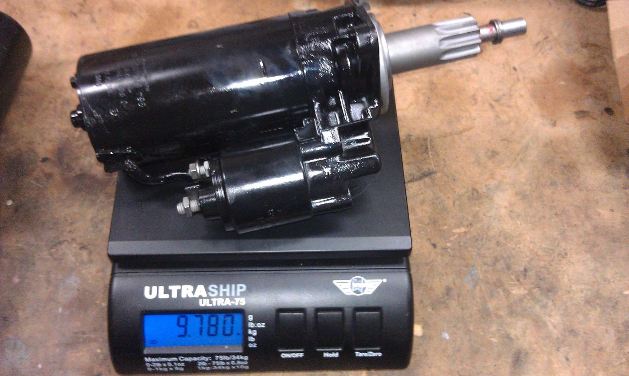

Standard 964.604.104.00 (9.8lbs) vs Bosch SR0451N (8.2lbs)
