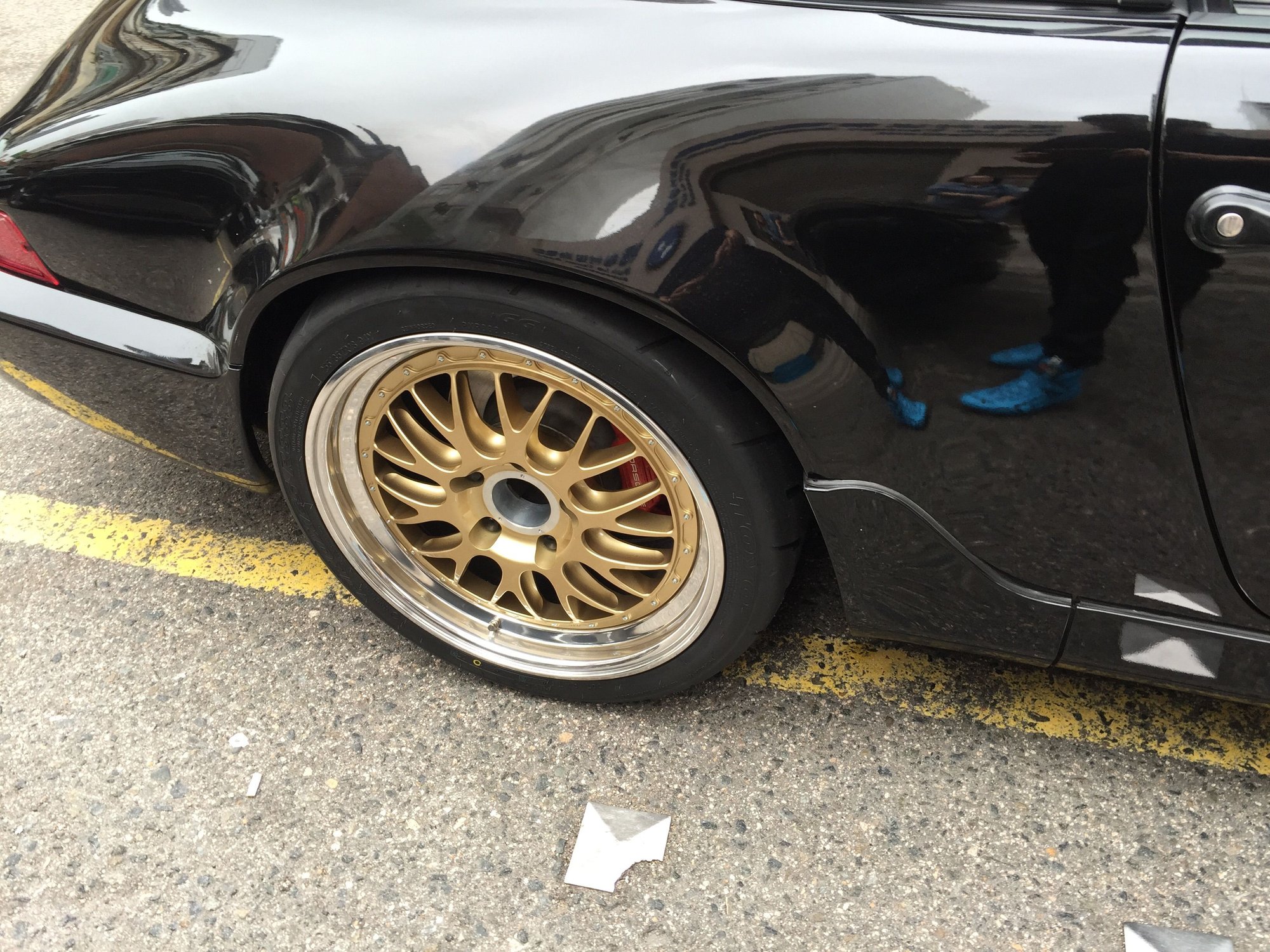

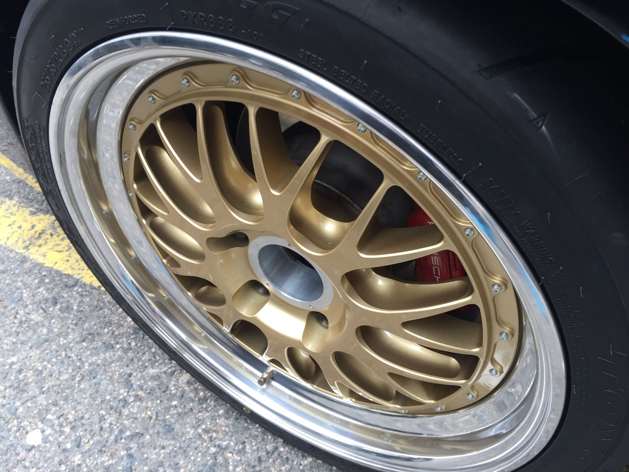

Finally installed the seat without slider. Marginal head space for 6"2 with helmet on. Car is a 964 coupe with sunroof. <br/>
Brand new Toyo R888 for upcoming trackday.
sexy and pratical fitment

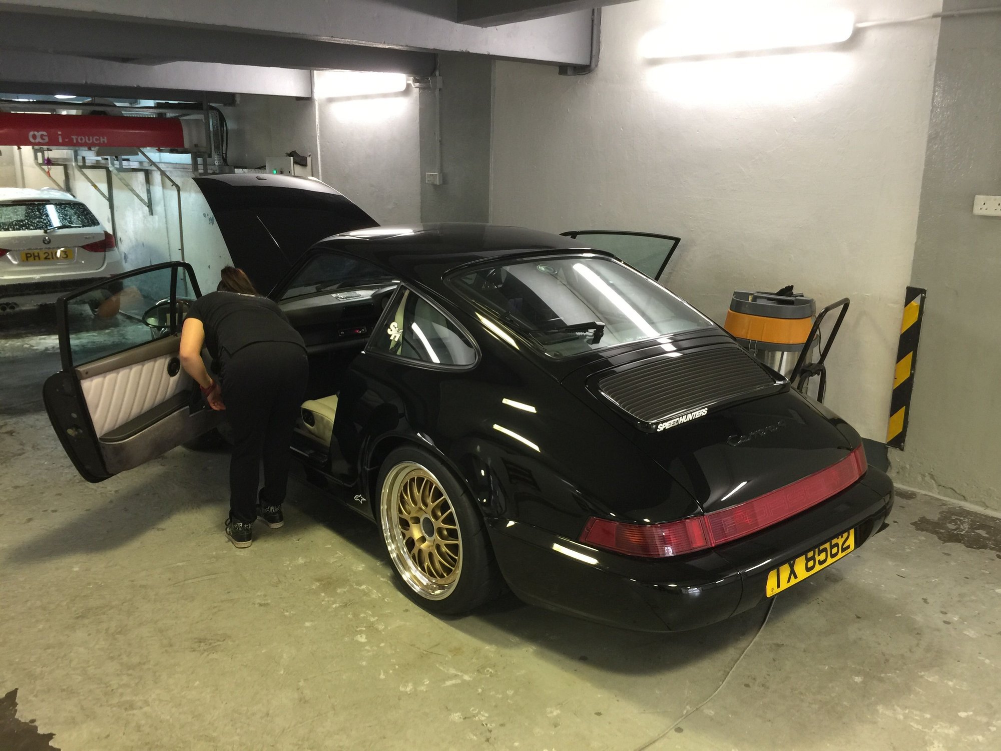

Fixing the year old glass chip.
Have a nice wash before the sunday shake down morning drive.
