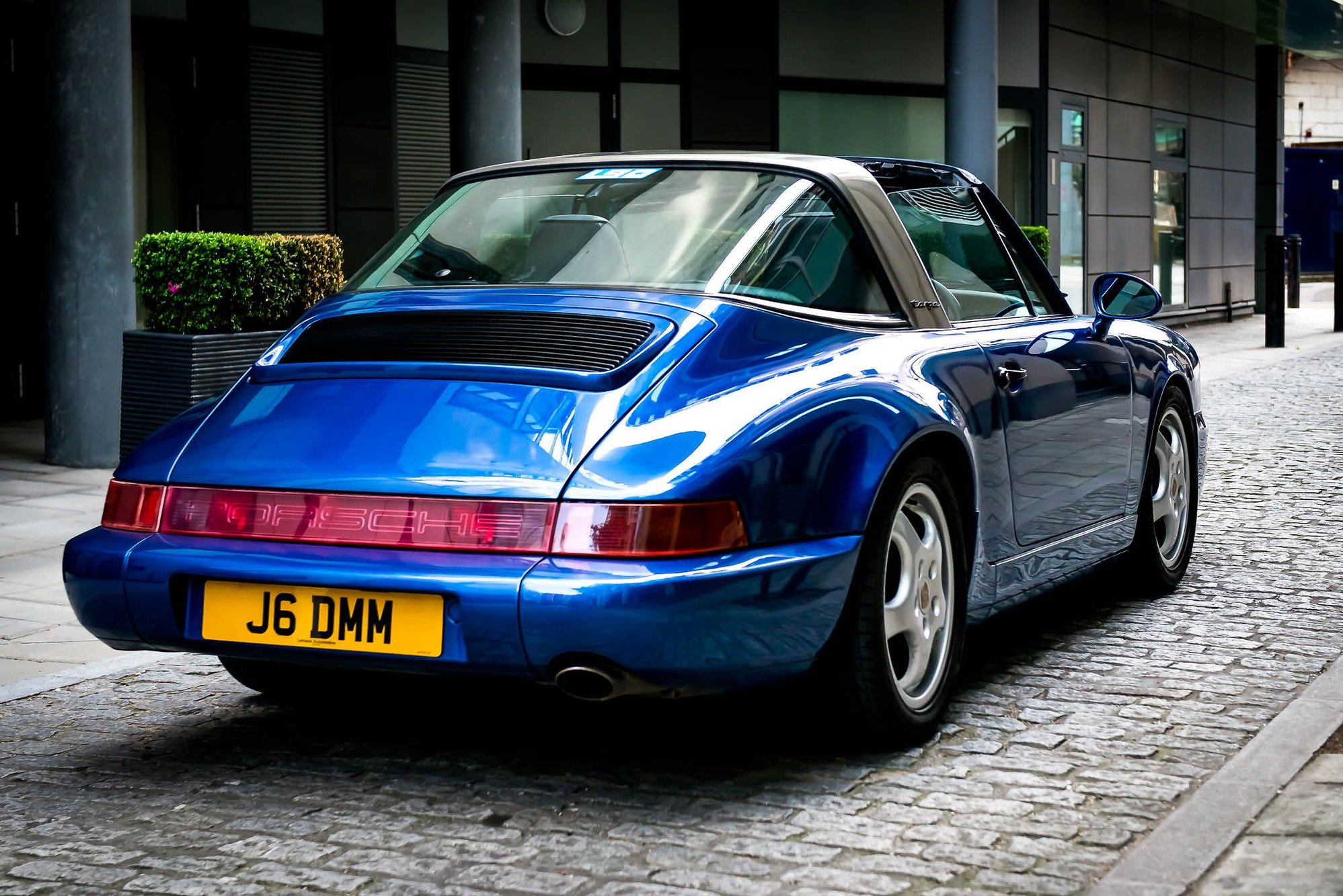

Thought I throw in a couple of pics following the rust war and respray
Old Nov 22, 2015 | 03:01 PM
Ken D's Avatar
Ken D
Joined: Apr 2002
Posts: 6,228
Likes: 165
From: Boston
Stunning! Did you polish the Targa bar? More pics are needed.....
