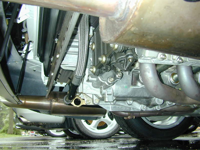

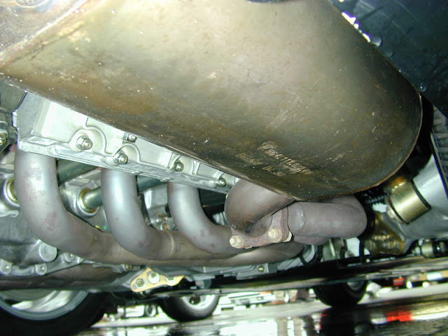

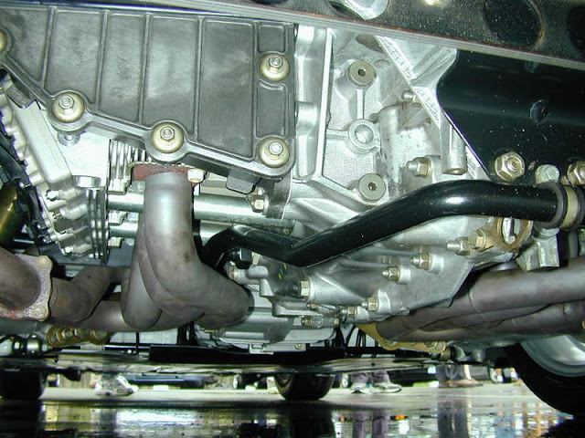

Sure here's what i did on my Carrera, 964 would be similar
or
964 3.8RS was the first to use the 993 style, like this
or
like this
like this
That is a work of art.
