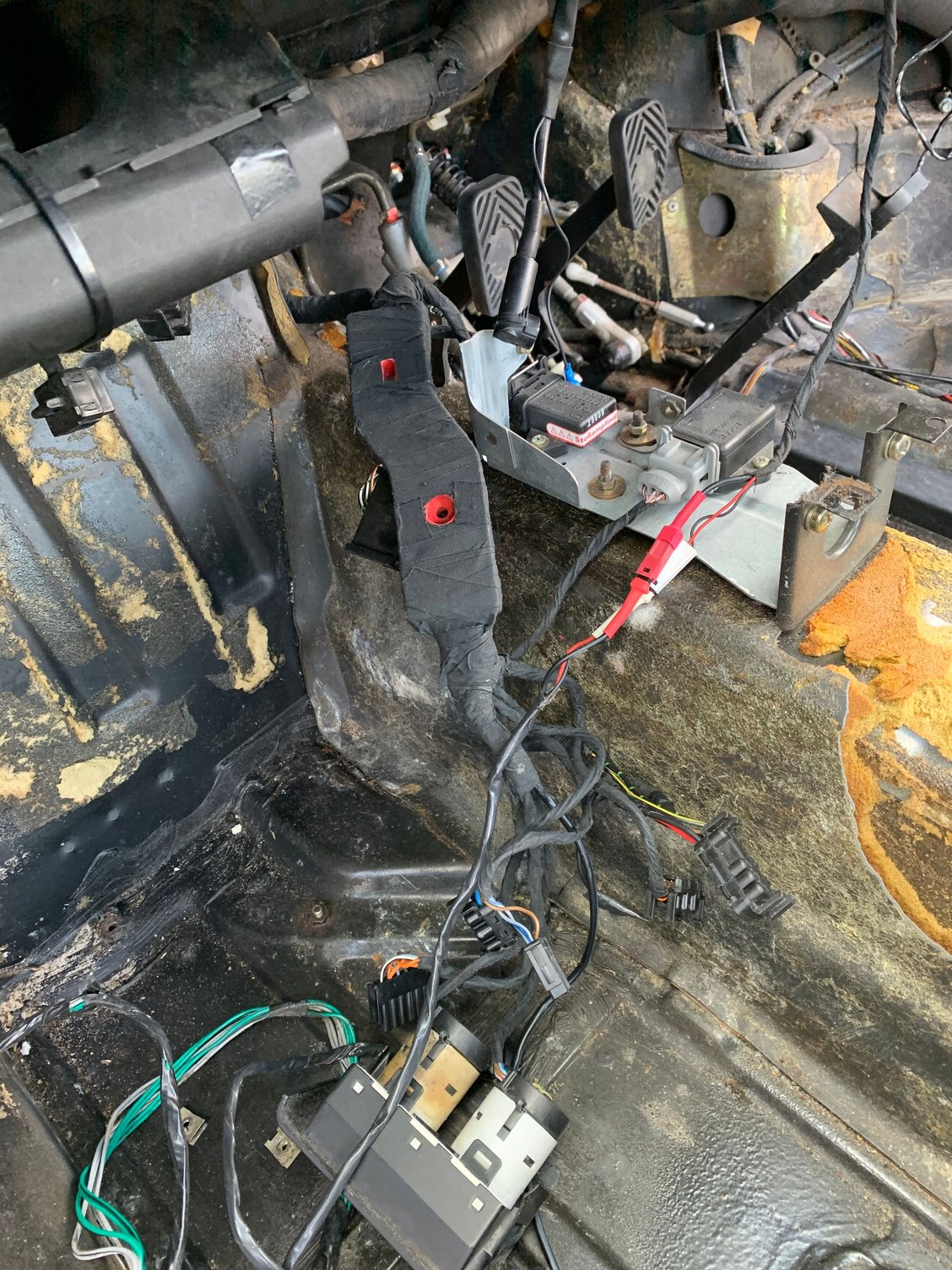

The accelerometers are located on top of the transmission tunnel right by the bulkhead, under the carpeted section.
A C2 has one and a C4 has two.
Just trying to find a pic from when I deleted my centre console, will add shortly...

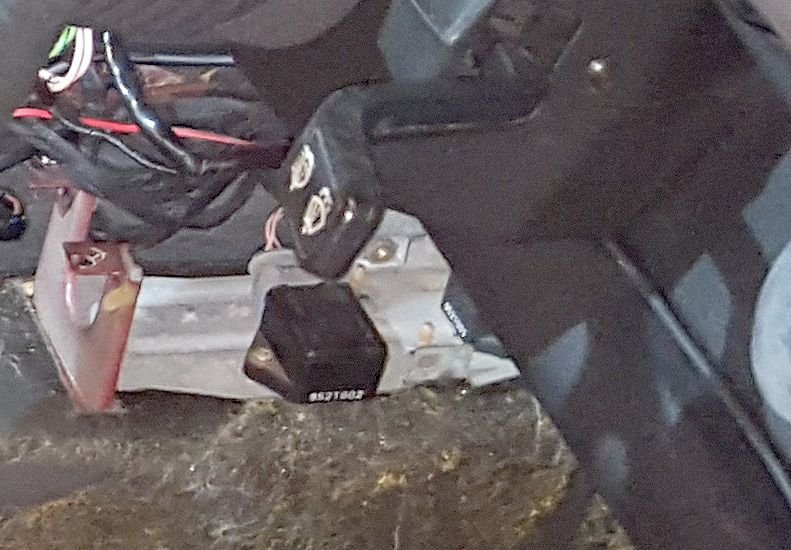

C4 definitely has/needs the two (lateral and horizontal). Mine shown below (one partially shown but can see the part #). Both 'flatter' looking than the small relays and both screwed to the console supporting frame. Think the C2 manual doesn't have/need one but the tip does have one (lateral). Someone will chime in soon I guess.

Just checked the wiring diagrams to confirm and I was slightly wrong
C4 has two.
C2 tiptronic has one.
