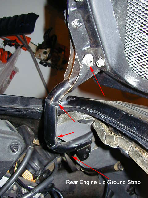

3) In the engine compartment there is what looks like a grounding strap that is unconnected. It can be seen quite clearly in this picture:
Blower and Grounding Strap .
Reattaching this looks like a job I can handle but perhaps there is a good reason it's like that?

I'll answer #1 & #3 for you.
#1: Letting the engine hot idle for long periods of time, that is "many minutes", not just the one or two at traffic lights is bad because the oil pressure drops at an idle and the rockers hammer against the cam, causing high wear.
#3: That strap is to provide a good ground for your blower motor. The electrical path back to the chassis ground through the screws and brackets is not as reliable as that strap.
That is the engine lid hinge ground strap.
The PO may have removed the rear engine lid at one time or they had the problem with the ignition wires running from the coils to the distributors chafing on the ground strap. Porsche rerouted the strap after April 15, 1991 on the production line and that stopped some of the christmas tree light problems that owners were having. When you reconnect the strap route it on the inside of the hinge exactly like the following picture.

Originally Posted by JasonAndreas
Its a good idea to replace the felt strips as soon as possible or you risk the window channel rusting. To look down inside the door just pop the outer rubber seal.
When I came to do this job, the layout in my 964 looked different to your photo. In fact there was no bolt hole in the flange where your strap is attached. You can see below how I ended up attaching it: the bolt it is fixed to at the inside top was even slightly loose, so it looks like someone simply forgot to reinstall the strap after doing some work.
Do you think that looks OK?
I have a 3.8RS fixed rear spoiler.
You want the strap routed on the opposite side, this might explain it better?
Ignition Cables - Chafe on Ground Strap, and MIL ON
March 10, 1992
Model
911 C2/C4
Part Identifier
2855
Group
2
Number
9201
Subject: Ignition Cables
ATTENTION: Service Manager/Service Technician
Models Affected: 911 Carrera 2/4 Model years '89 (K), '90 (L) and'91 (M)
Concern: Ignition cables from the ignition coils to the ignition distributors may chafe on left engine lid hinge ground strap.
(Former Routing)
Figure 1
(New Routing)
Figure 2
Vehicle Information: Routing of the ground strap on the left engine lid hinge was changed in production as of April 15, 1991 (Figures 1 and 2).
From VIN:
96 - MS 41 1509 - Coupe
96 - MS 44 0726 - Targa
96 - MS 46 2089 - Cabriolet
General Information: The ground strap on the left engine lid hinge could contact the ignition wires on vehicles prior to the above VIN'S. This could lead to chafing on the ignition wires and/or warning symbols lighting up (usually ABS and central warning).
Repair Information: The routing of the ground strap should be checked and, if necessary, changed when the vehicle is in the workshop for normal service or other repairs.
Work Procedure: Loosen ground strap on body.
Route ground strap towards outside of engine lid hinge lower part (Figure 3).
Tighten ground strap on body. Strap mounting terminal should point forward with strap looped to the rear.
Minimum clearance between ignition wires and ground strap should be 15 mm with engine lid closed.
Replace chafed ignition wires where necessary.
Note: The function of the ignition circuits 1 and 2 must be checked every time the ignition wires are pulled off during repair and maintenance work. Refer to 911 Carrera 2/4 Workshop Manual, Volume 1, page D24/28-27.
