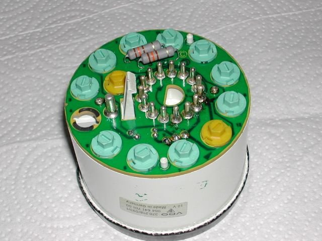

1. Remove clock module from dash, by gently prying with the taped screwdriver until you can grip it with your fingers and pull it straight out, then disengage the two electrical connectors (small one first). The large connector takes patience to remove, work it loose without side-loading it if you can. For more detail see Tom Sharpes’ nicely written How-To on the PelicanParts website (<a href="http://www.pelicanparts.com/techarticles/964_gauge/964_white_gauge_faces.htm" target="_blank">link here</a>.
Here is what the back side of the clock module looks like.

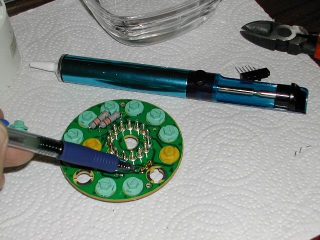

2. Remove the two small screws securing the PCB to the back of the clock module. Don’t try to pull the PCB off the clock module just yet.
3. Locate the three evenly spaced solder joints directly adjacent the inside edge of one of the light bulbs along the perimeter of the PCB. These joints connect three posts to the PCB, the posts pass through a partition of the clock module housing and are soldered to a small circuit board in the quartz clock on the other side of the partition. The picture below shows where they are on the PCB, I took the picture after step 6 below. Note the blue solder sucker in the background.
4. Remove the light bulb so you can access the three solder joints with the soldering iron without burning anything.
5. Remove the solder from the three joints using the soldering iron and the solder sucker, so that the posts are free of the PCB and the PCB can be lifted away without pulling on the posts. Note, the solder joints connecting the posts to the PCB are stronger than the solder joints connecting the posts to the quartz clock. If you tear the posts loose from the clock you will have to remove the bezel on the front of the clock module (Tom Sharpes’ writeup explains how) to access the quartz clock and make the repair.
6. Lift the PCB away.

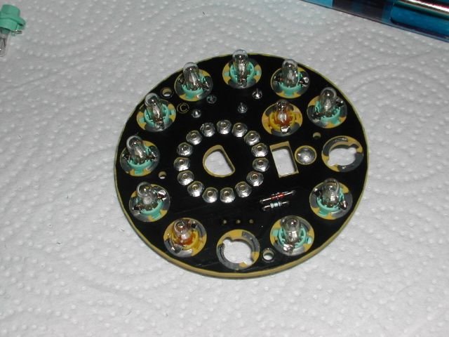

Here is what the inner face of the PCB looks like:
7. Check the solder joints that connect the connector prongs to the PCB with the ohmmeter. (On mine, 10 of the 15 prongs arranged in a ring for the large connector had bad connections, including connections to traces for the airbag, seatbelt, battery and spoiler lights). For example, place one test lead in contact with the tip of a prong, and then place the other test lead in contact with a bare portion of a trace that connects to the prong, for example where a light bulb connects to the trace. Most of the prongs connect to traces on the inner face of the PCB, some to traces on the outer face, and some connect to traces on both sides. You should see at most a fraction of an ohm of resistance. You can also remove and check the light bulbs too. Light positions are numbered this way:

8. Resolder any faulty connections. I resoldered all of solder joints for the main connector prongs, and I soldered on each side of the PCB where there was a trace connecting to the prong. I got the joints nice and hot, and applied lots of solder (I used the solder sucker to remove excess). I used lots of solder so there would be plenty of flux (rosin) to ensure a good, clean joint. I also put a coat of solder on the inside edges of the hollow prong openings on the inside face of the PCB, because the prongs appear to be riveted to the PCB and I wanted to ensure that the solder made contact with all components of each prong.
Be careful not to get the two large resistors too hot for too long, when you solder the connector prong solder joints connected to them. Cool them afterwards by blowing on them and/or applying a damp rag or paper towel (which you will already have on hand to clean the soldering iron tip with). The small resistor and the diode were far enough away from the connector prongs that they did not seem to heat up significantly.
9. Retest the connections.
