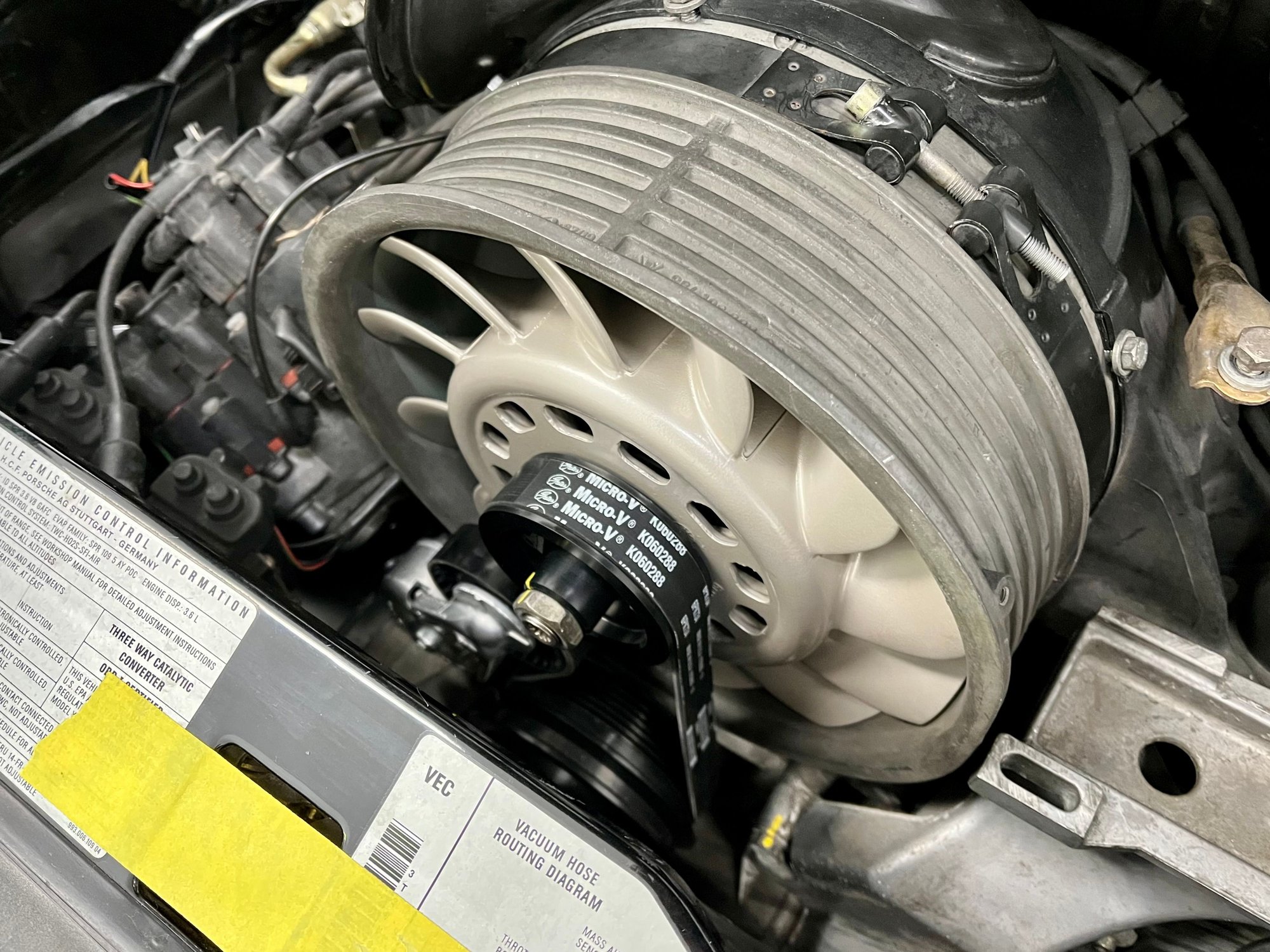

It is a WOSP 240A alternator purchased from Classic Retrofit.
And it was converted to serpentine belt with the ratio is 1.65.

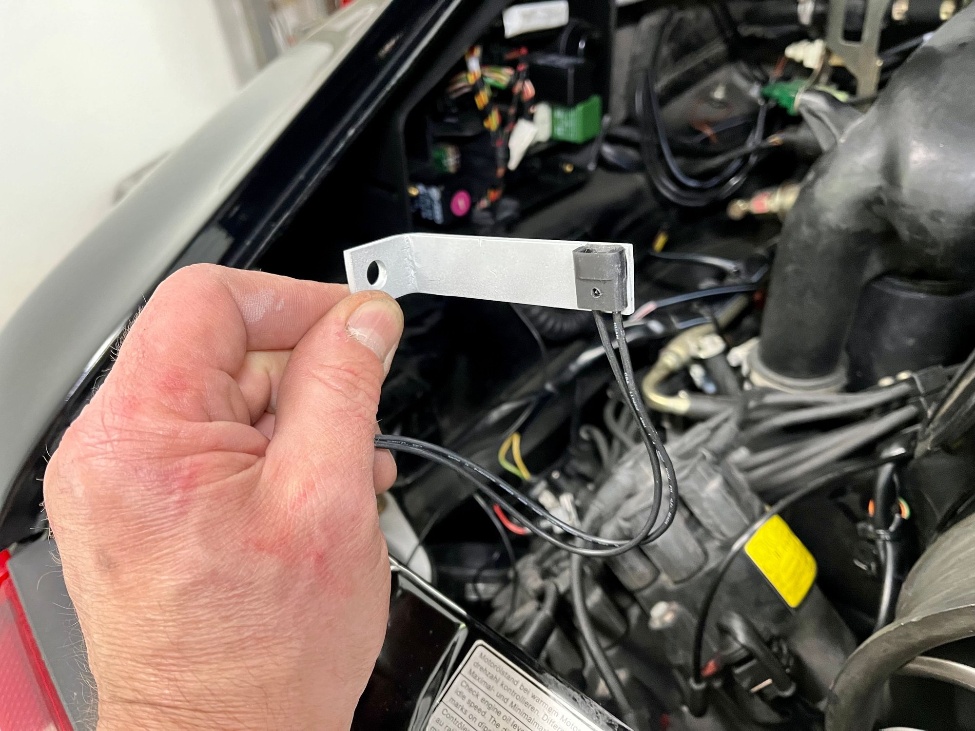

I noticed Clewett Engineering had some fix about the low voltage charging with serpentine belt.
By adding one more bulb to the circuit.
But I am not sure how to interpret the diagram correctly.
It is saying I added one side of the a bulb to the alternator blue wire and other side of bulb to the ground in the engine bay?
Not sure about why it is stating switched power.
Isn't the blue wire from alternator a 12v positive already?

Ah, you're not running a stock alternator or charging system.
The bulb serves as an "exciter" telling the alternator that current is needed.
The diagram is showing you how to add additional resistance to that circuit.
One end connects to the blue wire, then it goes to a 4w incandescent bulb, then the other end connects to a switched power source (only on when ignition is on) in the engine bay.

100% correct. I've installed 8 or 9 Clewett 993 serpentine belt setups and always add the additional incandescent bulb - just in case. I make a simple aluminum bracket that attaches to an existing stud in the fuse box on the driver's side of the engine compartment.
The bulb only illuminates for a few seconds at startup.

The journey continues.
Just discover something interesting earlier today.
I noticed voltage at the battery and from engine fuse box is about 0.5V difference, the once the one at the engine bay is higher than at the battery.
I wired an 3.4w bulb today as well like the diagram went out for a drive noticed the voltage is around 13.2 for the who drive, so I pulled over and shut down and try to restart, when i put the key into ACC the battery light won't light up.
So I pulled the wire bulb harness an revert back to normal, and still the same thing.
Pull the clock and swap another bulb for battery light in the clock, and battery is back to normal.
So I went out for a drive and the voltage is up to 14.0V at the battery and 14.5 V from the rear fuse box.
But at idle the battery voltage drop to 13.5V and voltage at rear fuse box it about 13.1V and intermittent battery light warning was triggered from time to time.
I also notice the voltage at the rear fuse box is fluctuating quite a lot and frequent, please refer to the video.
Could it be a bad VR?
I have a WOSP 240A alternator installed for the Electrical AC, and all the test was done with AC off.
Thanks again.

Two oppositions:
1. increase the idle RPM (idle valve adjustment)
2. change the crank to alternator pulley ratio
Also, soldering the alternator cable connection at the alternator can reduce a potential voltage drop. It's typically just crimped.
