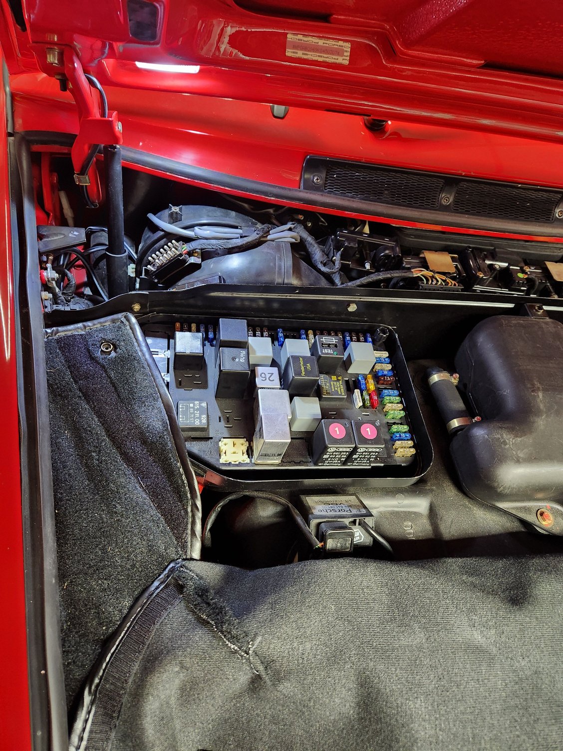

Not looking good so far - more testing to do

Any problems with power supplies could be due to a poorly assembled T34 connector. This is placed onto/near the right main cabin blower housing, heres a pic of a 993:
Cheers,
Tore

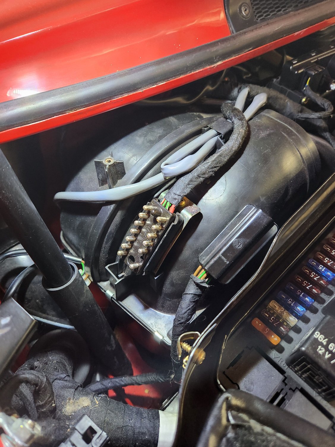

I thought I was doing something wrong using a pretty high-level tester since I was getting 0 volts across all terminals which was weird.
@ToreB you are the "MAN" with your last suggestion - look what I found below:
Thank you all for helping out and @ToreB is the guy to go to regarding all ccu issues for sure!!
