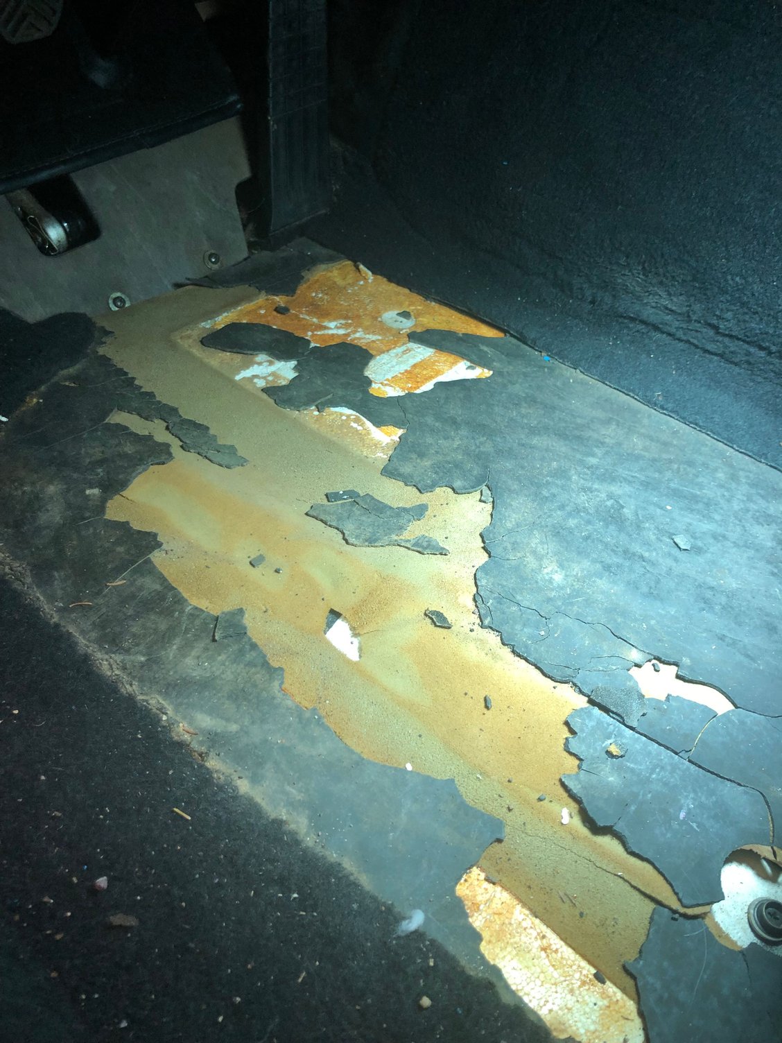

I ordered a full set of OEM carpets and then lifted the old ones. Yikes! What do I do now? Is this the way the driver's side floor was built by the factory?
The steel floor pan seems to be covered with a mixture of different materials ranging from fairly thick hard white foam, and then various thickness (1/8" to 1" thick) foam rubber all of which was covered with a glued on thin piece of rubber-like sheet. Right now the easiest way forward (if I can remove all of the thin rubber covering) is just to apply new rubber. What do you think? Any advice greatly appreciated.
Tom

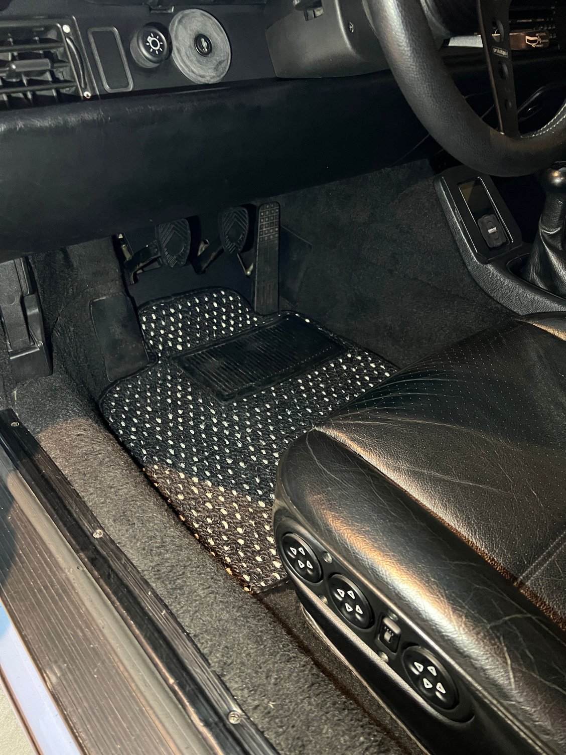

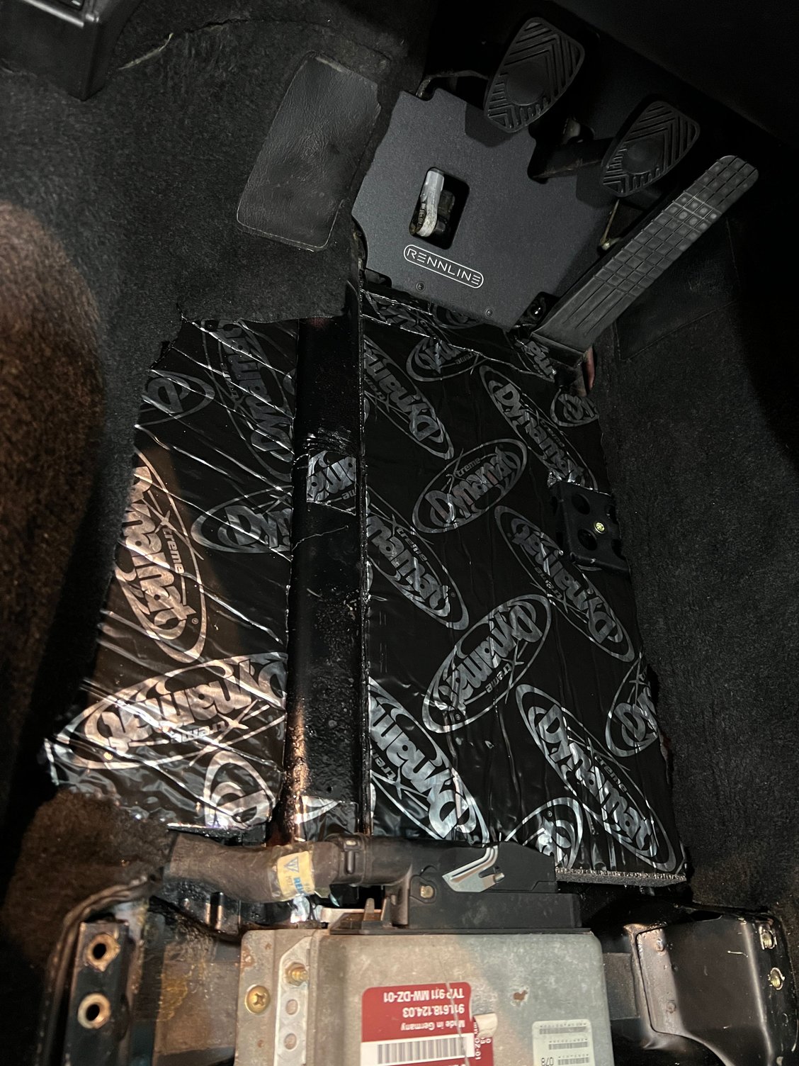

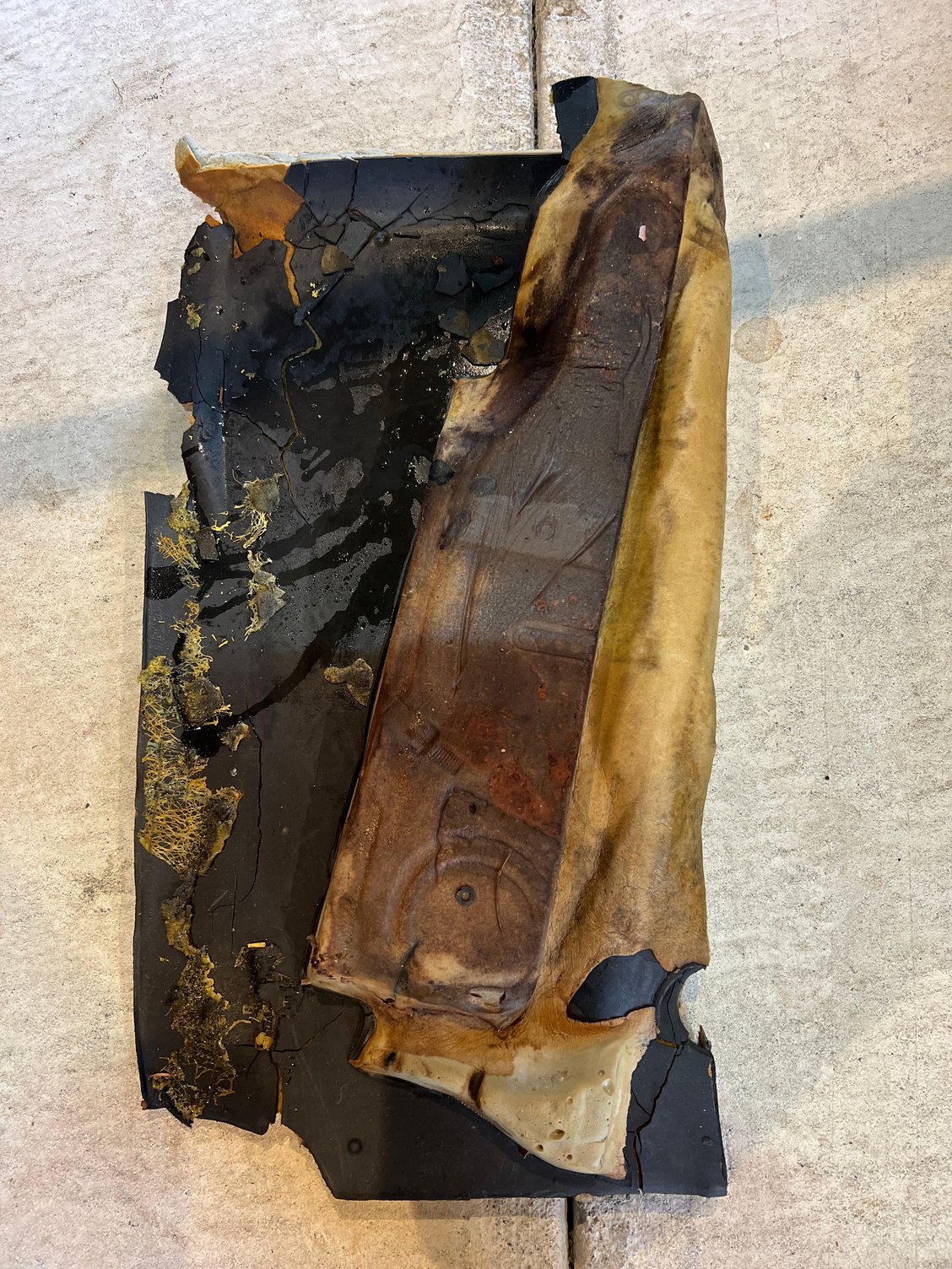

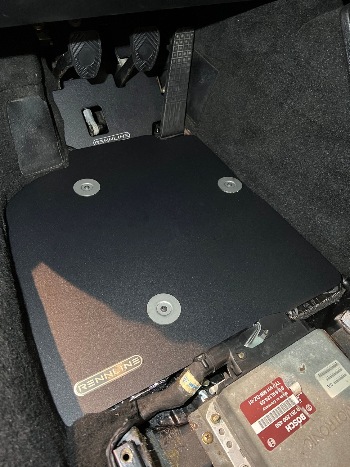

That “floor” is rubber backed foam insulation on the unibody floor. In my situation it was saturated with water and disintegrating. I made new closed cell foam insulation backed with dynamat and installed Rennline floorboards on top to level the floor again.

Consider yourself lucky. That floorboard looks pretty good. Just a bit of wear in the top, and the usual spot where the heel lies by the accelerator. I would to take a look underneath and make sure you don’t encounter what I woke up to.

The Rennline mats is a nice way to go. But it’s easy to make your own with some plywood and a rattle can of flat black paint. There’s a photo in the RS carpet thread. Rennline was kind enough to sell me the sunken washers separately.

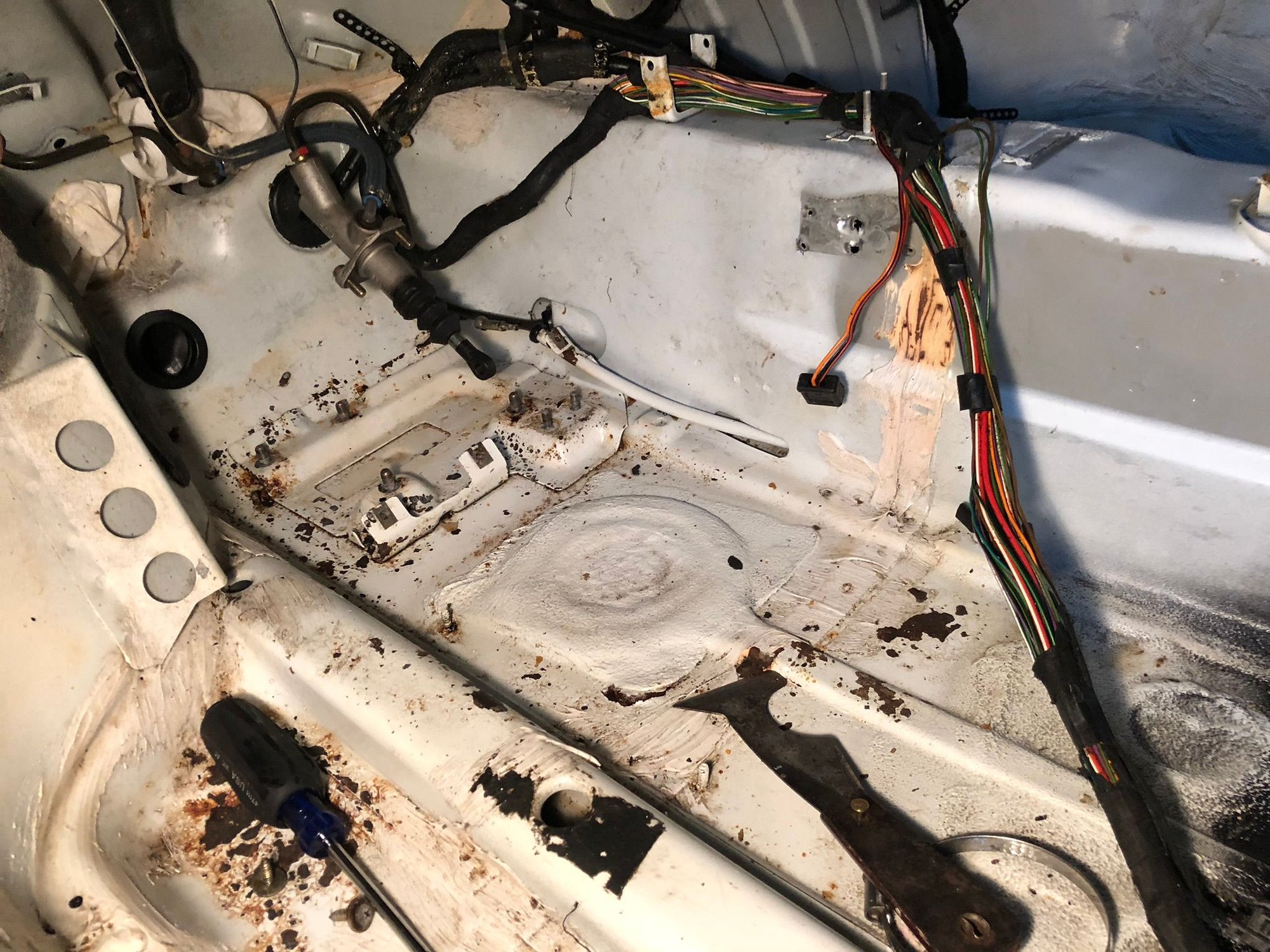

Found this lurking under my floorboard.

Actually I have Cocoa Mats on top of the Rennline floors. You could easily run the factory mats on top as well, just need something to grip the carpet on the aluminum floors.
And yes the foam I used is exactly like that and I put dynamat on top to deaden noise/vibration as well.

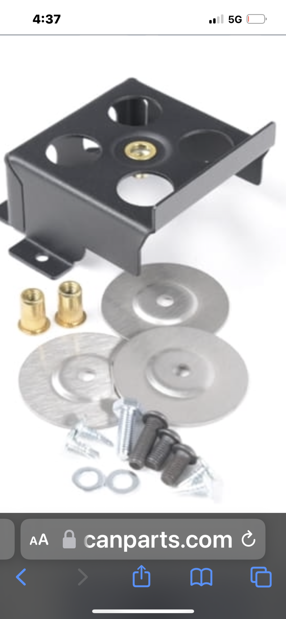

The 2 in 1 MLV with closed cell foam that Ubipa posted is precisely what you want. Just lay it down, on top of Dynamat Lite if you like. The mats are secured by inserting a couple of Rivnuts down the center channel. There’s no channel on the right side, so the recessed washer on that side has a rubber peg underneath for support. The Rennline mats include all the hardware, but it appears the rubber peg has been replaced by a metal bracket.

My passenger side floor came with the rubber peg, but the driver side had the extra mount.
