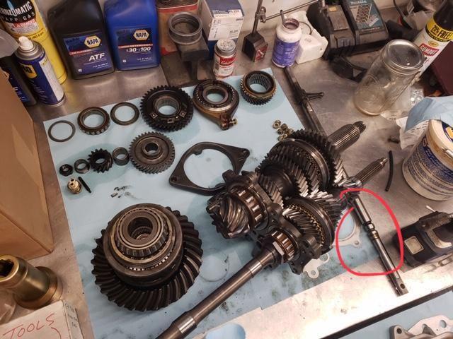

Looks like that chunk lodged in the shift shaft bore prevented the shift rod from moving. That is the only thing that appears to be amiss. Planning to re-assemble with one adjustment: potential for welding the planetary gear axial shafts to prevent failure down the road.
Good news. Where did the chunk come from?
BTW my gearbox suffered a stress break in the selector shaft where it’s circled in the pic. It may pay to get that looked closely at, as cheap insurance.
I’ll have that shaft checked.
The mechanic is puzzled about where the piece came from since nothing he’s seen is broken. Right now we’re wondering if some part was left loose from a previous repair, but that’s just conjecture.
