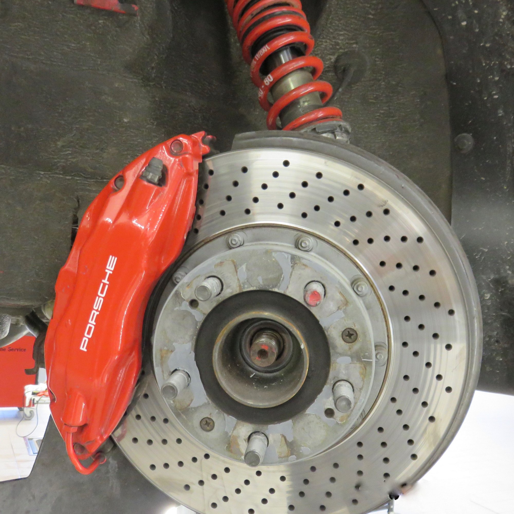

@Bruni Wow. Incredible. Did you upgrade brakes?
Yes with Big Reds. You have to improve your stoppimng somehow.

@Bruni I am planning 928 GTS 'big blacks' (aesthetic reasons) for front, but not planning anything for rears. You have any PDAS/ABS issues with your brake setup? Any PDAS/ABS issues with your wide body and staggered wheels? Looks awesome! Congrats! Regarding 2nd oil cooler location, concern was compromising the AC by stacking oil cooler back-to-back (eg. heat soak). But obvs, not a concern if you are AC delete.
You have to improve the rear breaks. These are not in balance with front. You are going to do this later anyway! No problems ABS or PDAS.

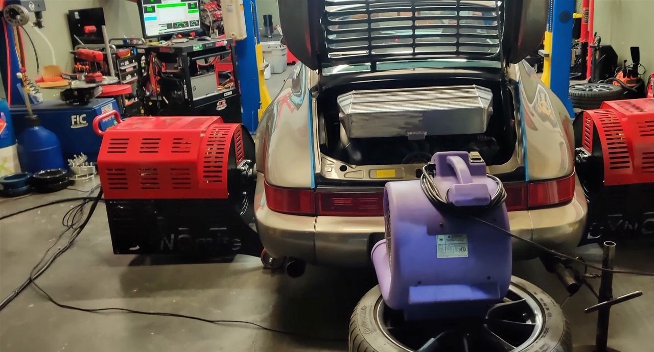

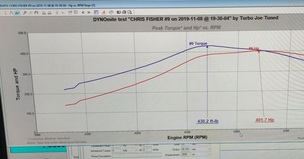

Just completed the first dyno test at a very safe .8 bar. 430 torque/401 horsepower at the wheels. Going to put a couple thousand miles on the car at low boost before going up to 1.2 bar. First 100 miles car has been great. 3rd gear is scary fast once it starts to pull. Sound is exhilarating... coming off revs above 4500 with the air intake and pop off valve tucked behind the rear driver's side is addicting.

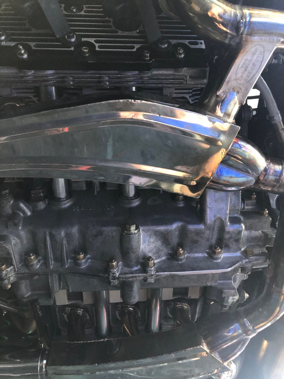

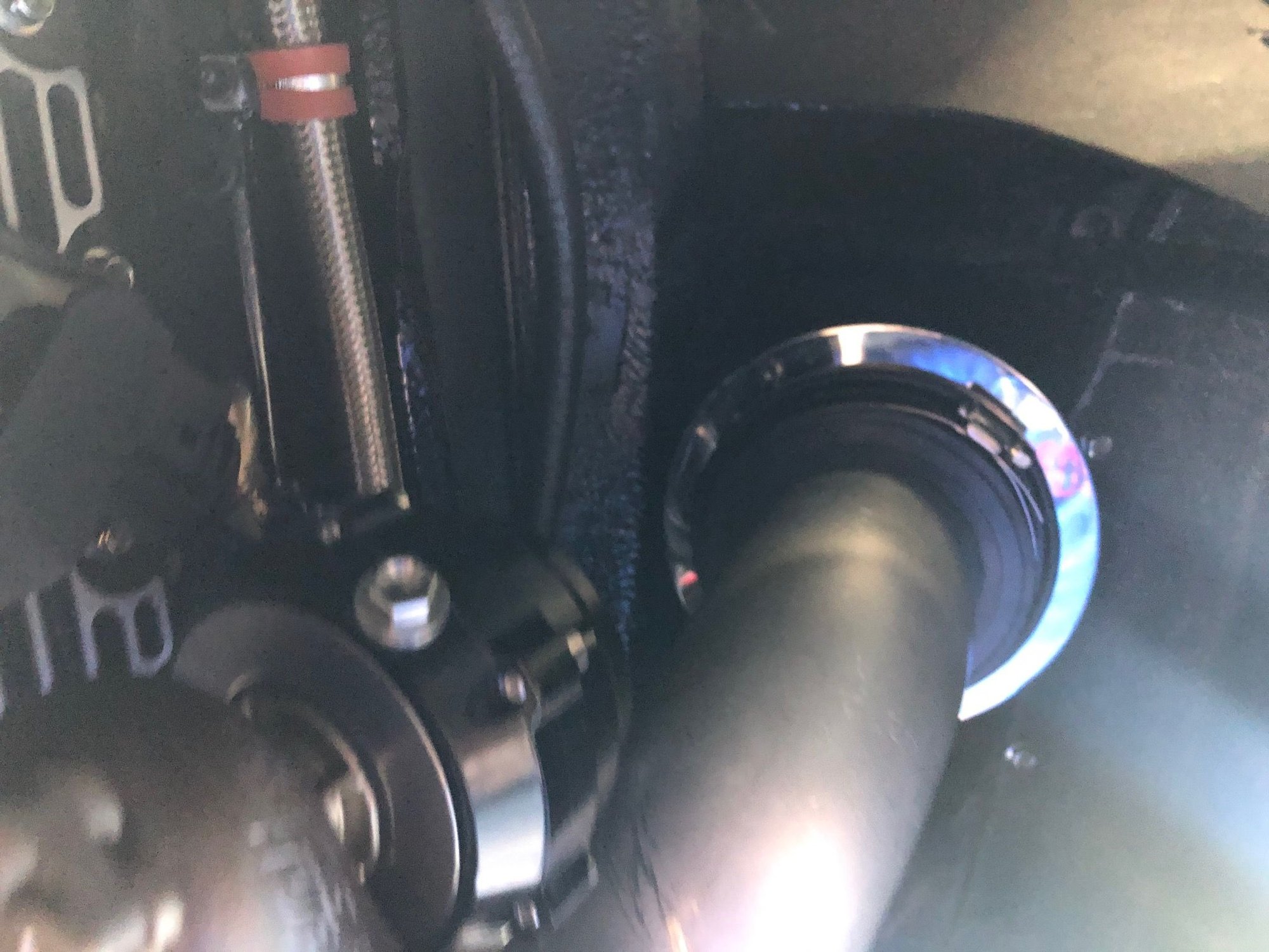

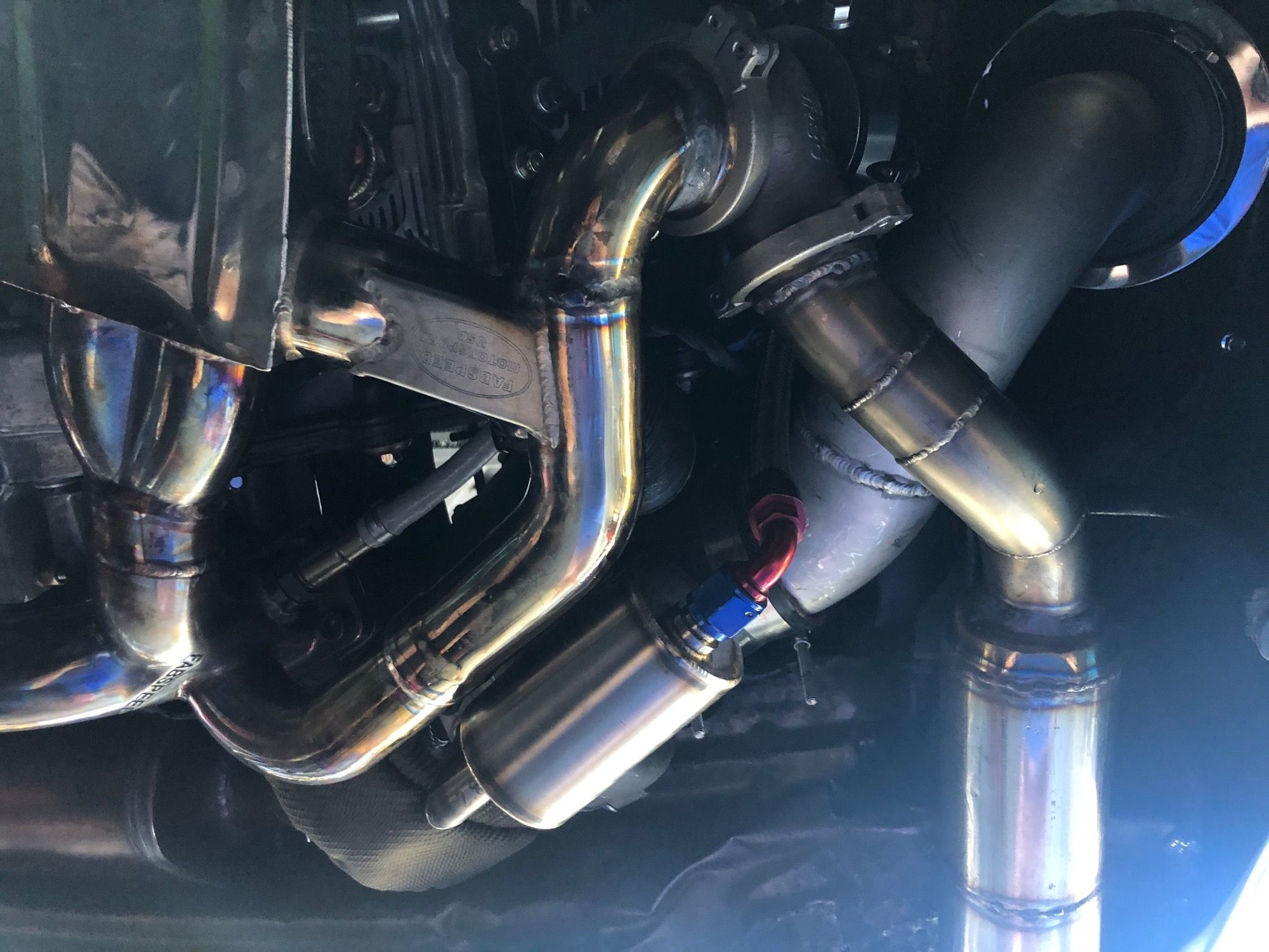

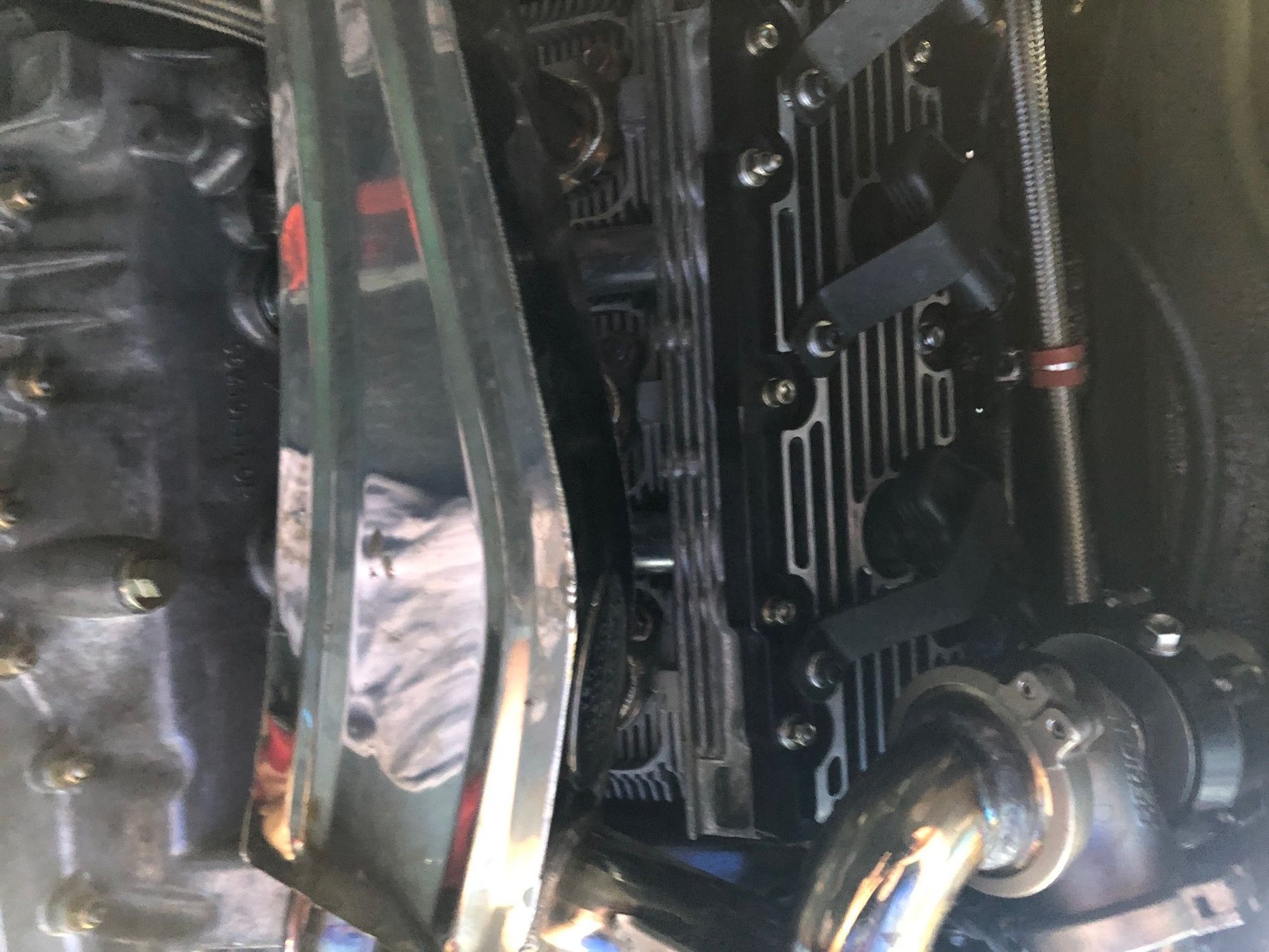

@lorezoh Engine is Fred at Valley European. Dyno test was stopped early because the engine destroyed the original motor mounts. Have since replaced with RS mounts, but car will not be going back to dyno until break-in period complete. Here's some photos of the underbelly before I drove away:
